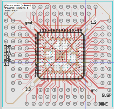

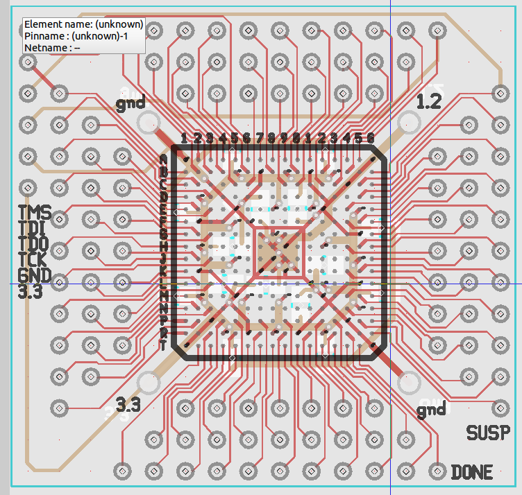

I hear you. Consider this a discussion then, no arguing 8) I'm looking at a 16x16 1mm matrix of a 256-pin Spartan 6 BGA, most of the power pins are in the center of this device. I need to get my screen capture utility back on my computer! I made the initial footprint for the XC6SLX25-3FTG256C

Here is my old BGA256 test board (do not use this layout directly, there are errors). I didn't bother breaking out more than 2 rows, as I was constrained by board size already. Note the brown power distribution ring on the back. If you needed to break out 2 more rows, you could easily make the ring smaller and closer to the center, and have spokes lead to the power pins from this ring. It all depends on where the pins are, but you probably get the idea.

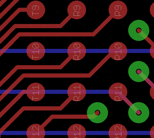

enso wrote:
Consider the best-case breakout pattern. The first row goes straight out. The second row sneaks between the first row pads. The third row has nowhere to go but down and out.
Unless your PCB manufacturer allows 0.1 mm trace/clearances, so your third row can sneak past the second. :) BTW: this is a 1 mm pitch BGA.
