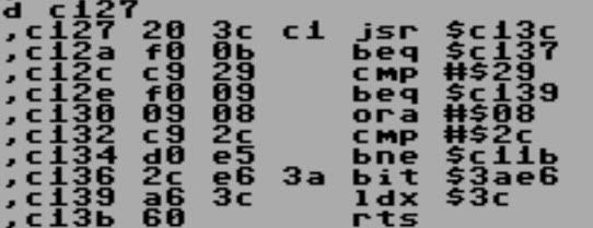

PostPosted: Fri Dec 16, 2011 1:26 am
I've come across 6 instances like the one below. These are the last inconsistencies I have left before fully translating HESMON from 8bit 6502 to 16bit 65Org16. This example below is a pic taken from VICE running the original HESMON image and disassembling itself. This is just abit of some tricky coding here. Check out the BEQ's. Almost like the BIT $3AE6 ($2C, $E6, $3A)is non function
eC127:
             JSR eC13C
             BEQ eC137
             CMP #$29
             BEQ eC139
             ORA #$08
             CMP #$2C
             BNE eC11B
             BIT $3AE6
eC139:
             LDX $3C
             RTS
When the CPU sees a BEQ $C137, it looks like this:
 Post subject:
PostPosted: Fri Dec 16, 2011 6:12 am
Posts: 390
Location: Minnesota
An old space-saving trick discussed in more detail in this thread: http://forum.6502.org/viewtopic.php?t=1614
 Post subject:
PostPosted: Fri Dec 16, 2011 9:35 pm
Excellent. Thanks for pointing that out, I didn't think to check this site, duh! Using .BYTE $2C made it so I could use the labels that As65 was looking for.
Done creating a workable .bin image...
