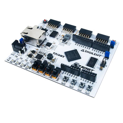

That $99 Arty board is another one to think about:
    33,280 logic cells in 5200 slices (each slice contains four 6-input LUTs and 8 flip-flops);
    1,800 Kbits of fast block RAM;
    90 DSP slices;
    Internal clock speeds exceeding 450MHz;
    Programmable over JTAG and Quad-SPI Flash
    256MB DDR3L with a 16-bit bus @ 667MHz
    16MB Quad-SPI Flash
    Powered from USB or any 7V-15V source
    10/100 Mbps Ethernet
    USB-UART Bridge
and it comes with a voucher for Vivado (a better edition? Not sure)
(I did previously buy a board with a ChipScope voucher - haven't used the resulting licence but at least I have it.)
PostPosted: Sat Jan 07, 2017 2:50 pm
That Arty board looks quite capable for a reasonable price.
PostPosted: Sat Jan 07, 2017 4:29 pm
It certainly does! The DDR3L seems a bit intimidating to me, but perhaps not to you! (The reference implies you can use a supplied interface module to get to an AXI4 (AMBA) interface, so perhaps that's fine.)
PostPosted: Sat Jan 07, 2017 4:36 pm
The DDR3 would be very intimidating if I had to interface it myself, but having working hardware and a Xilinx wizard to do the critical bits inside the FPGA makes it a lot easier.
