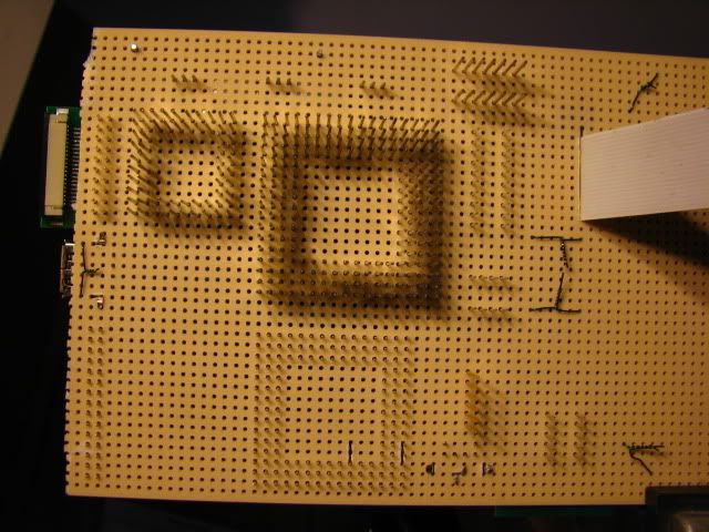

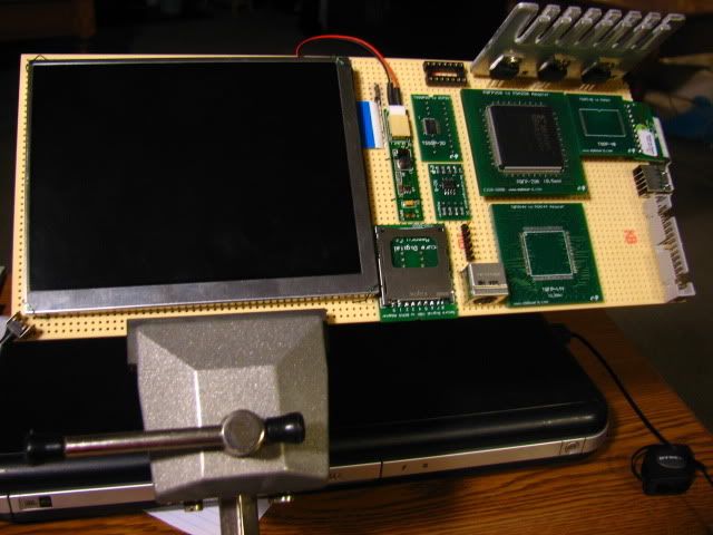

Back to the layout finalization. Got the LED driver in today. Secured it to the Vectorbord with 2 strips of magnetic wire. Same $10 LED driver (5VDCin-23VDCout from NHD) as used in the PWA...
Using the last pic as a reference, after moving the USB connector to directly under the 20-pin FFC connector on the upper right side, there is enough room to fit a 144-pin QFP adapter socket underneath the Spartan 3, with the right edges of the Spartan 3 in line with the 144-pin QFP adapter.
Not thinking of any IC, but this is the max... Also, directly under the Flash next to the Spartan 3, 3 40-pin connectors will fit side by side, with 1 more 30-pin connector fitting directly below the USB conector (as shown below)
_____________________________________________________________
A pic is worth 1000 words. Gone through about 100 words already, I figured I'd post a pic. This is the last one. It will be edited slightly in the future with labels and the addition of 3 40-pin connectors (trying to find wirewrap versions)... (The 144-pin QFP adapter will be used in the PWA project, just using it here as a temp spacer. I didn't even think it would've fit although I did have to edge the Spartan 3 and Flash 1 step closer to the VR's)
Edited: Soon
Underneath:
Edited: 1/26/2011. Added underneath per request.

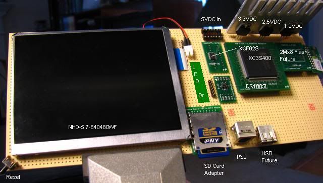

1) What is the 1.2v regulator in your system ?? (looks like they all in to-220 )
2) 2M x8 flash ( what for ?)
3) Sd card interface ( do you what to write a fat16 or fa32 drivers/software)
4) I can’t see any ram chips
All looks like a fake to me :) no offence
I’m new in Spartan 3 designs , do you need pull up resistors in ps2 interface ? ... and the last one , can you please send some pictures of the bottom side of your board ?
 Post subject:
PostPosted: Tue Jan 25, 2011 8:37 pm
bound wrote:
...All looks like a fake to me :) no offence...
Hi bound. No offense taken, I appreciate your interest!...
This is a work in progress, and the beginnings you see here. Progress will be slow at times, for various reasons: I only have 2 days a week to commit, I alone do all the work (software & hardware), and I wirewrap.
bound wrote:
...1) What is the 1.2v regulator in your system ?? (looks like they all in to-220 )...
They are MCP1826 series (identical, in pinout, to the old 78xx series) of 1A DC regulators. The one you point out is a 1.2V 1A in TO-220. The one thing that differentiates them from the 78xx series is their Vout to Vin is low ~2-3V IIRC. All the 78xx series had Vin's up to 35V? Guess this helps in controlling heat... I feed 5V into 3.3V, 3.3V into 2.5V, and 2.5V into 1.2V. Anyway, the 1.2V feeds the internal core which is very well filtered at this point, via the VCCINT pins.
bound wrote:
...2) 2M x8 flash ( what for ?)...
Storing data after power has been removed. One that large can store 1 whole 640x480x3bytes screen full of info, and have another 1M for programs, icons, etc. Also makes it possible to do a "soft" reset (will have to add another reset switch)...
bound wrote:
...3) Sd card interface ( do you what to write a fat16 or fa32 drivers/software)...
No drivers are planned at this point. It is meant as an easy data transfer system. The plan is to store raw binary data from the PC onto the SD card, specifically from MK's 6502 assembler, and then to transfer data to the 2Mx8 Flash, and finally into the core using commands from the keyboard.
bound wrote:
...4) I can’t see any ram chips...
The 6502core will see 64K, all of it internal BlockRAM running very fast. There will be an ability to transfer data to/from the FLASH at slower speeds, to accomodate the 70ns access times of the FLASH, to anywhere within the 64K BlockRAM, again using commands from the keyboard.
Right now I am reading up on how to use synchronous RAM, as all internal RAMs are fed by a clock.
bound wrote:
...do you need pull up resistors in ps2 interface ?...
So far, I've gotten away without using them. I've seen 4.7K pull-up resistors in most designs. May have to add them later...
I was thinking a bottom pic would be necessary too. I will work on it, expect it to be edited into my previous post above soon...

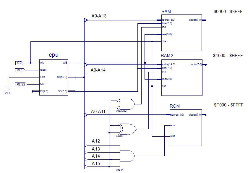

Hit a wall today after I realized the Spartan 3 has nothing in it's library that is tri-state. When I was working with the Spartan 2, it had tri-state buffers. Working with Xilinx CPLD's it was even easier. I think I've hit my personal ceiling at this point attempting to use Spartan 3...
 Post subject:
PostPosted: Thu Jan 27, 2011 7:39 am
Edited: The IOBUF is a tri-state buffer, but it's only available on the pads. Looking at the missing line between the memory douta, and the cpu DI, I realize that you're looking for a way to connect those.
There are two options:
1) Use a 3-input MUX, and use the ena signals to select the input.
2) Enable the SSR input on your memories. Tie enable input to '1', and attach inverted enable signal to SSR input. Asserting the SSR will produce a '0' on the douta signals. This way all the douta values will be zero, except for the one memory that you're addressing. Then use an 3-input OR to OR all douta wires together.
