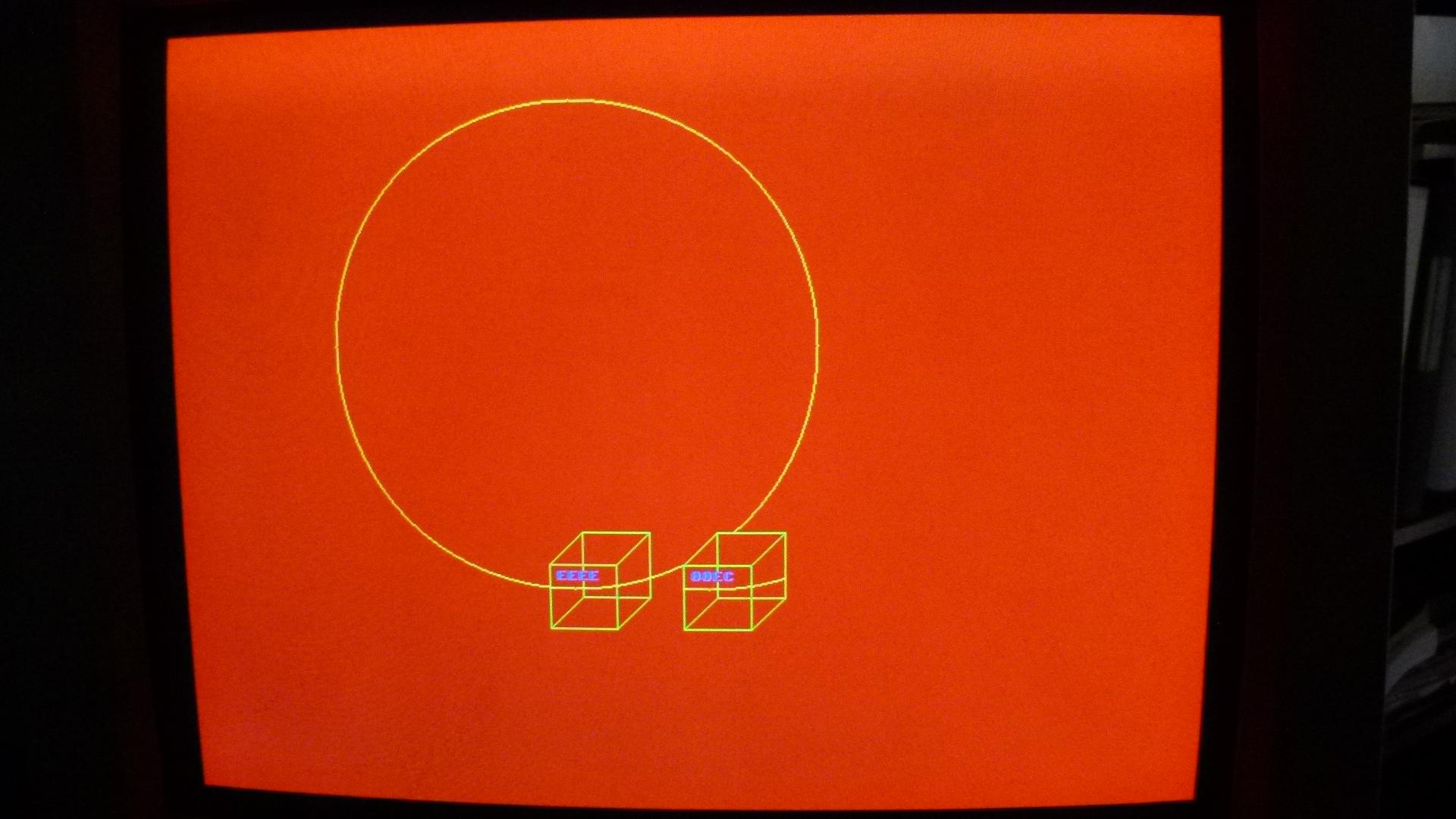

To make it more interesting here is the flow of a new idea for the test:
1) Clear screen to red.
2) Plot green cube.
3) Plot yellow circle intersecting cube.
4) Copy 76x76 pixel square region and paste to the right
5) Plot hex value of RNG in blue
6) Delay
7) Loop to Step 4.
Successfully working with everything in BRAM. Now when the PLTRNG subroutine is in video ram, the proof will be in the pixels to the bottom left of the display. Hope it works!

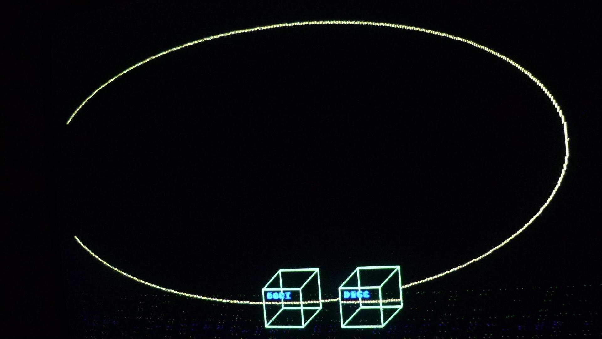

I call this "primordial" success. Modifying the C program I found on Wikipedia I had posted earlier to Verilog and multiplying the X axis by 2.
Far from perfect but headed in the right direction...
Also, you can see the snow interfering with the real pic. The next hardware design will get rid of this annoyance, but for now I try to squeeze everything I can from this board.
EDIT: I need to fix the timing as the multiply is taking up a cycle. But I will try just adding a certain amount 1st, although this will still take up a cycle. I just need to remove my dummy cycle I had inserted for proper timing.

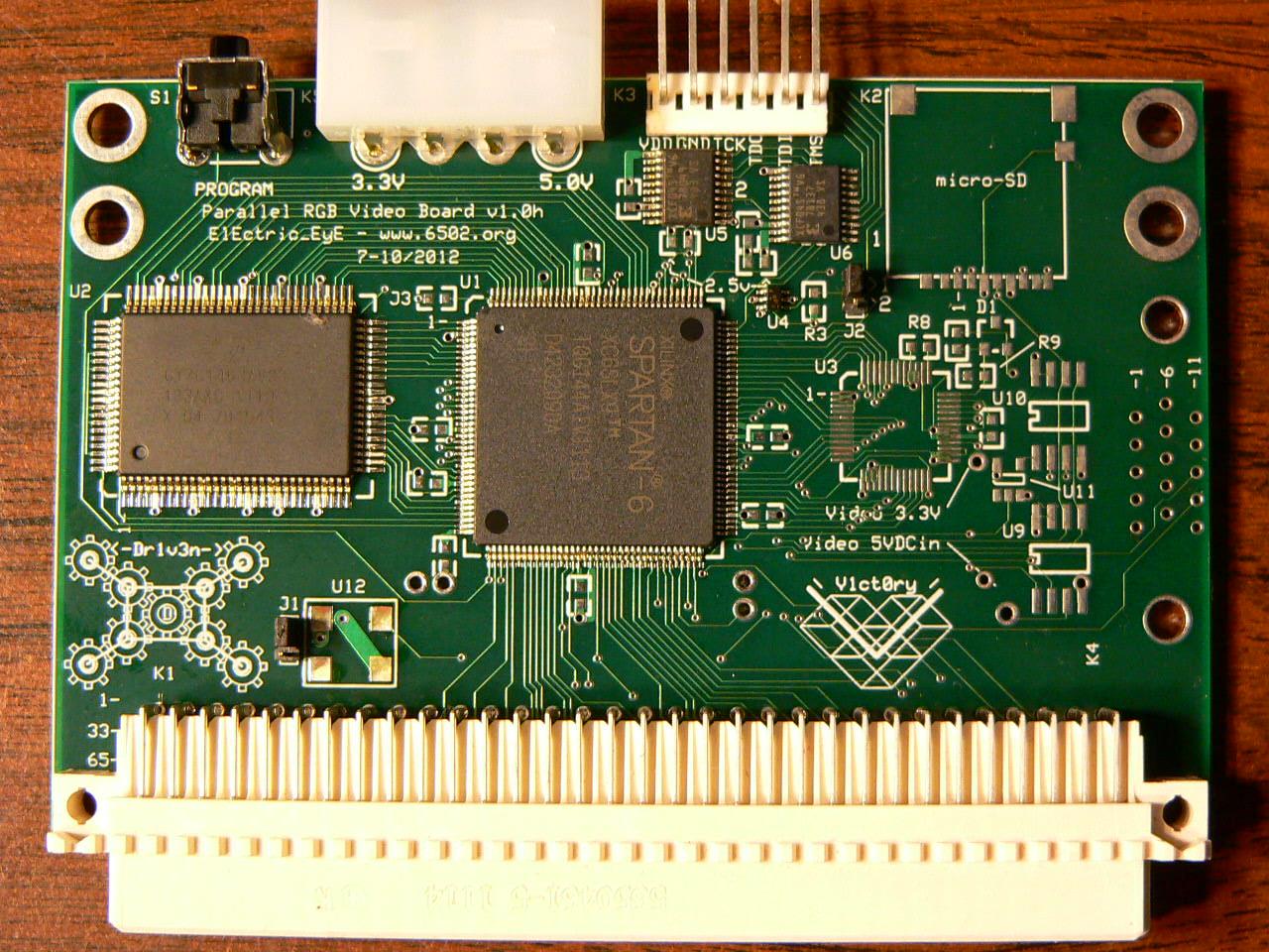

An update: I was away on seeing the family past 4 days...
I came back and dove right in to placing a few components for a 2nd parallel video board to be soldered using my new hot plate construct. I set the temp to 260C. While waiting for the plate to get to temp, flux was placed along the pins of the SyncRAM, FPGA, 2 PROMs, and PROM MUX. Then the devices were carefully placed. After the hotplate reached 260, I placed the board on the hotplate and measured the board temp at 110C almost immediately. After the board temp was measured at just over 170C after a few seconds, it looked like all the solder had melted very nicely and the flux just disappeared and went up in smoke. No extra solder was added. I then removed the board and shut down the hotplate. Then the 1.2V & 2.5V regulators and main bypass caps were soldered in by hand underneath.
I'm now in the process of making a wiring harness for the power and JTAG connections that can span multiple boards. Then I can test this new way of soldering.
Notice there's no oscillator, as it is jumpered for an external main clock-in from the first PVB.
PostPosted: Wed Jul 31, 2013 11:04 pm
Well, ISE did not see the FPGA or PROMs until I re-touched up each and every pin with a soldering iron tip, although I did not have to add extra solder anywhere. This makes for QFP mounting cleaner/quicker/easier. But for BGA mounting this hot plate solution still leaves me doubtful.
