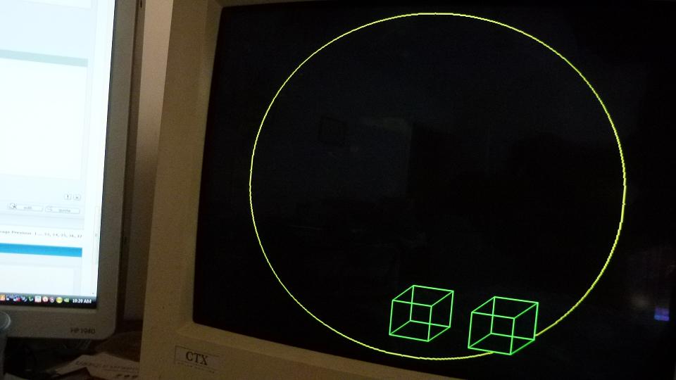

PostPosted: Wed Jul 10, 2013 3:33 pm
Forgot the '2*' in
radiusError+=2*(y-x+1);
Now it is round, also I adjusted the HSize on the monitor to make up for the 1024x1024, non 4:3 ratio. Not sure why the cube on the right appears lighter on color, will have to investigate that.

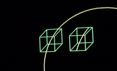

PostPosted: Wed Jul 10, 2013 9:50 pm
After some more testing, I am suspecting I have an issue that has been around since the beginning of the project.
The pixels are too thick.
It is deceiving because a diagonal line seems smooth as it should be @1024x1024 resolution.
I suspect this because once in awhile during previous testing, erroneous pixels would be present. These pixels would be very small, maybe 1/4 size, hard to tell...
I had attributed the pixel size difference to brightness/color of the pixel, or maybe a fuzzy focus of the monitor.
Now, I don't think this is the case, especially since more testing has been successfully concluded.
My apologies to 8bit, as I used his circle routine and I thought it was the software double plotting. I'm pretty certain it is my hardware.

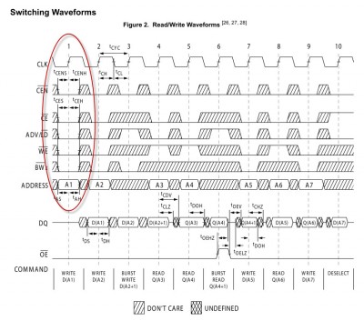

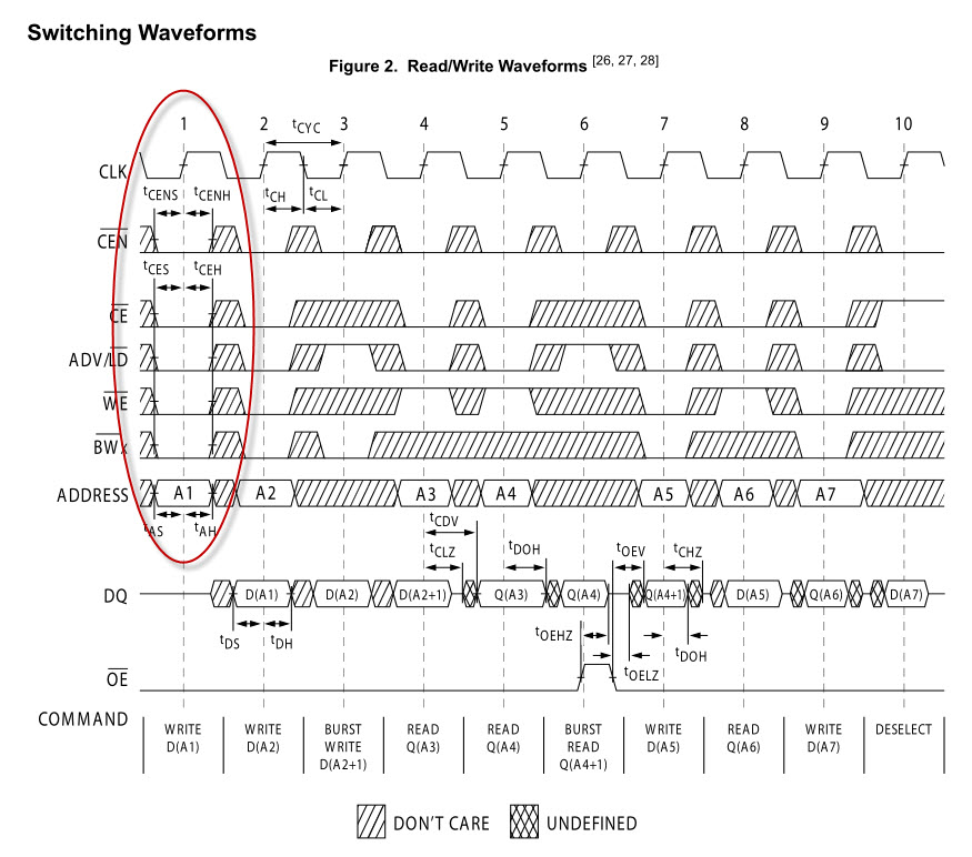

This is a pic taken from the CY7C1463 2Mx18 SyncRAM datasheet:
It looks like everything is timed on the negative edge of the clock. All the code I've written is timed on the posedge.
Is this going to be a problem? or maybe this is why I've seemed to have some success phase shifting the clock by some amounts?

PostPosted: Sun Jul 14, 2013 2:33 pm
Using the RDY to halt the cpu is not necessary, at 25MHz anyway. Will attempt to ramp speeds up now...
PostPosted: Sun Jul 14, 2013 3:17 pm
It's based on the positive edge, but you have to respect the setup/hold times. If there's a non-zero setup time, the clock must be delayed wrt to the signals.
PostPosted: Sun Jul 14, 2013 3:42 pm
Thanks for responding. Told you I struggle with timing diag's, but I see now that dotted line is the clue it is posedge clocked...
I've done many tests now changing the SyncRAM clock phase, i.e. delay, and I think it's going to be real tight @70MHz clock. Tight being a <15deg difference from a working to a non-working design, if it works at all. 70MHz = 14ns cycle time, so 15deg is (360deg/15deg = 24) (14ns/24 = .5ns) .5ns shift.
If it takes 2 cycles for 1 transaction, that cuts the effective 133MHz max speed of the SyncRAM down to 66.5MHz which is <70MHz. So it's probably not going to work. Am I thinking clearly on this matter?
EDIT: There are very definitive, reliable changes in observed behavior when changing the delay of the clock by only .5ns(15deg). I've almost covered then entire 360deg range, in 15deg intervals, starting at 360. Right around 90deg is when the most difference in changes are observed. No luck. I lowered the pixel clock to 64.3MHz on a hunch, still a good picture with 48.5kHz HSync and 60.3Hz VSync. Going in for the kill...

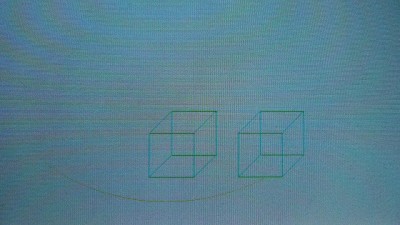

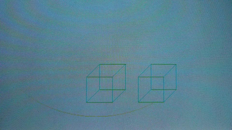

PostPosted: Sun Jul 14, 2013 9:38 pm
Drive of 4mA is too low for this SyncRAM. Just changing the screen color to black from blue resulted in alot of bad pixels.
Increasing drive to 6mA cleared 99% of them. More testing is needed to find the most efficient drive strength.
EDIT: Observations are: Changing slew rate from slow to fast had no effect. Changing drive strength from 4mA to 6mA had a large effect, as mentioned. Increasing drive strength from 6mA to either 8mA or 12mA had negligible effect. So, I continue forward with 6mA and more testing.
PostPosted: Sun Jul 14, 2013 10:16 pm
Another problem: I changed the FPGA output pins driving the videoDAC and monitor signals from 6mA to 12mA with no change. Maybe I need the impedance matching resistors now? The yellow is disappearing into the white. Should be green cubes on white background.
I'm done for today, thoroughly worn out!
