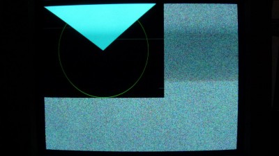

PostPosted: Wed May 08, 2013 1:34 pm
Everything transitioned over (except the software as you can see below) to 1024x768 no problem. Everything running @70MHz now. Next I'll hook up 1 of the .d core's control bits to control page flipping.
File comment: Caught in the midst of a 'radar sweep'
PostPosted: Wed May 08, 2013 3:45 pm
The software has been updated and everything works in 1024x768 as it did in 640x480.
Added the Control Bit 0 for page flipping. Was easy, just 2 extra opcodes were used in the assembly. A CCB0 opcode to set page 0. Clear the screen, plot a circle and perform the line drawing 'radar sweep'. Finally a SCB0 to perform the page flip. I did not take heed of vsync though, to avoid the tearing effect that is sure to be expected, I will add vsync to Control Flag 1 and test for it before doing the page flip.
Now this is getting exciting! So easy from a programmers POV now, but I especially love the hardware aspect of where this project is headed.
With the page flipping I look forward to getting rid of the "snow effect". Not only that, page flipping should make moving objects appear smooth, unlike if I were to have 1 video page and attempt to a software PLOT, CLEAR, PLOT, CLEAR, etc. I remember having issues scrolling a character in the C-64 video, and I had found the solution but that was years ago, and now it shouldn't even matter.
