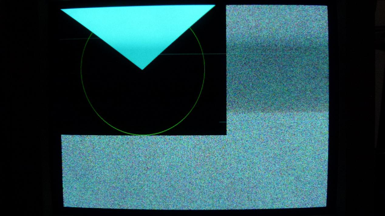

Re: Concept & Design of 3.3V Parallel 16-bit VGA Boards
Yay it works! I confess I did not start on the state machine, it just seems too simple of a thing for a state machine. So far I have just writing to the RAM down 100% now. I did skew the clock going to the SyncRAM to make up for the FPGA delay. Maybe it's cheating, but it works! I lowered the speed of the cpu to 50MHz so I wouldn't be slowed down by running smartexplorer all the time.
It successfully clears the screen blue in software (can probably do this in hardware now), cpu sends coordinates to LineGen and is delayed a set amount, LineGen draws a red line, then the cpu draws a yellow circle.
Here is the simple interface code:
I think the next logical step is to add a 'Done' bit to the LineGen module and send it to one of the cpu flags.

BCF0C $FFFE ;CF = LineGen Ready. 1 = readyWish I had the cycle counter to prove it, but I don't notice the pixel color problem and lack of circle pixels. I had noticed this effect when I did an experiment to test the priority when the cpu was trying to plot at the same time LineGen was outputting.
Everything transitioned over (except the software as you can see below) to 1024x768 no problem. Everything running @70MHz now. Next I'll hook up 1 of the .d core's control bits to control page flipping.

The software has been updated and everything works in 1024x768 as it did in 640x480.
Added the Control Bit 0 for page flipping. Was easy, just 2 extra opcodes were used in the assembly. A CCB0 opcode to set page 0. Clear the screen, plot a circle and perform the line drawing 'radar sweep'. Finally a SCB0 to perform the page flip. I did not take heed of vsync though, to avoid the tearing effect that is sure to be expected, I will add vsync to Control Flag 1 and test for it before doing the page flip.
Now this is getting exciting! So easy from a programmers POV now, but I especially love the hardware aspect of where this project is headed.
With the page flipping I look forward to getting rid of the "snow effect". Not only that, page flipping should make moving objects appear smooth, unlike if I were to have 1 video page and attempt to a software PLOT, CLEAR, PLOT, CLEAR, etc. I remember having issues scrolling a character in the C-64 video, and I had found the solution but that was years ago, and now it shouldn't even matter.
