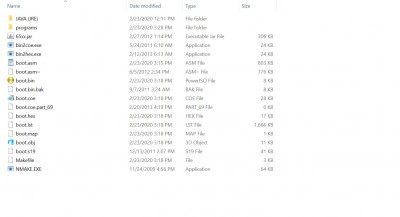

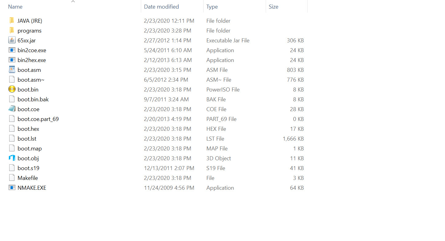

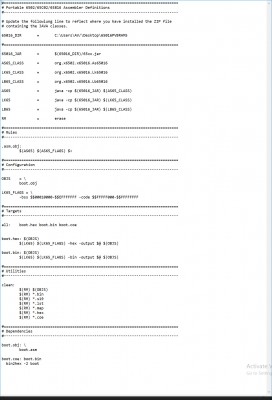

The makefile, yes! I see it now. I remember having to modify it slightly. I got it working! Thanks Bitwise!
Here's the files I have in that folder and how I modified the makefile. Running NMAKE automatically generates the .coe file needed by ISE from the boot.asm file, which is just a text file including all the macros for the new opcodes, and also the software. I really need to add this to Github. Also, credit to Arlet for making the bin2hex and bin2coe.
EDIT: I've added 65xx.jar, bin2coe, bin2hex, Makefile & NMAKE to Github.

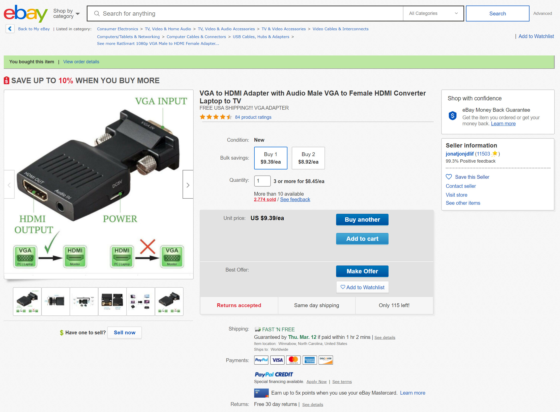

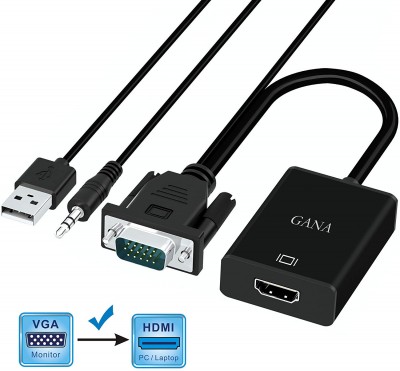

Also, I was reminded today that the monitor I was using for 1080p graphics I had given to my son long ago. Currently I use the old HP1940, as mentioned before, for project video out only. So maybe this HP1940 is not recognizing the signals for some reason, although I have lowered the pixelclock to 75MHz for the PVBoard and 25MHz for the 1080pAV board.
My larger current monitor, which I've been using for ISE, only has HDMI inputs. So I think it's time to buy a VGA to HDMI converter with audio input which will allow me to try another monitor and experiment with the audio in the future.

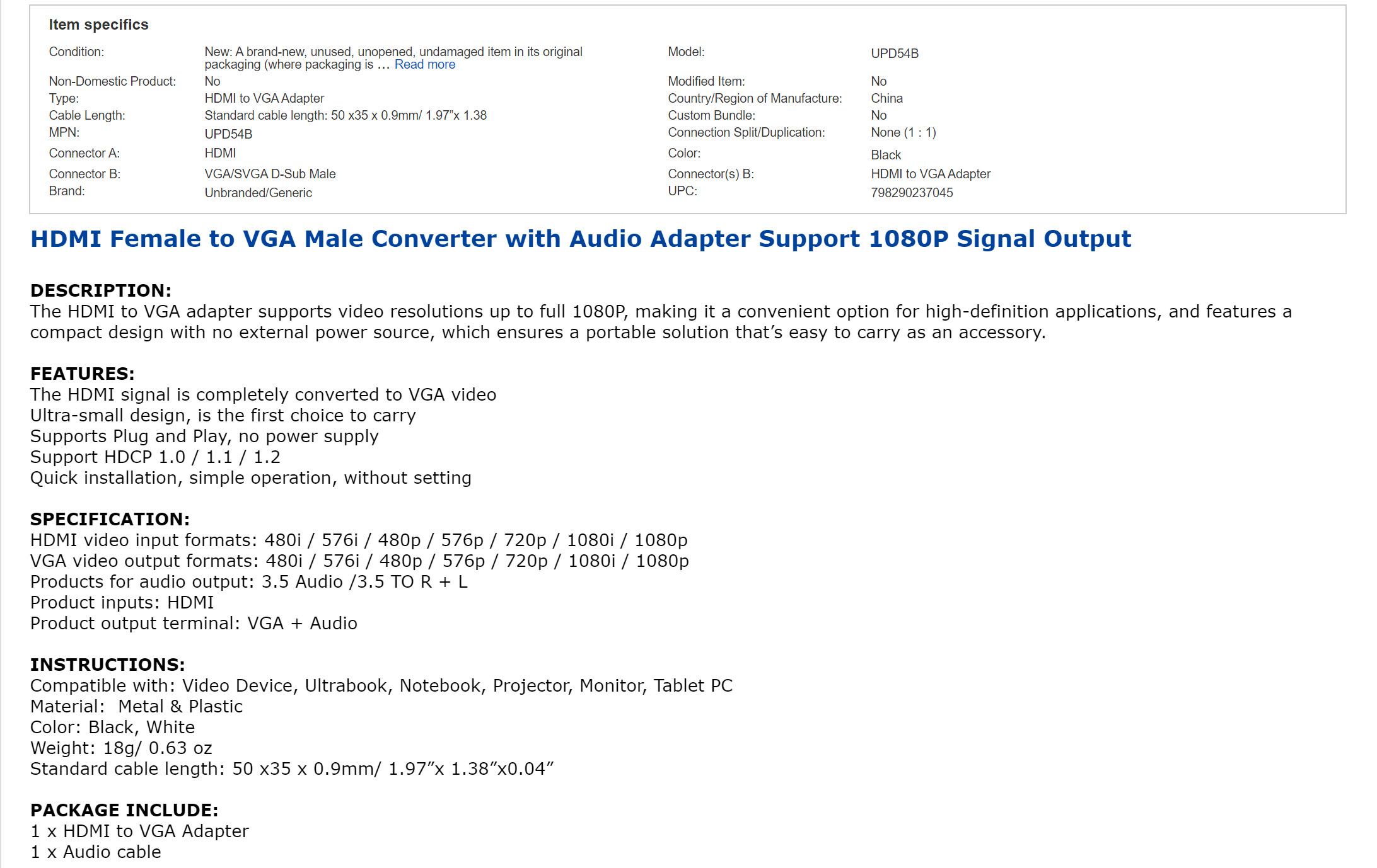

PostPosted: Thu Mar 05, 2020 10:09 pm
Interesting gizmo. But is it really what you need? Maybe I'm experiencing mental flatulence. The ad seems to say the device converts to VGA.
PostPosted: Thu Mar 05, 2020 11:38 pm
Dr Jeff, I took out the 'audio stream + VGA' into the HDMI connector as a sign it was VGA to HDMI as the VGA connector has no audio out
PostPosted: Thu Mar 05, 2020 11:56 pm
Still an interesting gizmo. And a remarkably low price.
Re a VGA to HDMI converter, let us know what you find. I have a feeling it will be less of a bargain, unfortunately... :|
PostPosted: Fri Mar 06, 2020 1:17 am
Posts: 730
Location: Tokyo, Japan
That audio connector would also be needed the other way around for the same reason: the HDMI is supplying both video and audio, the video goes out the VGA connector, so where does the audio go?
I am suspecting, both from the price and the lack of external power input (as well as the product description, of course) that this is HDMI to VGA. It looks and is priced suspiciously like the the DVI to almost-anything "converters" that merely get the wires out to the right connector and rely on the DVI port to be able to send VGA or whatever signals to the right pins. (Though I wasn't aware that HDMI could do that.)
If it helps, I have attached an image of what VGA to HDMI adapter I successfully use on my old laptop looks like. (This is a standard cheap Chinese product available under a zillion different brand names.) It cost about $12. I can't say how good it will be with odd resolutions and timings, but it does support close to twenty different "standardish" modes, including ones such as 1440x900. (I can go plug it in and grab the full mode list for you if you need it.)
Though personally, given all the trouble these standards are, I might just go back to an analogue monitor. I picked up a nice 9" Sony PVM with all the modes for about fifty bucks on Yahoo Auctions, and didn't Bill Gates say that "no one will ever need more than 15.750 kHz"? :-P
PostPosted: Fri Mar 06, 2020 9:30 am
Hmm - that diagram in the picture shows a VGA monitor connecting to an HDMI PC/laptop. I'd have drawn the arrow in the direction of data flow. Does "VGA to HDMI" mean "take my VGA signal and display on an HDMI device" or does it mean "convert my VGA peripheral to use the HDMI standard"?
PostPosted: Fri Mar 06, 2020 11:49 am
Posts: 730
Oh, I'd not noticed the "Monitor" and "PC/Laptop" writing in the diagram. Yeah, that's wrong; my laptop has a VGA output and I use this to display on HDMI TVs and projectors. Clearly they're really working to make this confusing.

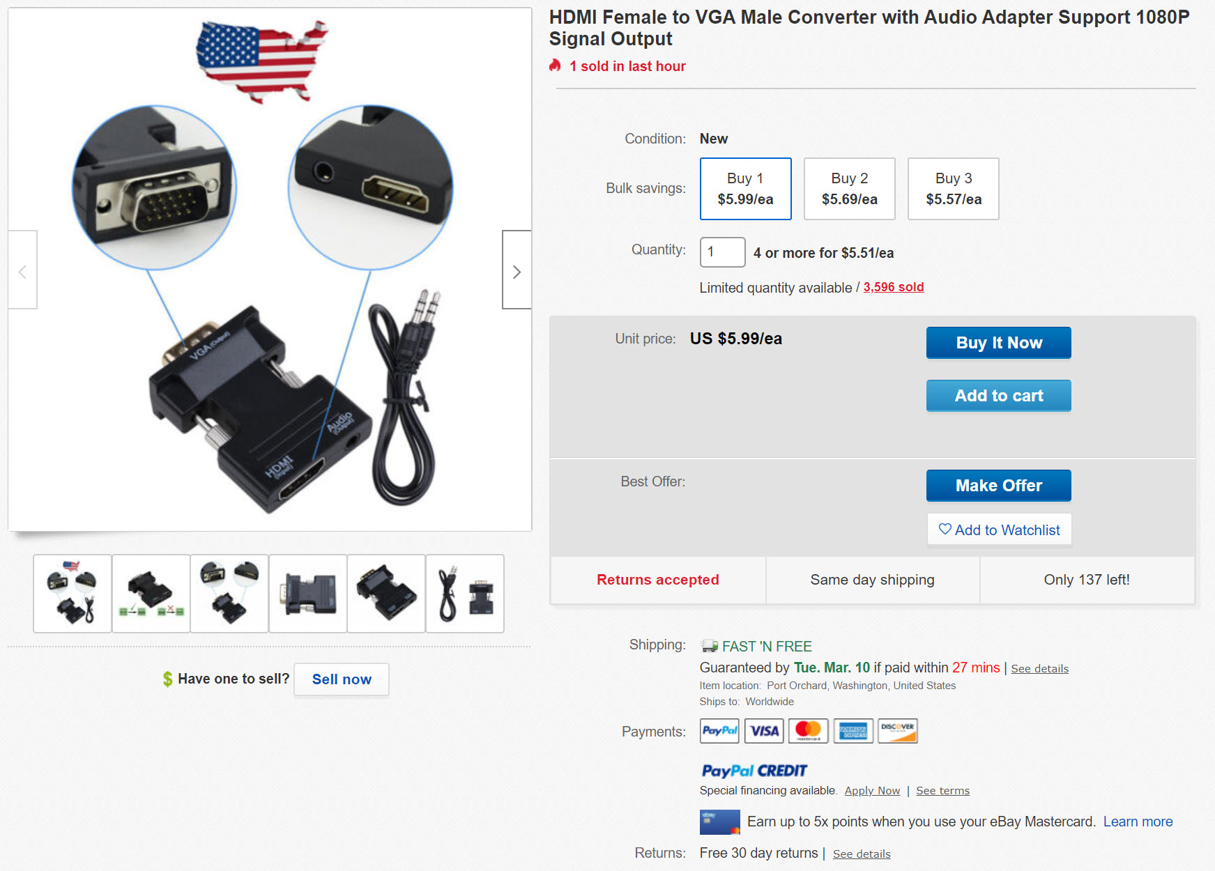

PostPosted: Fri Mar 06, 2020 1:01 pm
Woops, up I ordered the incorrect type. The correct one is like cjs posted above with the 5V USB connection on the side of the converter. Mental flatulence as Dr. Jeff said. :lol: :lol:
It's nice to have a HDMI to VGA converter tho. Gets my mental gears spinning...
Here's the one I ordered. The seller is located in NC so hopefully it'll get here quicker. Reading the reviews makes it clear the 5V power from the USB must be plugged in for it to work.
