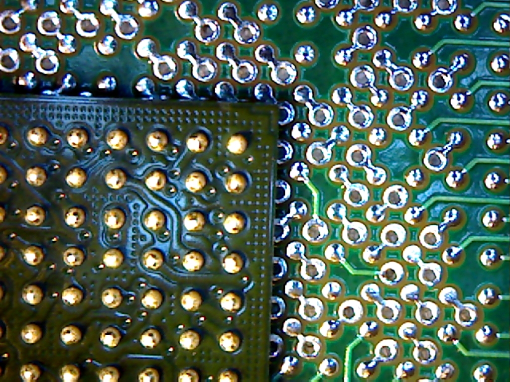

Here is a real closeup of another version of a Spartan 6 upside down with the board behind it for comparison. It is a XC6SLX9-3FTG256I. I bought it awhile ago just to gaze at it, wondering if I could conquer it.
The FT(G)256 package has identical pinouts for the LX9, LX16, and LX25. I'm still waiting on the LX25's to arrive.
I'm trying to decipher the spec's for the FT(G)256 package on pg. 335 of UG385. Specifically, the symbols 'ddd' & 'eee'. Any ideas?
I'm tempted to try mounting this LX9, with just flux, and then just go ahead and test for shorts. It's a $28US part vs ~$50US for the LX25 part...
For reference, the board BGA pads are .020"(.508mm), and the FGPA balls are spec'd at .4mm (min) & .6mm (max).
(I wonder if that yellowish tint on the BGA solder balls is due to the silver/copper replacement of lead, since it's a FTG package)
I'm guessing they are tolerances: ccc is flatness, ddd is conformity of the bottom surface of the balls to an ideal plane (so, flatness again), and eee is variation in ball placement(?)
And yes, it says the balls are tin/silver/copper so that explains the hue.
