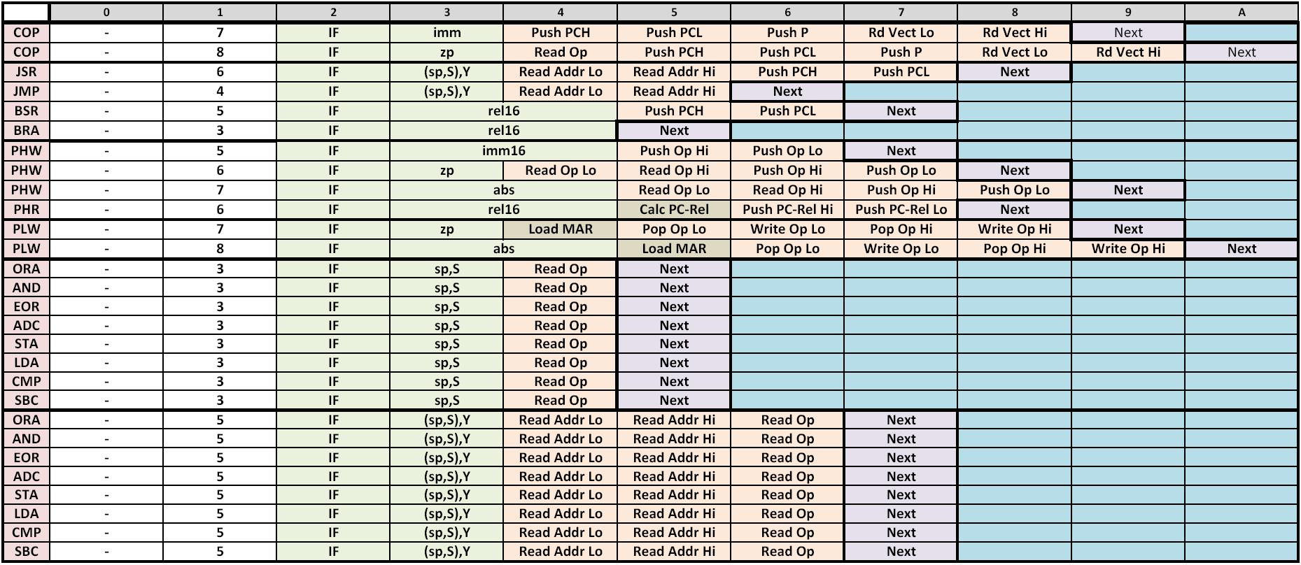

The following image provides the cycle counts for the M65C02A-only instructions being discussed on this thread. The attached image is for the M65C02A-only instructions that I've recently added. I've yet the define and implement the FORTH VM support instructions that have been previously discussed on this thread. In addition, I've not yet added the prefix/escape instructions that I've discussed or suggested by Jeff. There are currently two opcodes reserved for prefix/escape instructions, but not final definition of their operation has been finalized. (The cycle counts for the other M65C02A instructions, which are common with the 6502, 65C02, and W65C02S processors, are provided here.)
File comment: Cycle Counts - M65C02A-Only Instructions

Have checked out the following new instructions:
  • BSR rel16 (M65C02A only)
  • BRA rel16 ('816 BRL rel16)
  • PHW #imm ('816 PEA abs)
  • PHW dp ('816 PEI dp)
  • PHW abs (M65C02A only)
  • PHR rel16 ('816 PER rel16)
  • PLW dp (M65C02A only)
  • PLW abs (M65C02A only)
I have a problem with the generation of sequential stack frame references for the (sp,S),Y addressing mode. The modification that the I put into the address generator to support PC-relative address is causing a conflict. I will work on to resolve this issue over the next week.
The stack relative addressing for a single bytes is fine, but not completely checked out.
Michael A.
 Post subject: Re: M65C02A Core
PostPosted: Mon Aug 11, 2014 3:38 am
Posts: 760
Location: Huntsville, AL
Never mind about that (sp,S),Y issue. Add the following new instruction to the verified list:
  • JSR (sp,S),Y (M65C02A only)
Microprogramming is a great tool; no change required to the core's RTL. Did have to change the way that I pull the indirect address out of the stack frame. I expected to read the low byte first and then the high byte. However, solve the issue with the post-indexed stack-relative indirect addressing mode, I now read the high byte first and then the low byte. When the low byte is read into the core, the temporary register holding the stack frame index is overwritten with the low byte.
Some RTL will need to be modified in the near future if I want to add 16-bit operations (a la '816) as has been suggested by others on this thread. In order to perform 16-bit operations, 8-bit operations must be carried out least significant byte first. As I've patched it at the moment by reading the high byte of the indirect address pointer first, it won't support sequential 8-bit data reads starting with the low byte for 16-bit operations.
Michael A.
