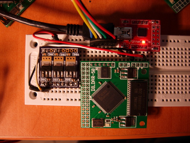

Here is my testing and programming setup for now:
Power reg board (I am only using the 3.3V output) is on the left; above right is the USB-serial board. Note that the CHOCHI board has no connectors soldered - the board is fitted over a pin header on the plugboard. I find that I can fit the CHOCHI over the pin header and tilt it a little to make solid (but temporary) connections, long enough to program the flash and test the board.

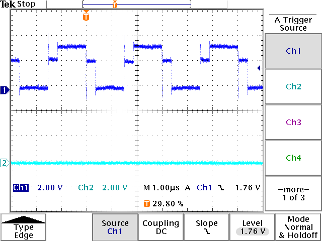

Looking at some SRAM pins with the scope, I noticed intermediate voltage levels. Looks like colliding bus drivers. Any idea ?
(I didn't update the bitstream, so it's still with the default that you programmed it with)

Hmm. That should not be the case (My apologies - I thought I'd tested your board)... The new bitstream should not be different as far as the SRAM goes, so the first thing I would do is update it and try FIG-FORTH and EhBASIC - most SRAM issues will make them not work right away.

What pins showed weird voltages?
PostPosted: Sat Sep 28, 2013 6:35 am
This is what I see on pin 7 (D2) of the SRAM chip.
PostPosted: Sat Sep 28, 2013 7:07 am
Weird. When I touch the data pins with my finger while measuring the signal,I get strange distortions in the waveform. Doesn't look like bus collisions, but rather some high impedance signal from the FPGA, so there's a good chance the effect is benign.
