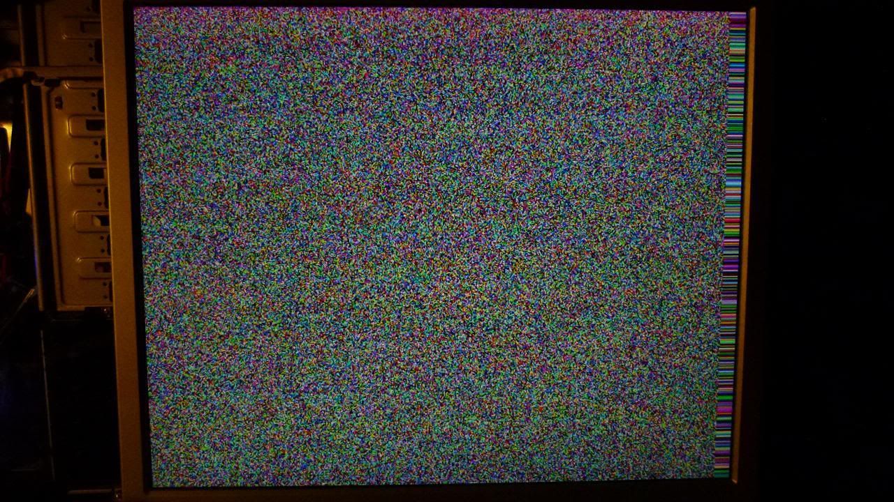

I've made the suggested changes. Now the pixel clock going to the videoDAC and the syncRAM are the same. Also using vstart to zero my address counter, and getting rid of SRAddrtemp. Now it's rock steady, and clean signal. Pic is deceiving as there are no borders yet. I will try to push the limits of the SyncRAM and see the upper limits of resolution. Aiming for 1024x768 next, @768K there is enough RAM for a framebuffer. I think 1280x1024 will be out of the question. One thing I would like to do is add registers to Arlet's HSync module, so variables can be programmed by a cpu on the fly.

I can't understand why there are those horizontal bars at the right hand side of the screen.
PostPosted: Fri Sep 28, 2012 6:50 pm
It looks like whatever is pushing new pixel values stops when it thinks it is at the of the line. (It's pushing them from the wrong source, or wrong locations, I suppose)
PostPosted: Fri Sep 28, 2012 6:54 pm
I think the RGB outputs need to be set to black during front/back porch and blanking interval. The monitor is probably getting confused about the resolution now.
PostPosted: Fri Sep 28, 2012 7:04 pm
I have tried to do a quick test and logical NOR the vblank and hblank signals for the active low DACBLANK signal. It drives the RGB outputs to the blanking level. My little experiment didn't work when I was working with the vertical bar test.
PostPosted: Fri Sep 28, 2012 7:11 pm
I mean something like this:
always @(posedge clk50)
   if ( pclk )  begin
      Red_data   <= countflag ? SRDtemp [15:11] : 0;      //outgoing data to videoDAC
      Green_data <= countflag ? SRDtemp [10:5] : 0;
      Blue_data  <= countflag ? SRDtemp [4:0] : 0;
   end

Also, I'm thinking I should also test to see how this picture is looking on an older non-multisync VGA crt. I can do this test next wed. May have to use the PLL to get closer to the ideal 25.175MHz, will still be a couple hundred Hz off though.
PostPosted: Sun Sep 30, 2012 7:20 pm
Did some testing on an older CRT manufactured in 1998, unsure if it has the multi-sync hardware built in. There were vertical borders present, clearly seen about 1/2" on top and bottom. Also, bars like the ones on the right side of the above pic (flat screen monitor), were on both sides of this monitor. So the observation seems to be inline with some of my readings, that the newer flat screen monitors automatically trim HSYNC and VSYNC timings so that there are practically no visible borders.
I changed my code by memory from what Arlet had mentioned before. I thought he had used hblank as the trigger, but I saw he chose countflag. Maybe it doesn't matter? But it works. Interesting thing though, the picture is much brighter than before. I will add the 75ohm load resistors back to the videoDAC RGB outputs.
So this means I will have 1 more global clock pin freed up on v.1.0h, since I can just tie the videoDAC Blank pin high. EDIT: I think this pin will best be used for a separate MicroSD adapter serial clock apart from the serial clock common to the FLASHs.
