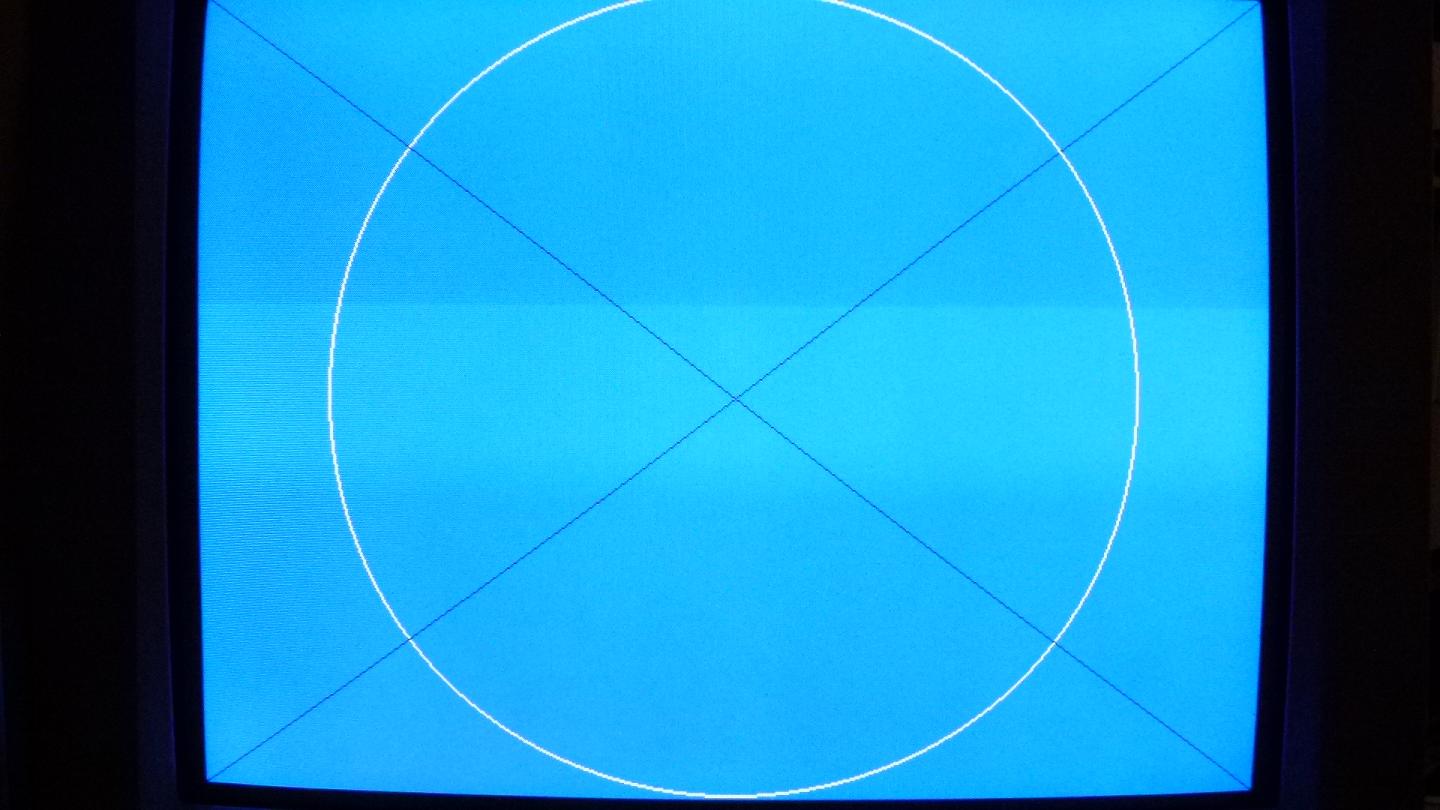

PostPosted: Sun Apr 14, 2013 10:00 pm
There is one thing left I'm in the process of completing and that is the case of an opposite slope, e.g. (0,10) to (10,0) where the dy is negative since the plotting is being done left to right in all instances. Once this is done, all other possible combinations will just require a swapping of start/endpoints. Although I have already tried 2x and gave up. I will re-study what I've done successfully up to this point, make some notes and then maybe start from scratch, althought I have 1 more idea to try tonight involving the current code.
PostPosted: Mon Apr 15, 2013 12:57 am
Success! 1 case left to consider: -dy, steep. -dy, !steep works.:
module LineGen ( input clk,

PostPosted: Mon Apr 15, 2013 11:37 am
I couldn't reliably test for dyneg in the LOAD state, so I had to add 1 more state, which doesn't really slow things down any as the main loop is still CALC2 --> PLOT --> CALC2... Plus a minor correction or two. Hopefully I can get this finished today so I can start working on melding it to the project. I'm optimistic this LineGen module coding is tight because top speed of the module itself has not changed since the beginning stage, @180MHz... So far these coordinates work in ISim:
(0,0)  to (20,20)
(0,20) to (20,0)
(0,0)  to (20,2)
(0,0)  to (2,20)

PostPosted: Tue Apr 16, 2013 1:05 am
BitWise wrote:
Are you drawing the last pixel in the lines you are generating?
Its quite common not to plot the last pixel so that vertices are not double drawn when ploting a succession of lines around a polygon, especially if the pixel values are being XOR'd into display memory.
Hi Bitwise! No to your first question... And, I'll remember that pointer about the vertices because I believe the code is complete and real world testing is about to start.
Sorry about the lack of comments, but reading over my last post of the code with comments just seemed pretentious, also it was confusing me because the code was still changing. I guess comments should be saved for last!
My code seems to work for any numbers I throw at it, for the Start/End coordinates. Please let me know if anyone sees a problem.

I have successfully drawn 4 lines using my LineGen state machine running @100MHz alongside the .b core. I have it set up so that it immediately starts plotting each time after the cpu has sent the last coordinate, i.e. 'y1'. The software sends x0, y0, x1, finally y1. I put a software delay in after sending the final y1 coordinate as I have not yet added in a DONE state to LineGen and it takes 2 cycles for each pixel to be plotted + another 4 cycles for each line total.
Just as I have tried to route the stack page and zero page pointers off cpu, I tried to do the same with the B accumulator, which I want dedicated to the pixel color. This part is not yet correct as the FPGA is writing '0's to the external SyncRAM instead of the B accumulator value that I can see in ISim correctly as a yellow value 'FFE4' (although it looks blue in the pic). More work is needed, but I am very pleased with the progress, and the Spartan6 product. :D
The 4 line coordinates are (swapping is still needed as not all coordinates functioned correctly):
(0,0) to (320,240)
(320,240) to (639,0)
(320,240) to (639,479)
(0,479) to (320,240)
So in the name of the projects' progress I think I should post the LineGen, especially since it will be the last post on this page:

File comment: 640x480 resolution. Daryl's Bresenham circle and 4 lines from LineGen.

I added in the check for when x0>x1, so now it'll plot any coordinate except when x0=x1=y0=y1. That's untested. I made a video of a test I did similar to the last video, except this one I had to slow down with a large delay between each line. You get to see my dog too, lol. You can tell it doesn't like being filmed. The delay is a 16x countdown from 65535 to 0, so over 1 million cycles. I still have to figure out why the RAM is getting zero's for the pixel value.
