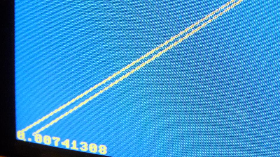

Ok, testing version 'D' without the 'BIT' optimizations. 741,374 cycles!
Testing with the 2nd BIT optimization active: 741,257 cycles.
Testing with the 1st BIT optimization active: 741,308 cycles.
They all look the same... We'll have to see if the degredation is tolerable when the lines are moving. Daryl, thanks for your hard work!

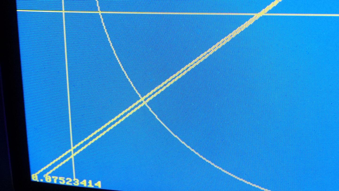

Although it didn't change the looks of the line, cycles went down to 741140. I'm going to start optimizing from my end now. Here is the new line plot, version 'E'. I've chosen the fastest of your dx/dy optimizations and they're being utilized both times in your routine. First I'll replace the JSR for plot pixel. This is the biggest improvement.
Line16.e.asm [4.68 KiB]
Downloaded 59 times
PostPosted: Sun Apr 07, 2013 10:42 pm
I've halted my optimizations...
This morning I plotted a circle with the lines. Replaced 2 of the lines with 1 vertical and 1 horizontal to make sure they work. They did... But the line error was more noticeable plotted against the circle. Looks like the lines were too thick up against the circle.
I decided to go back to ground zero, to when Daryl's Bresenham line routine first worked, and then double check all the additions to the line plotting code 1 step at a time and one thing is evident at first glance: There is no check for when DX=0 or DY=0 after the original.

I went back and looked at the original pic when I first had success. I must have been so excited I didn't notice the error, so your optimizing is good to go. :D
With the circle plotted along with some diagonal lines crossing it, I can see it looks like for every single horizontal pixel that should be plotted, it is plotting 2, side by side.
EDIT: The error is nothing like I was experiencing here, just double wide horizontal:

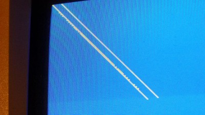

No, don't spend your time yet. I will go to ISim now and resolve this, now I'm thinking it's an optical illusion or something.
Here's a pic of what I'm seeing though:
PostPosted: Tue Apr 09, 2013 12:23 pm
This pic more clearly shows the problem I'm having.
The coordinates of the line on the left is (0,0) to (100,101). The other is (10,0) to (110,100). Is this the correct action of your algorithm?
EDIT: I should've pointed out that this is the version 'E' with the DX&DY optimizations commented out.
Interesting, I just uncommented the optimizations. The second pic is the 1 optimization that was fastest. Same result with the other 2 optimizations.
