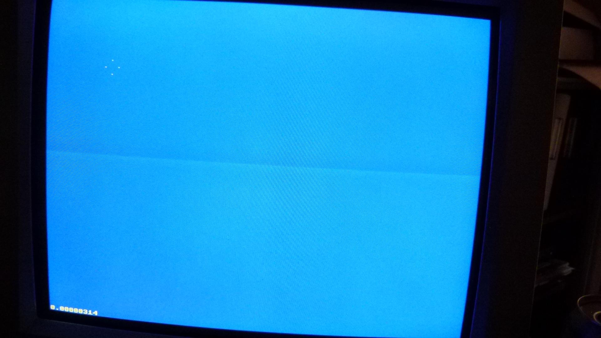

Mild success. The radius is set to 10, and the XC and YC are (100,100).

Looks like you got to the start of the loop (0,90,180,270 deg points got plotted correctly). It's a start!

I had nothing at first. Then 1 pixel, then 2. Then 4, which is when I posted...
I'm running through your code now using ISim, and skipping all the real world stuff like clear screen and character plotting for the timer.
Hopefully I can do this one step at a time and post. It's a dual step here where I have to understand what's going on in your program, then convert to 65O16. I guess I can consider ISim my real world emulator. I will make more progress soon. :D

With a clear mind and using ISim, I was able to track down where it is exiting:
_CLOOP
; WHILE (X<Y) CALCULATE NEXT PLOT STEP
                  SEC
                  LDA X1
                  SBC Y1
                  BCC _C4       ;X<Y
                  RTS
The carry is set with X1=0, and Y1=RA=10, so it is not branching.
EDIT: Looks like another problem with the .b core. Changing the BCC to a BCS plots the circle, then continues off into infinity. The SBC is not resetting the Carry flag. I'll check this out next.

Looking again at the ALU the case where A-B. Considering if A=$0000 and B was $FFFF, then value of temp_BI was just be $0000 and temp would be $0000 or $0001 depending on the CarryIn. I think temp_BI needs to be expanded to 17-bits, that would result in a value of $10000. Then modify the CarryOut to toggle the CarryIn if (temp_BI[16]) is set.
always @* begin
    case( op[3:2] )
        2'b00 : temp_BI = BI; // A+B
        2'b01 : temp_BI = ~BI; // A-B
        2'b10 : temp_BI = logical; // A+A
        2'b11 : temp_BI = 0; // A+0
    endcase
end
//always @(logical or temp_BI or adder_CI)
always @*
    temp = logical + temp_BI + adder_CI;
// calculate the flags
always @(posedge clk)
    if( RDY ) begin
        CO <= (shiftrotate ? tempshifted[dw] : temp[dw]);
    end
I've expanded the temp_BI register and it looks good. Working on the Carry.
Sound logical?
PostPosted: Sun Mar 31, 2013 5:24 pm
In the 8 bit core, the temp_BI signal is only 8 bits, but I don't think there's a problem with the carry. Not sure what the problem is.

Thank you both! I was going to ask Arlet the following, but I think I've found my problem, in the middle of posting, in the opcode decoding for the adc_sbc flag.
In your core, when it executes any opcode that sets the OP_SUB flag for the ALU.v to do a subtraction, in which the ALU would have to change the C flag going back into the cpu, I don't see how that CO signal works it way back into the cpu.v for the OP_SUB opcodes.
 * Update C flag when doing ADC/SBC, shift/rotate, compare
always @(posedge clk )
    if( shift && state == WRITE )
   C <= CO;
    else if( state == RTI2 )
       C <= DIMUX[0];
    else if( ~write_back && state == DECODE ) begin
   if( adc_sbc | shift | compare )
       C <= CO;
   else if( plp )
       C <= ADD[0];
   else begin
       if( sec ) C <= 1;
       if( clc ) C <= 0;
   end
    end
The adc_sbc is for the addition opcodes
EDIT: In comparing the 2 cores, I think I just saw my error. One I think I've had from the very beginning of tinkering with Verilog and your core. I had misunderstood your adc_sbc flag to be set for only the ADC opcodes, which I always thought was strange. Which now I see it is strange, because it's wrong. :lol:
PostPosted: Sun Mar 31, 2013 6:49 pm
It works!
I had to loose the random number generator so the project would fit, luckily the timer still fit after 15 runs of smartexplorer!
I timed a circle with radius 150 @.6mS. Very nice looking circle.
