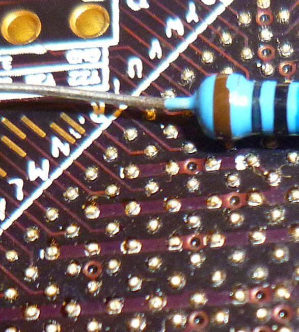

Here is a close-up of a failed board with a little resistor for scale. You can see the power distribution buses under the mask, and get a sense of the vias. Note that on my board I did not need that many IOs - I connected an SRAM and every pad of the 6502, a 44-pin connector (a few pins for power) and two 'butterfly' connectors with 4 extra IOs, and have a dozen spares connected to tiny pads. All using the top layer. Only a few special connections (JTAG, power, clocking, configuration) are routed to the bottom.

So oshpark's via's look like they do have soldermask over them?

You could do mask or no mask, it's up to your CAD package. The post sockets in the upper left are just big vias.
EDIT: I think they call them 'tented' vias if they have a mask.
