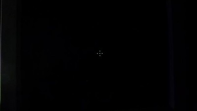

ClearScreen and the Origin (green pixel):
START:       LDA #$0000
            TAZP                 ;SET ZEROPAGE @$0000_0000
            LDA #$0001
            TASP                 ;SET STACKPAGE @$0001_0000
            LDWi $0000           ;  LDW #$0000 - SET BLACK SCREEN ACCORDING TO COLOR LUT
            LDBaw COLTABLE       ;  LDB COLTABLE,w
            STBa SCRCOL          ;  STB SCRCOL
            JSR CLRSCR
            LDWi $0005           ;  LDW #$0005 - SET PIXEL COLOR GREEN ACCORDING TO COLOR LUT
            STBa PXLCOL          ;  STB PXLCOL
            LDA #$0140           ;X CENTER OF 640x480 SCREEN
            STA SCRLO
            LDA #$80F0           ;Y CENTER OF 640x480 SCREEN
            STA SCRHI
            LDY #$0000
            LDX #$0010           ;16 PIXELS WIDE AROUND THE ORIGIN
            STBiy SCRLO          ;  STB (SCRLO),Y
END         JMP END
CLRSCR      LDA #$0000        ;$8000_0000 START OF VIDEO MEMORY
            STA SCRLO         ;X VALUE
            LDA #$8000
            STA SCRHI         ;Y VALUE
            LDX #$01E0
            LDA SCRCOL
AB          LDY #$0280        ;$81DF_027F END OF VIDEO MEMORY
AA          STA (SCRLO),Y
            DEY
            BNE AA
            STA (SCRLO),Y     ;GET THAT LAST PIXEL!
            INC SCRHI
            DEX
            BNE AB
            RTS

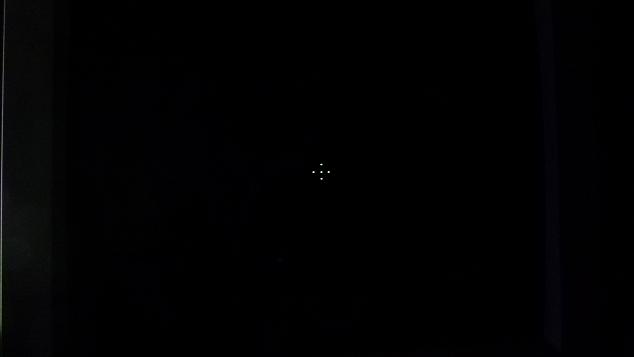

Having some fun with the .b core (RADIUS is $0010):) :
            STA SCRLO
            STA SCRHI
            STBiy SCRLO          ;  STB (SCRLO),Y    PLOT
            LDA SCRHI            ;A ACCUMULATOR, Y COORDINATE
            SBCAopCzp YRADIUS     ;C ACCUMULATOR, Y MATH
            STCzp SCRHI
            STBiy SCRLO          ;PLOT
            ADCAopCzp YRADIUS
            STCzp SCRHI
            STBiy SCRLO          ;PLOT
            STA SCRHI            ;RE-CENTER
            LDDzp SCRLO          ;D ACCUMULATOR, X COORDINATE
            SBCDopEzp XRADIUS     ;E ACCUMULATOR, X MATH
            STEzp SCRLO
            STBiy SCRLO          ;PLOT
            ADCDopEzp XRADIUS
            STEzp SCRLO
            STBiy SCRLO          ;PLOT

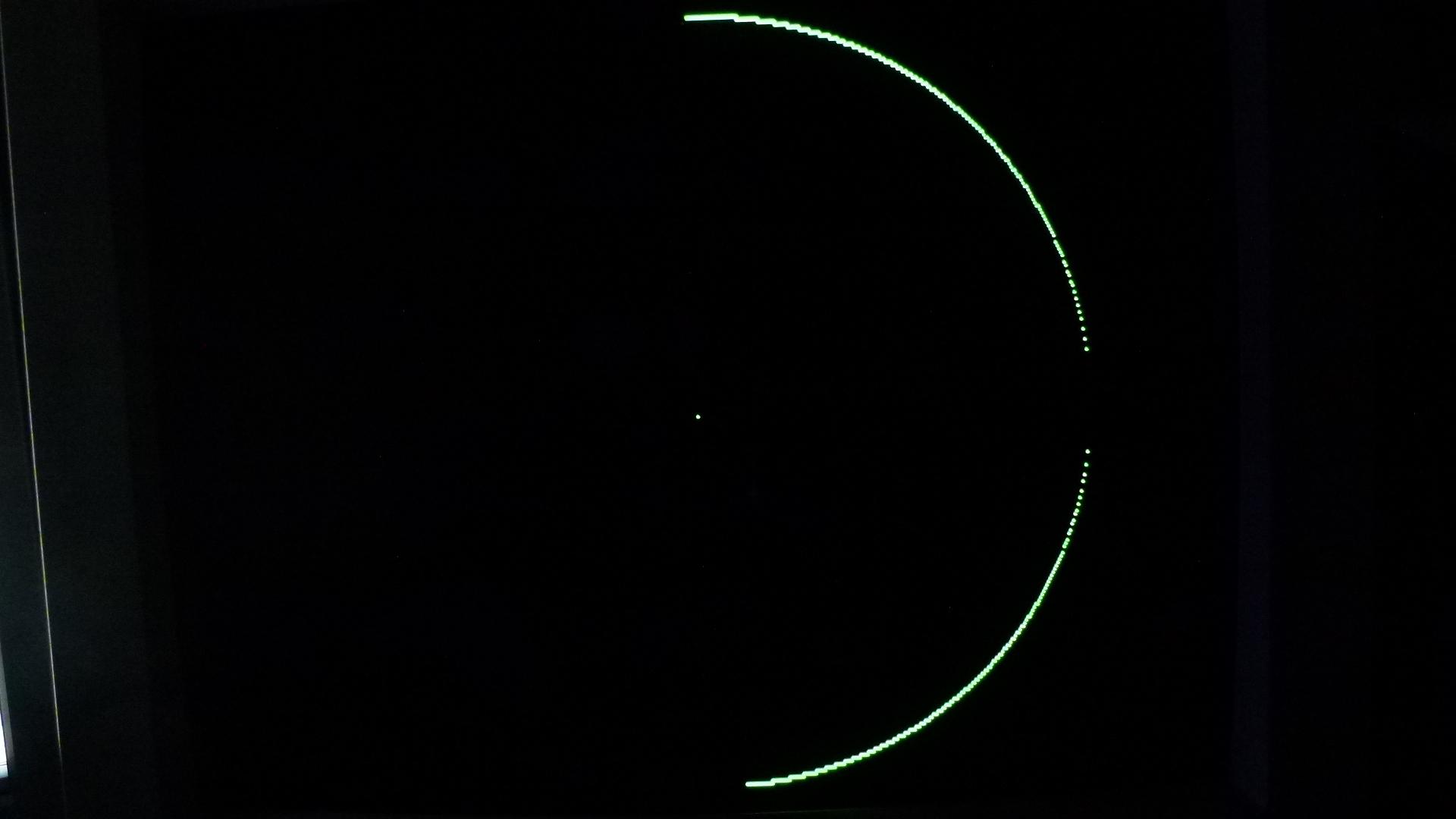

I just now realized (even after I was celebrating! :lol: ) I had to reset the origin after plotting each and every pixel! WOOOO!
EDIT: It's still not 100% because I was expecting a 1/2 circle on the right side only, but I may learn from the mistake!

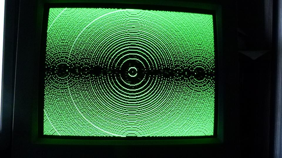

PostPosted: Wed Mar 13, 2013 11:26 pm
This is what I was after, had the loop check (bne) too early. The following is correct together with these 1st 2 subroutines:
START:       LDA #$0000
            LDA #$0001
            STBzp SCRCOL          ;  STB SCRCOL
            JSR CLRSCR
            STBzp PXLCOL         ; B ACCUMULATOR, PIXELCOLOR
            LDA #$0000
            STA Numberh
            CLC
AC          LDA #$0140           ; X CENTER OF 640x480 SCREEN
            STA SCRLO
            LDA #$80F0           ; Y CENTER OF 640x480 SCREEN
            STA SCRHI            ; START @ORIGIN
            STWzp Number         ; This 'Number' is actually X
            JSR Square           ; Now square it!
            LDA #$E100           ; Radius=$F0, R^2=$E100
            SBC Sqr              ; Sqr=Number^2
            STA Numberl          ; This Numberl IS (R^2-X^2)
            JSR SqRoot           ; THIS ROUTINE WILL RETURN Root=SQRT(Numberl)
            TWY
            SBCAopCzp Root       ;C ACCUMULATOR, Y MATH
            STCzp SCRHI
            STBiy SCRLO          ;PLOT 1st Quadrant
            ADCAopCzp Root
            STCzp SCRHI
            STBiy SCRLO          ;PLOT 2nd Quadrant
            INW
            CPWi $00EF           ; CPW #$00EF
            BNE AC
END         JMP END
EDIT: Tightened up the assembly code, same result except for the center pixel.
