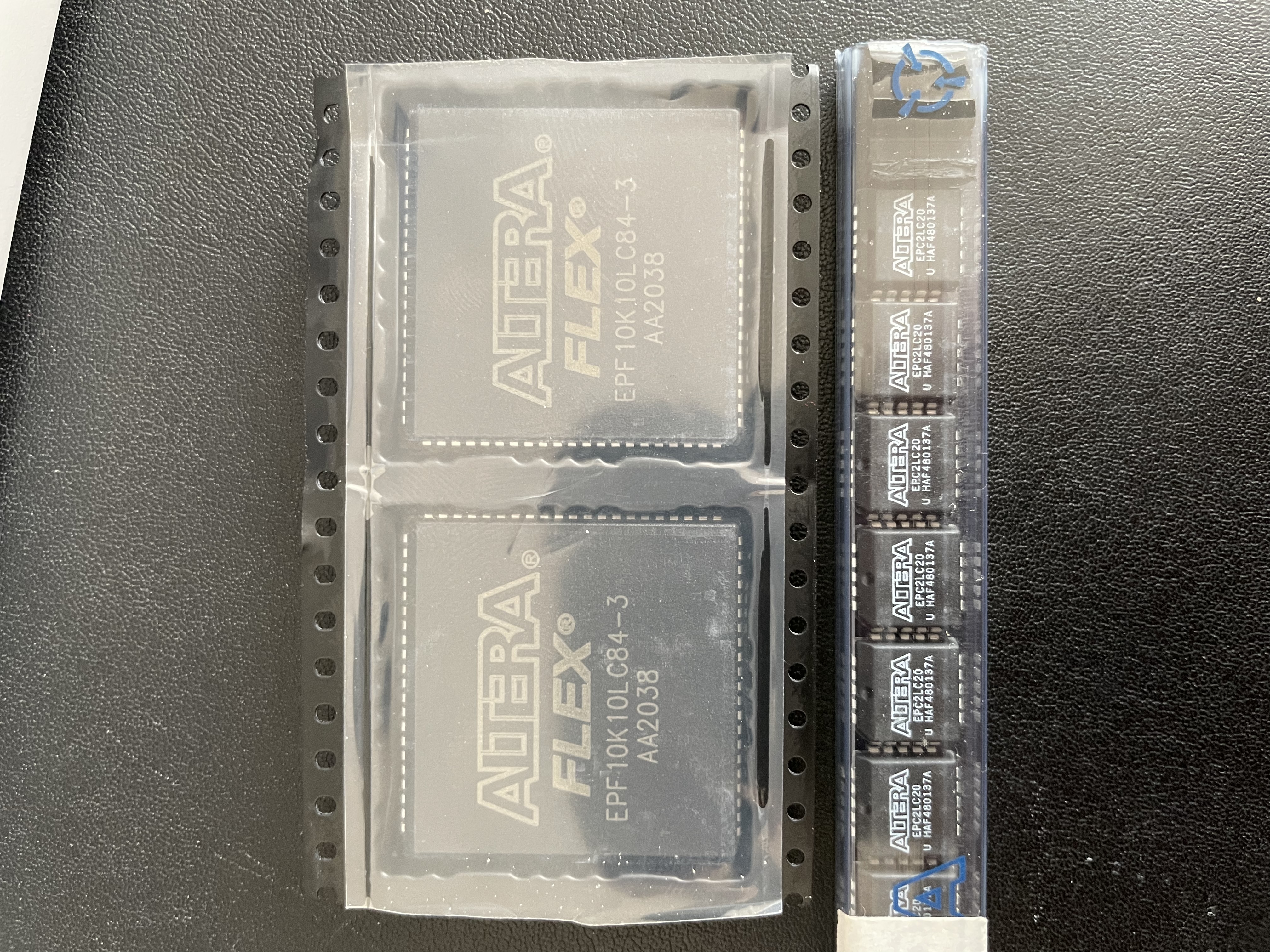

PostPosted: Thu Jun 02, 2022 3:22 pm
Posts: 282
Got myself some EPC2 configuration devices in PLCC-20, and some EPF10k10 in PLCC-84 for ease of integration in my circuits. Too bad the plcc version is the fpga with the least resources, but I appreciate the increase in flexibility compared to soldering a huge qfp, when I'll want to move away from the UP2 board.
