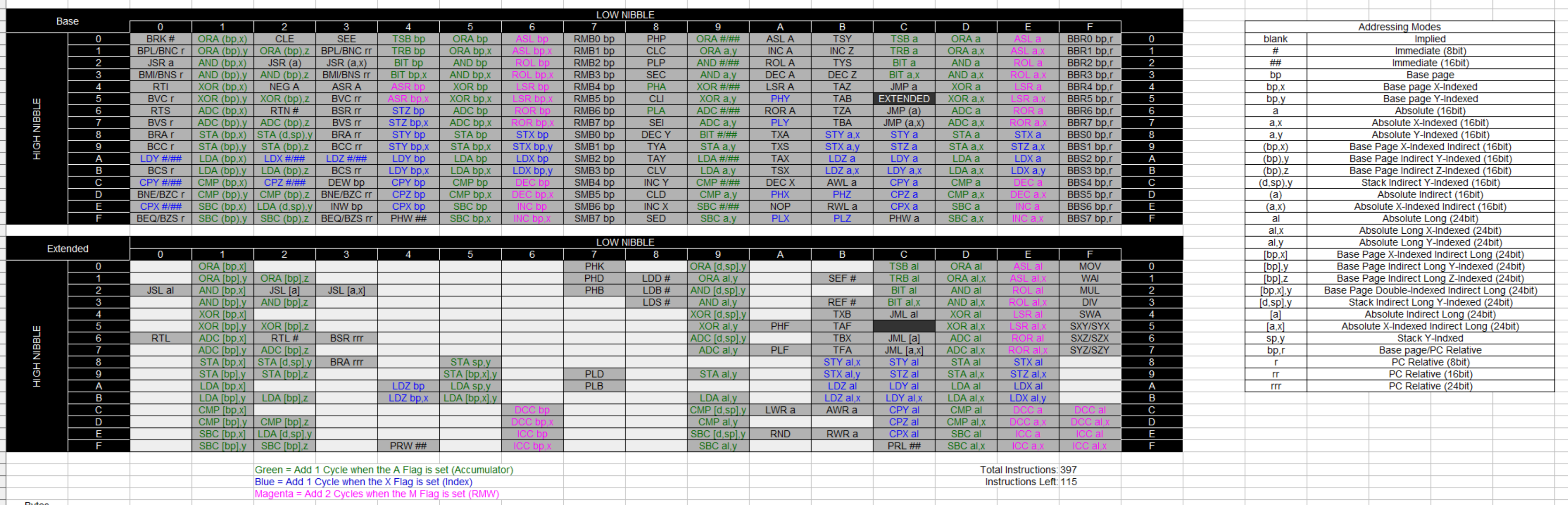

I have risen from the dead to bring you an update!
Well not really dead since i've still been active on the forum. but it has been a very long time since i last worked on this.
After i ran out of things to procrastinate with i pretty much had no choice but to pick up this Project again (not that that is a bad thing).
but hey, while i did procrastinate this i have:
  • Figured out how both CC65 and WDC's C Compiler works
  • Written my own Fixed Point library for CC65 and tested it via Mandelbrot sets and a simple 3D Demo (it runs at 1FPS!)
  • Finally fixed my ATF1508 VGA Controller (which was used for the 3D Demo)
  • and I now got my Drivers Licence
Getting WDC's 816 Compiler to work was very useful for getting to know the 816 better.
i looked at how WDC implements certain things like passing parameters to functions, or handling the width flags.
And while i still don't have an 816 SBC (PCBs are already ordered) i still sat down and ported my custom Serial Library for CC65 (100% Assembly) over to the 816 Compiler.
and damn, i thought it was gonna be hard to work with the width flags (m/x) but after i added the Macro's to easily change them (ACCU_8, INDEX_16, etc) it was actually pretty pleasant to program.
there was still a bit of confusion, like learning the 65C02 for the first time i had to look up a list of instructions or addressing modes every now and then.
but overall it was a lot easier than i expected, and i learned a lot about the 816.
which is very useful for this project and inspired a lot of changes i did.
speaking of which, lets talk about the changes! because of how many there were i pretty much redid the whole thing from scratch.
Mode Flags and Registers
in the previous post i talked about how i didn't want Mode bits and just wanted to use Swap Instructions to allow users to access the high byte of each Index Register...
but after getting to know the 65816 a bit more and coming to enjoy the width flags it has i finally decided to just do the same with my CPU.
but unlike the 65816 there are actually 3 Flags:
  • A - Accumulator Flag, when set the Accumulator is in 16-bit Mode and all related instructions will also change accordingly (LDA, STA, BIT, TSB, TRB, ADC, SBC, etc)
  • X - Index Flag, when set the X/Y/Z Index Registers are in 16-bit Mode and all related instructions will also change accordingly (LD*, ST*, CP*, IN*, etc)
  • M - Memory Flag, when set all Read Modify Write (RMW) Instructions will work on 16-bit words instead of 8-bit ones. (this excludes the existing 16-bit versions, INW, DEW, AWL, AWR, LWR, RWL, RWR)
so, it's exactly as if you took the "m" flag from the 65816 and split it into 2 seperate flags.
another thing i learned from the 816 is that it ignores Page and Bank boundaries for direct page and absolute addressing modes. (unless they are at specific locations and in emulation mode)
i also needed those to wrap when you just use the regular 65C02 and 65CE02 features, but i didn't want to lock anything to bank 0, so instead i just added an extra flag that enables or disables page/bank wrapping for those 2 addressing mode groups.
  • DW - Data Wrap, when set disables Bank wrapping for absolute addressing, and Page wrapping for base page addressing.
the original "W" Flag now called "PW" also still exists and functions the same as before:
  • PW - Program Wrap, when set any PC relative addressing mode can cross Bank boundaries which includes regular Program execution
the Interrupt Mode flag also still exists, but because i needed the space in the FL1 register i removed the built-in priority Interrupt system, so you again only have 1 IRQ like on any existing 65xx CPU.
  • IM - Interrupt Mode, when set the BRK and IRQ Vector are seperated. BRK remains at $00FFFE and IRQ gets relocated to $00FFF6
maybe i'll do something else with this in the future but likely not.
Now, a bit about Registers.
Most stayed the same, but there are some differences.
as expected A, X, Y, and Z are now 16-bits wide, with the High Byte of each of them being constantly cleared when in 8-bit Mode (including the Accumulator)
but the B (Base Page) Register is now also 16-bits wide, with the original B Register being the High Byte of the new one. This means the B Register works exactly like the DP Register in the 816, allowing you to place the Base Page at any address instead of being forced to be page aligned, but it still works exactly like the B Register from the 65CE02 as TAB leaves the low byte uneffected.
the BBR or "Base Page Bank" Register still exists so the Base Page can be placed at any specifc 24-bit Address in Memory similar to the Stack, though unlike the Stack the Base Page can cross Page and Bank boundaries when DW is set to 1.

New/Changed Instructions
Now let's talk about the actual Instructions and what changed about that.
most of the Instruction set remained the same so it's really only smaller additions and some extra addressing modes for existing instructions.
Let's start with the FL1 Register, originally you were only able to modify it via the TAF and TFA instructions (since the idea was that it would be rarely changed), but since it now contains a lot of flags that change very frequently i added a few instructions to make working with it easier.
PHF and PLF, to Push and Pull the FL1 Register to/from the Stack (Interrupts don't push it automatically so you need to do that yourself)
and SEF and REF, which work identically to the SEP/REP Instructions from the 816, except in this case they work on FL1 instead of the P Register.
next up, the "PER" Instruction has been renamed to "PRW" (Push Relative Word) and also got itself a brother, "PRL" (Push Relative Long) which is functionally identical except it pushes a 24-bit Word onto the Stack instead of a 16-bit one. both still use a 16-bit Immediate value. nore that these 2 are effected by the PW Flag because they are PC Relative Addressing Modes.
"RTN#" also gotten itself a brother, "RTL#", as a recap RTN# functions like an RTS that moves the Stack by whatever the unsigned 8-bit Immediate value is and then pulls the Return Address.
RTL# is a bit different, it First pulls the Return Address and then moves the Stack.
i did this because i think it is a lot more useful for HLLs than RTN#. specifically i looked at how WDC's C Compiler deals with Parameters on the Hardware stack. It pushes all parameters and then calls the function, so the Return Address is at the top of the Stack, and since the calle is responsable for cleaning up the stack it copies the Return address deeper into the Stack, and then adjust the SP so that the Return Address is back at the top, and then it can finally Return.
so RTL# just puts all of that work into a single Instruction.
next, "MOV", "MUL", and "DIV"!
i have gone back and forth with these 3 Instructions, so many different ideas and ways to implement them.
in the last reply i said how i wanted MUL and DIV to be slice instructions that only do a single step of the algorithm so that Interrupt latency can be faster.
Now i have gone full circle and they are back to being State Machines that temporarily pause the CPU. I know it will be a pretty bad hit on Interrupt latency, but honestly any other solution would just make the whole operation take longer or add way too much circuit complexity.
so the current timings are: 11 Cycles in 8-bit Mode, and 19 Cycles in 16-bit Mode.
and yes they do in fact work in 16-bit Mode, which should be a huge speed boost compared to software routines.
Important note: even though the results are being stored into A and X, the Instructions only check if A is in 16-bit Mode to do the 16-bit operation. so if A is in 16-bit Mode, and X is in 8-bit Mode you still have to wait the full 19 Cycles but the highest byte of the result will be discarded (effectly only doing 16x8 Multiplication and Division)
now to MOV, because of the extra Register width i was able to get rid of all operands, so it works excluively with the Internal Registers, making the whole thing much faster.
MOV now only takes 4 cycles per Byte (2 cycles to fetch the Prefix and Opcode, 1 cycle to Read a Byte, and 1 cycle to Write a Byte)
the Addresses are formed as followed:
the Low Byte of A is the High Byte of the Source Address, the High Byte of A is the High Byte of the Destination Address.
the whole 16-bit X Register is used for the Middle and Low Byte of the Source Address, and Y for the Destination Address.
the Amount of Bytes + 1 to move is stored in Z.
example:
A = $FF00
X = $8000
Y = $1000
Z = $01FF
This will move a total of 512 Bytes ($01FF + 1) from $008000 to $FF1000
Ok, lets look at Existing Instructions with new Addressing Modes:
I already had Absolute Long version of "ROL" and "ROR", but for completion i also added "ASL" and "LSR".
"LDZ" is for some reason missing Base Page Addressing modes (bp and bp,x), they probably just ran out of Opcode space, so i added those myself.
"TSB", "TRB", and "BIT" also got Absolute Long versions (i wish the 65816 had those)
and even "LDX", "LDY", "LDZ", "STX", "STY", "STZ", "CPX", "CPY", and "CPZ" now got Absolute Long Addressing Modes
but there have also been some removed Instructions:
  • "CBH" and "CHB", which allowed you to convert between BCD and Binary. i just didn't see the point in wasting Space for this, a simple software routine is fast enough.
  • "PHR" and "PLR", which pushed/pulled A, B, X, Y, and Z onto/from the stack. with the 16-bit Registers my Control Unit literally cannot move that much data in a single instruction and it's not worth either.
  • "PHS" and "PLS", these allowed you to push/pull the Stack bank Register to/from the... Stack... which makes little sense to me so i removed them.
  • "STP", my CPU has no power down mode so this is the same a branch that points to itself.
[/list]
That should be everything for far!
I'm still in the process of testing all Instructions in Logisim, once that is done i can upload the Logisim file and the new documentation to Github and then start working on the Digital version so i can then throw it on an FPGA.
Here the current list of all Instructions and Addressing Modes, i really hope there won't be any more massive changes so i can finally call this projected "finished enough"
