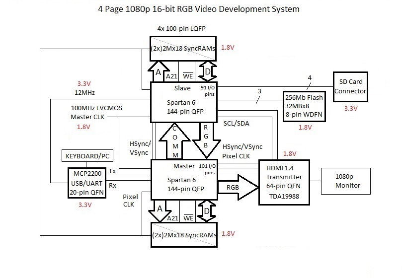

ElEctric_EyE wrote:
...I'm going to run a project through ISE and experiment with the constraints file in order to see if it generates any errors...
In the constraints file of the last Spartan 6 project I did, I changed just a few pins of the 16-bit RGB in bus to 2.5V from 3.3V (I did use 3.3V LVCMOS, not 3.3V LVTTL) and it just gave warnings regarding delays. So I would expect this, at least no errors. Sorry, my brain is thawing!
Another experiment where I changed the entire RGB In databus, including the H/VSync and Pixel clocks, to LVCMOS 2.5V, while everything else was LVCMOS 3.3V, it passes with no warnings!
Good to go. I must now just figure out these multi-function pins. Which to use, which not to use.

/A21 isn't mentioned in the "General Layout" ?
PostPosted: Sun Sep 02, 2018 8:17 pm
Sorry, it's 'implied'. Those SyncRAMs have 2 active high enables and 1 active low enable per IC. In the Block Diagram I have a grey line designating/implying 2x 2Mx18 SyncRAMs. Sorry for that laziness on my part ;)
PostPosted: Mon Sep 03, 2018 12:53 am
Posts: 660
Location: North-Germany
Well, then this looks fine :)
The only remaining question is, whether you can use a keyboard attached to the MCP2200 or a PC only. I think a keyboard requires a "USB master" (what a PC usually is) and to me the MCP appears to be a slave only device.
Regards,
Arne
PostPosted: Mon Sep 03, 2018 2:15 am
Regards,
Arne
The MCP2200 will spit out Rx data from a PC or a keyboard input via USB connection. I never did try to send commands to the keyboard or PC though. Hmmm, that may save me another pin right there. No need for Tx in my case...

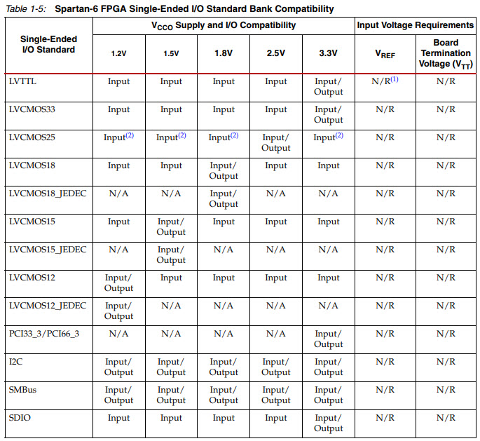

OK, I've finally found info regarding the voltage supplies needed for the Spartan 6. It's just a bit complicated when using multiple I/O voltages but not so much when you think that we're dealing with CMOS here.
I believe everything should work fine on the Master. I think I'm going with a 148.5MHz 1.8V CMOS SMD oscillator. That way I can save a PLL inside the FPGA and also abide by the 1.8V standard without worries, especially since it's the main clock. The only other pin to worry about, on the Master S6, is the 3.3V input from the USB to UART Rx pin. I've deleted the Tx pin. According to Table 1.5 Xilinx UG381 on Pg. 39, which I've posted below, inputs can be higher than the voltage present on the VCCO pins.
So, the VCCINT pins will be 1.2V, the VCCAUX pins will be 3.3V and the VCCO pins will be 1.8V on both S6's. So this leaves an issue with the Slave S6 and the SD Card interface since that is 3.3V IO. Haven't figured that one out yet, except maybe some simple voltage translators on the outputs of the Slave S6?
The SyncRAMs are current hogs at almost 300mA per IC. I've got my eye on a Analog Devices 1.8V 2A regulator, in a nice small 3mmx3mm WDFN package, that should take care of them. Then multiple/individual 1A reg's, in SOT223 from the MCP1826 Family, that will power the FLASH, HDMI and S6's. They're all nice and small.
I've started a parts list in the head post on this thread although it's already old as I'm typing this. Some parts have gone up in price, especially Xilinx FPGA PROMs. They were $4US 4 years ago! I might experiment using cheaper SPI FLASH.
Back to the datasheets! There's so many pages per manual. Took me over an hour to find that one table.
EDIT (9/5/2018): VCCAUX is 3.3V not 2.5V. Not a big deal...

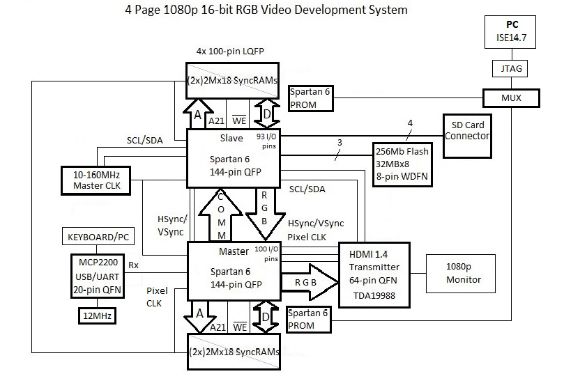

3 more developments regarding the block diagram evolution:
1) MUXing the JTAG programming of the Master/Slave Spartan6 PROMs from the PC, ISE14.7. Done this before, but this time will be manually switched.
2) MCP2200 USB to UART is Rx only and has it's own 3.3V 12MHz Osc.
3) The 1.8V CMOS Master CLK Oscillator is programmable from 10-160MHz but boots up @148.5MHz.
PostPosted: Wed Sep 05, 2018 9:58 am
The SD Card part is back in business with some really nice looking logic level translators made by TI.
Lucky for me the 1.8V <-> 3.3V has the highest throughput @500Mb/sec. Not sure how fast I'll need yet, but the faster the better. I'll be aiming for the SPI bus mode for simplicity.
