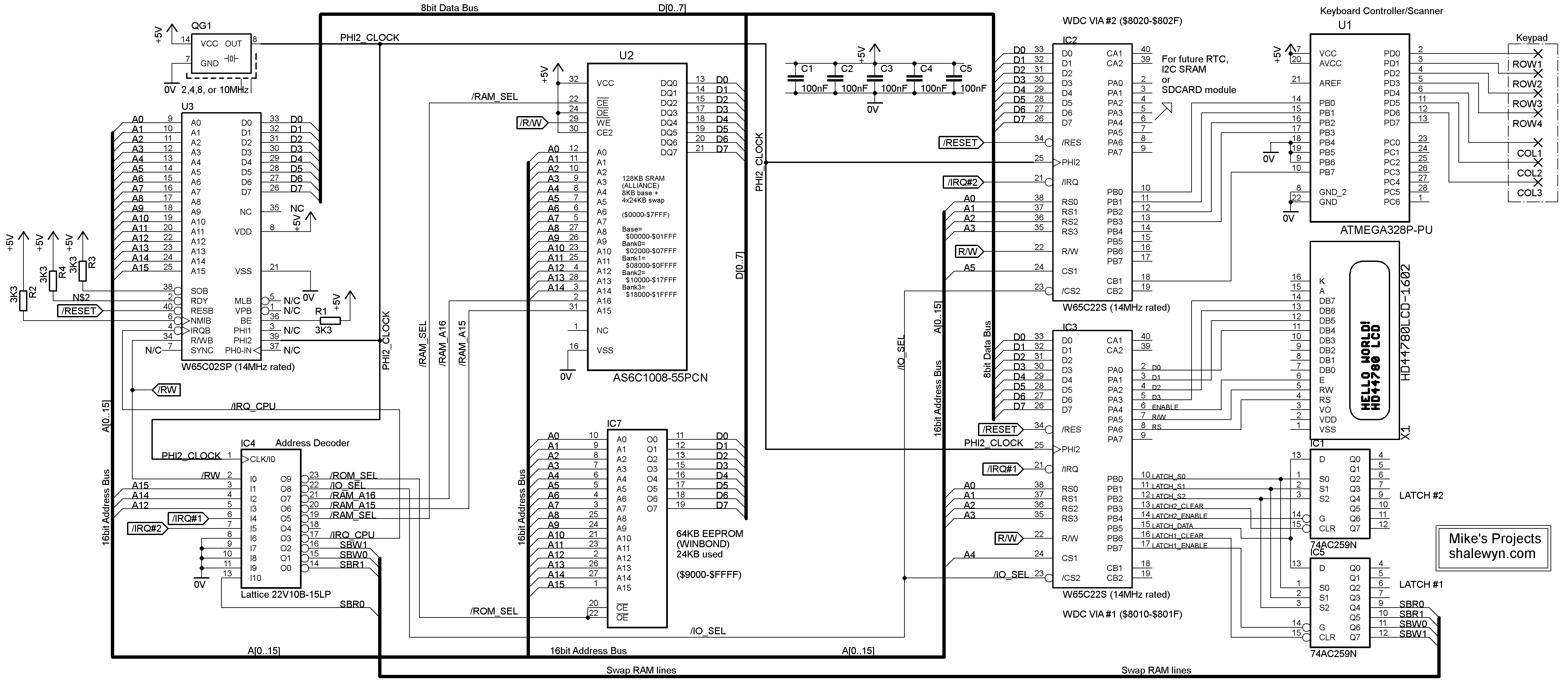

This is my latest circuit digram with the address decode in the bottom left and the latches in the bottom right.
[EDIT] Or do you mean the logic in the GAL? If so then it should have a propagation of 15ns or less according to the datasheet.

I'm referring to the prop time through the 65C22 added to the time required for the '259 to react to whatever comes out of the 65C22. Any GAL these days will be more than fast enough.

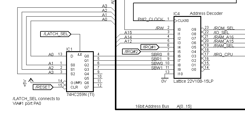

any reason why you connect the '259 to the VIA port, it's actually a waste of VIA pins in my opinion. I always use them as they have been used in the Apple II computer. You need a /SEL which is qualified with PHI2 and covers a range of 16 addresses. Then I connect D -> A0, S0 ->A1, S1 ->A2 and S2 -> A3. /CLR is connected to /RES so you have a clear initial state. Then a simple LDA instruction can throw any of the flip-flop in the '259.

It's mostly because I want to keep things off the 6502 address and data buses as much as possible. That way if I really need to put something on them then I don't have to worry about having already overloaded them.
But going with your idea, is this what you're suggesting? The only part I'm a bit uncertain of is where /SEL comes from. I assume a VIA pin as in my circuit diagram (please ignore it saying PA0- it should say PB0)?
If so, then surely then you have a disjunction between the right address being on the address bus and /SEL (/LE) going low.
[EDIT] ...or would use use the decoder to intercept a certain range (as small as possible) and then enable the latch select (/LE) pin? I'd have to introduce mode address pins if I did that to avoid wasting massive amounts of address space.

yes except something is odd with our 74HC259, pin 14 is the latch enable and should be the /LATCH_SEL signal and not +5V, the LATCH_SEL has no pin number. Have a look at it. Of course I would have the GAL decode a small (minimum 16-byte) range and only this range enables LE of the '259. I would add a 74ACT138 between the IO_SEL pin and the IO devices.
As for the load, a 74HCT259 is neglectable. I have 65C816 working with about 15 CMOS devices connected to the address bus without any problem.

Sorry, that's my fault. I used a generic '259 device from Eagle CADs library and added on the /LE (/LATCH_SEL) manually.
I'll see if I can get a proper TI one.
My concern about adding the '259 in the way that you're suggesting is that I will have to either sacrifice a large amount of address space or lose more pins on the GAL to decode a 16 byte range. I think that would mean I would have to decode A15-A4 (12 pins worth) as opposed to A15-A12 (4 pins) that I'm using at the moment.
With regard to the I/O; I'm using one address decode pin out of the GAL which connects to /CS2 of all of the VIA's and then A4 to CS1 of VIA#1 and A5 to CS1 of VIA#2.

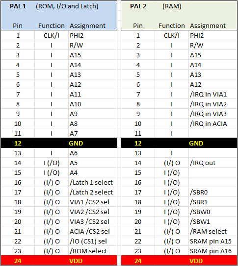

Ok you've both convinced me :). I'm going by what I've read elsewhere that you shouldn't over burden the buses - and I have no experience as to when this might happen.
What about having a couple of GALs in parallel? One intercepts the I/O and ROM and latch, the other does the RAM?
At least until I look at using PLCCs.
I.e.:
Or perhaps:
