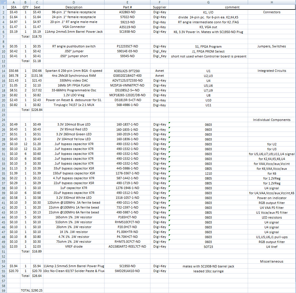

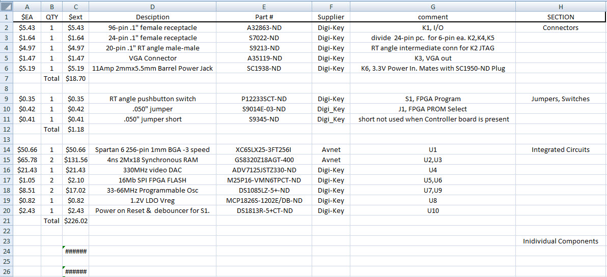

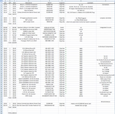

Parts list started. Discrete components have yet to be added!
Was a challenge to find the 330MHz videoDAC part. :D

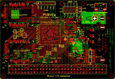

ElEctric_EyE wrote:
Garth, I interpreted your 'jagged' comment to mean diagonal so I tried to come up with a better layout:
I'm not sure what you mean by 'jagged' unless you're referring to the term "chainsaw" which just means there are cuts (regardless of shape) in what otherwise looks like a plane layer, in this case a power plane. As long as this layer doesn't get between your signal traces and the continuous ground plane, you'll be fine. Remember that any given signal trace's return current through the plane tries to run directly under that trace, taking the shape of the trace, but that if there's a cut in the trace, the return current has to take a different path and you end up with what amounts to an inductor or a stub depending on the length and width of the cut, and it degrades signal integrity. Actually, sometimes a cut in the plane, running perpendicular to the trace, is intentionally used to print an antenna on the board, something you don't want in this case. I really have no way of evaluating the effects for the particular application, so, since you're dealing with sub-nanosecond rise times for the fast, hi-res video stuff, I just shoot for next best, which we give the nebulous term "good engineering practice."

PostPosted: Fri Jan 02, 2015 11:32 pm

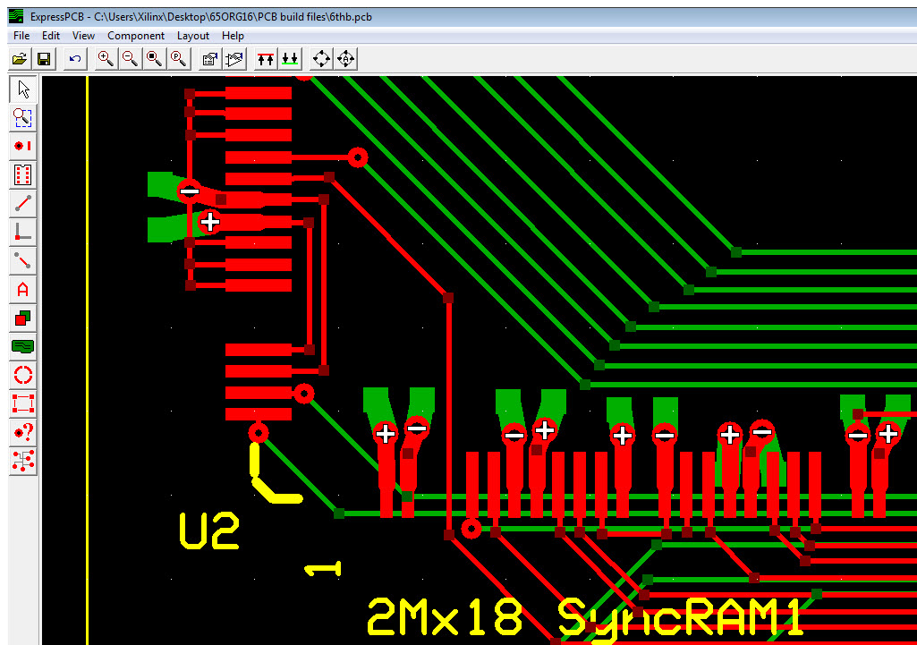

Back on Dec 13 when I posted a pic of the PCB layout, a data bus trace was left unconnected. That was the 2nd iteration of the design. I realized this error at the final 6th iteration! Quite a PITA after the board fills up and things get tight after 2 more weeks of development. Errors like this make it a real challenge to re-route so many pad-pad traces! But I did it with some sort of inner pleasure. :twisted: I've got my finger on the trigger now for EPCB production. :)

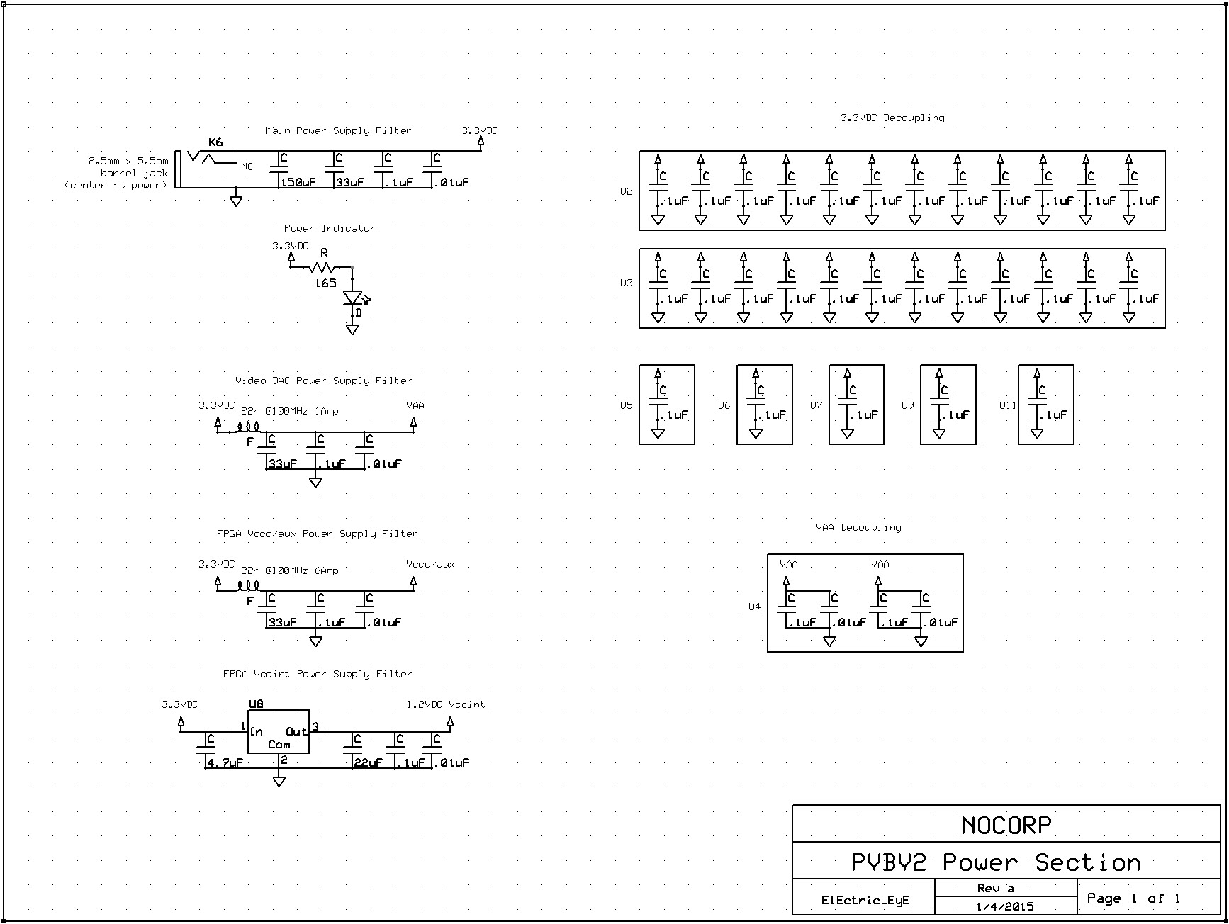

I decided to do a few schematics for a few sections of the board.
The Power Supply Section is documented, that pic is next. I'm currently working on the FPGA SPI PROMs next. Finally, the Programmable Oscillator Section. A Block diagram will finish off the visual description of this design.
Comments/critiques welcome as always! You all have been a great help spotting bungling errors.
BOM is complete:

Power Supply Section:

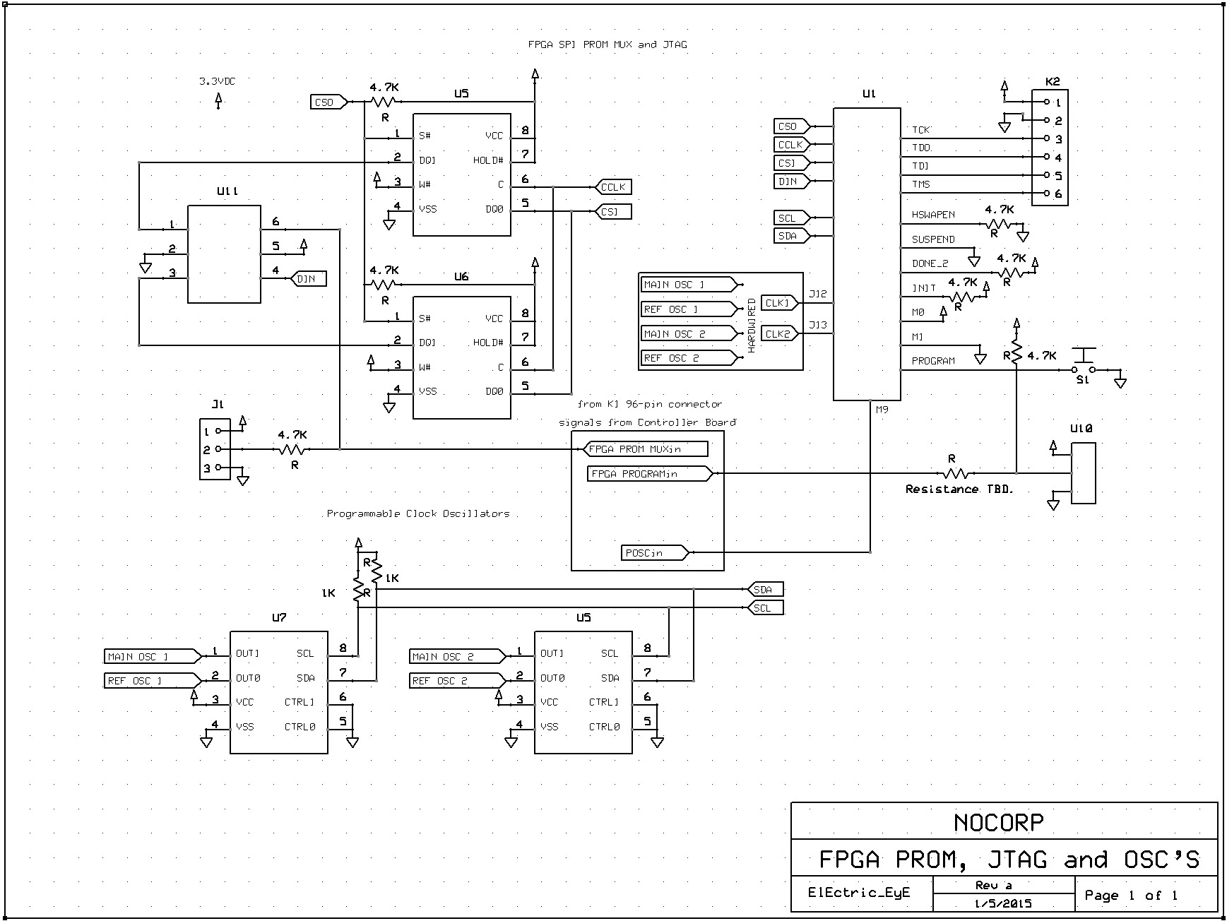

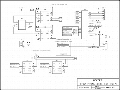

FPGA SPI PROM MUX, JTAG and Programmable Oscillators. The DS1085L-5 programmable oscillators are programmed by an I2C bus, which (I almost forgot) uses external pull up resistors. The Spartan 6 user guide UG381, pg.35 spec's that lines with IOSTANDARD I2C are to be pulled to 3.3V through 1K resistors. I'll have to add these 2 resistors to the BOM and update the constraints file.
Also, there is a potential conflict if a user decides to push the Program at the same time an incoming FPGA Program signal is present from the Controller Board. A resistor is there with a TDB value to save an FPGA output pin from damage. Also, there is the fact that when U11 (DS1813) senses a low input (from either the switch or control signal), it holds the line low for 150ms.

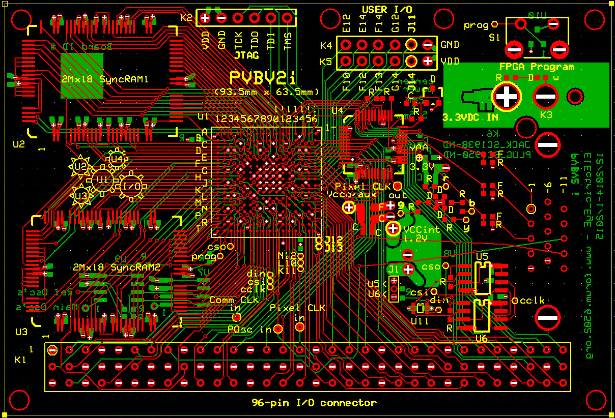

I'm breaking some PCB layout rules, which I've done before apparently successfully.
The last modification I went with was to use .5mm (.020") BGA pads instead of the recommended .4mm (.016") BGA pads.
My bypass caps are totally out of spec according to Xilinx UG393.
We shall see, *sigh*.
This is what happens in a design when there's a limited number of layers and board space!
File comment: PVBV2h

I already see I could have shortened the HSYNC & VSYNC traces from the VGA connector to the FPGA, sh*t!
Already working on version i, just a few changes. It shouldn't hamper operation. I'll wait for further issues to develop before ordering PVBV2i

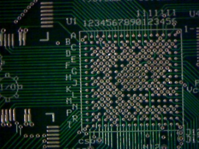

Focusing in on the 16x16 BGA pads...
Solder paste?! Are you Fin kidding me? Not meant for 1mm BGA pads with vias in the middle.

Did you get a stencil with your boards? Some board shops provide them free if there are SMT pads on the board.

Oh dear - is it normal to cover the via ring with soldermask?
PostPosted: Tue Jan 13, 2015 12:14 pm
This is going to cost me big time, at least I didn't bother to solder anything yet. Good eye Ed.
This topic came up before too, but I don't think I had fully realized... I don't feel too well.
I emailed EPCB support to see if it is at all possible to choose soldermask over a via.
