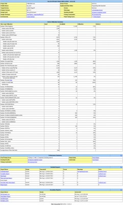

I'll continue developing on the four populated boards I currently have, but I've been wanting to delve into the BGA world of Xilinx FPGAs and design a new more capable board. Earlier I've had my eye on a larger Spartan 6 1mm 256-pin BGA. I forget the price, something like $50+.
But recently I've seen the 28nm 256-pin BGA Xilinx Artix FPGA for sale for $35 for the slowest version: XC7A35T-1FTG256C. This may be the path I choose, but I do not see it available in ISE. Will do more research... New thread here.
BTW, here are the resources currently used (from that thread). The project has almost Max'd this LX9:

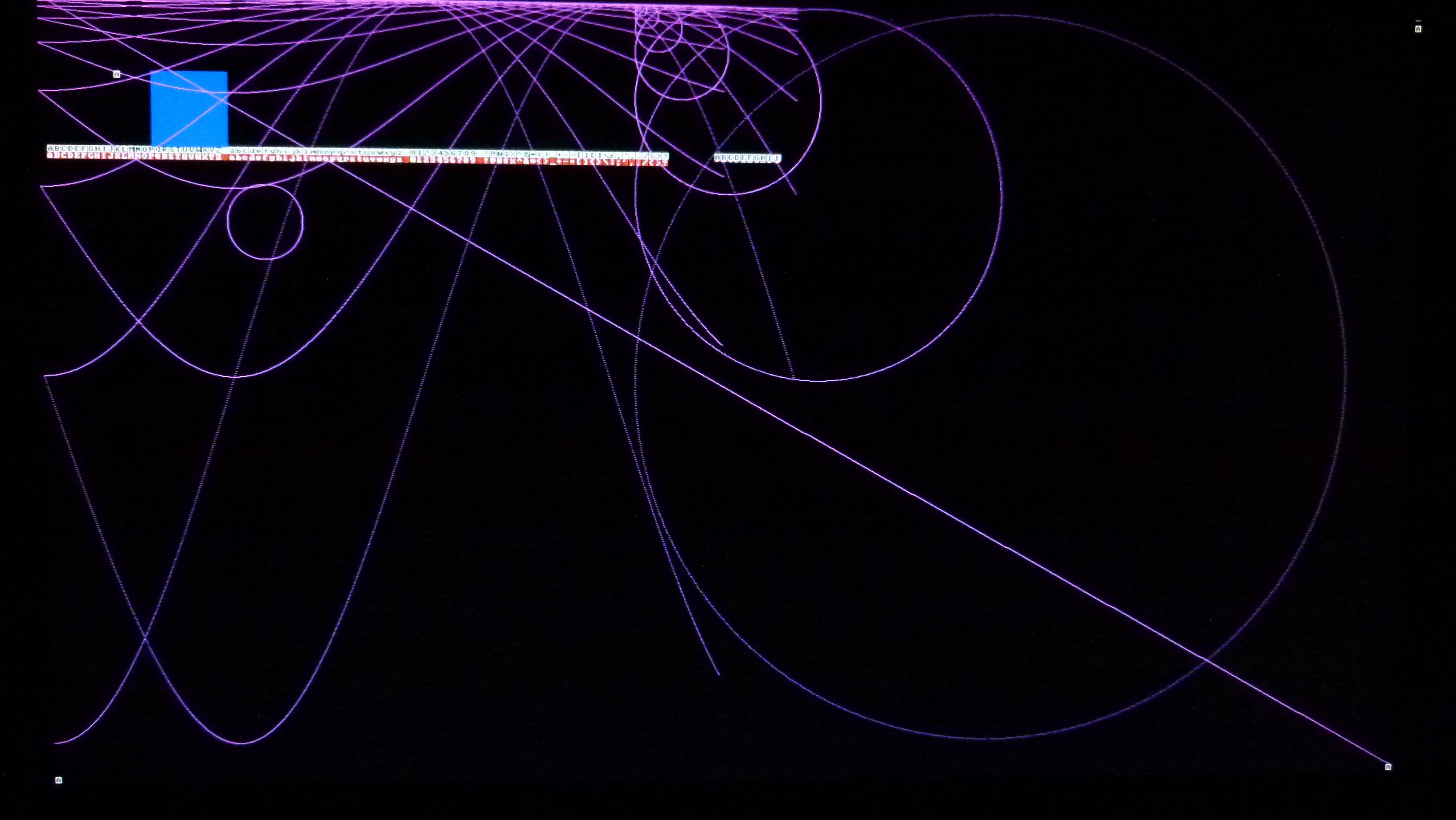

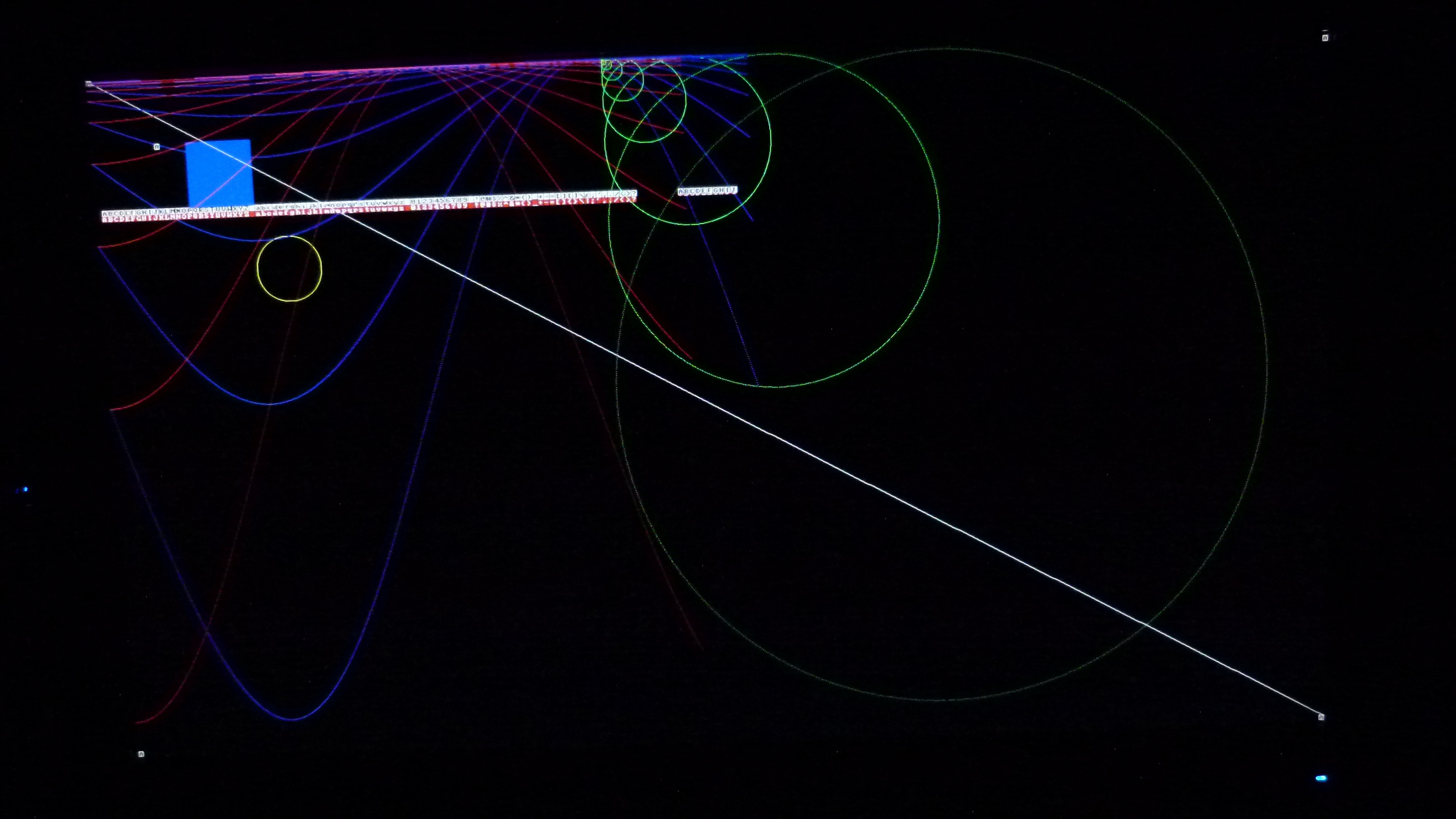

Resizing a circle/ellipse using the sin/cos LUT's only work when shifting values to the right, which is a divide by 2, 4, 8 etc. This is unacceptable because only ~10 sizes of circles are realizeable for 10 bits in 1920x1080 resolution. Duh, right?
So, after much time and effort, the sin/cos LUT's are not going to work for the limited BRAM space inside the FPGA.
I had early success with the hardware plotting of a circle using 8 octants with Bresenham circle in hardware (ie Verilog). Plotting directly to the video SyncRAM in (X,Y) Cartesian coordinates was easy with the algorithm I adapted from Wikipedia, but this was not sending coordinates to the BRAMs. Looking forward, adapting the state machine where it used to plot 8 octants for immediate plotting into linear addresses for storage is going to be a challenge.
Tomorrow I'll post a 1920x1080 static pic (and more explanation)of the 10 sin waves in blue, cosine waves in red and circles in green. Right now most is in purple and I've got no time left tonight.

Colors are correct now.

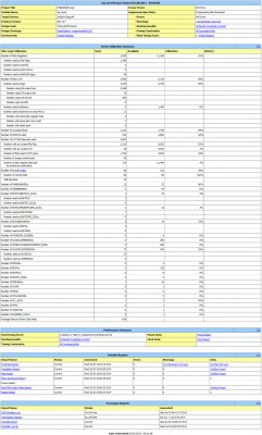

Looks like the ISE 14.7 has offloaded some work to the DSP48A1 tiles:
