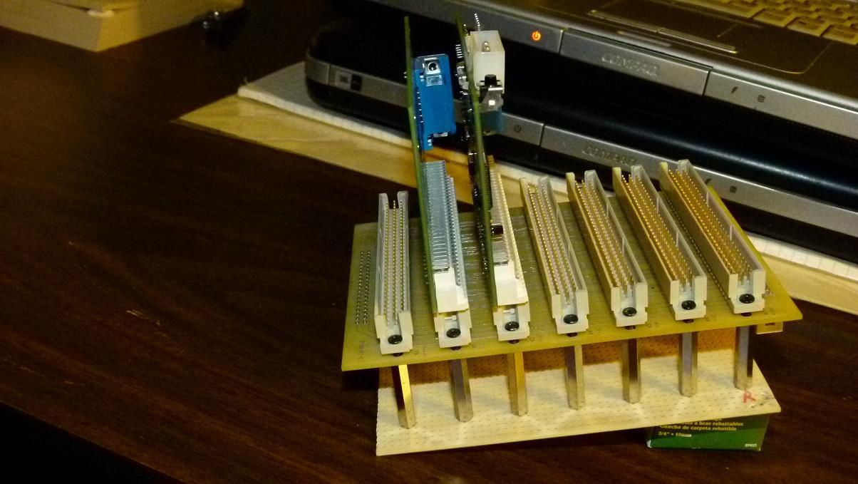

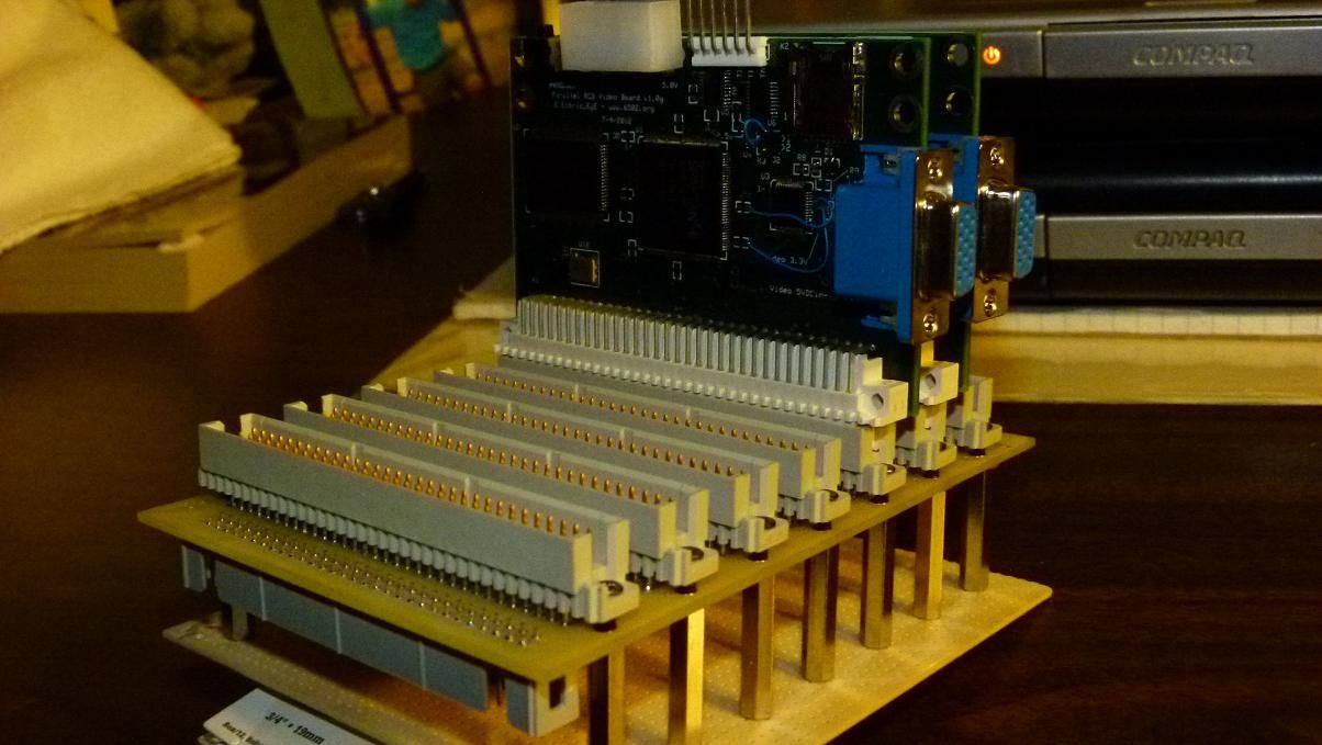

I just received the boards. Tomorrow, I will solder in the receptacles and put together 1 PVB bypass board. Will document how to do this on that thread.
PostPosted: Wed Nov 07, 2012 2:33 pm
I'm done soldering today. 800+ holes. Will do another PVB board next week.
More form than function at this point...
PostPosted: Wed Nov 07, 2012 4:16 pm
Posts: 8507
Sounds like an excuse to devise a wave-soldering station! :D Them there's a lot of holes.
