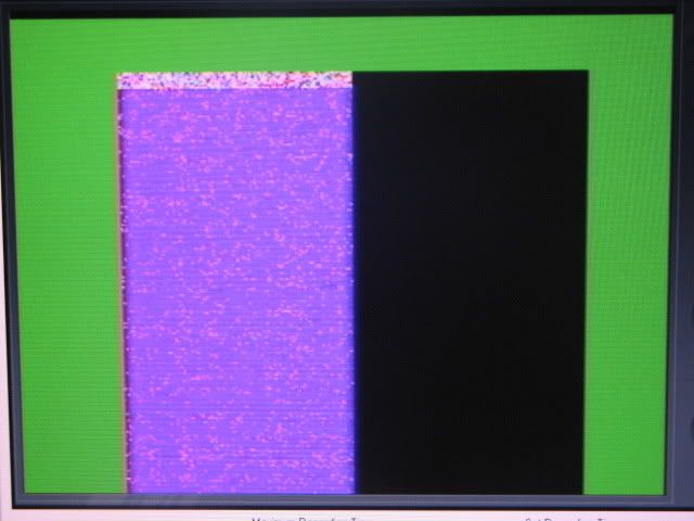

Ok, I suspected that as I didn't see any obvious registers to program. So anyway, when I disabled colorbar generation I have the beginning of graphics!!!! This is awesome when things come together so quickly. It's not perfect but most definately something to work with. I see the green border. The right half of the screen is black. Most of the left side is purple shades of pixels and on the very top, maybe 16 pixels tall, looks like regular random colored pixels one would expect. Working on getting a pic to post...
EDIT: Here it is. Bottom border is missing...

This is looking like something! So, is the SDRAM involved at this point?

I suspect the right half of the screen is black, because the bitmap is only 256 pixels wide. In your schematic you didn't hook up the 'hstretch' input to the cs4954.v module. If you tie that input to '1', the bitmap will be stretch horizontally, and it should fill the entire screen.
As far as the missing bottom, that's probably because NTSC has fewer scanlines than PAL. You should be able to fix that by adjust 'height' in the cs4954.v module. Similarly, you can adjust 'top' and 'left' to adjust the borders, so you can center the active screen on your TV/monitor.
After that, you should try to write to SDRAM from the CPU, and see if you can write on the screen.
It certainly looks like the data is coming from SDRAM. If you compare the image to my first bitmap, it looks quite similar.
