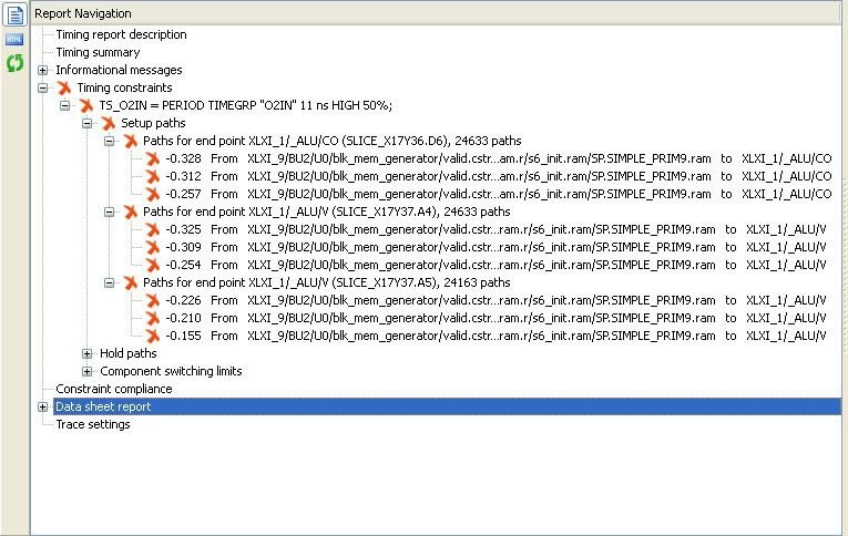

Interesting, I set up a top level constraint for the O2IN clock at 12ns, and it passed! Now it says best achievable case is 11.68ns. Will try 11ns next...

Is this something to be concerned about? Been giving me the warning since making the adjustment to the Z flag.
WARNING:Xst:2677 - Node <XLXI_1/_ALU/Z> of sequential type is unconnected in block <top_level>.
It did fail @11ns. You mean this?

If you click on the paths, you get more detailed information.
But 12 ns is pretty good. With the 18 ns, I thought something may be wrong, but 12 ns is fine. That's going to be pretty much impossible to improve.
And, yeah, in order to see the top speed, you'll have to play with the constraints. If you put the constraint at 20 ns, and the tools reach 19.9, they're not going to try any harder, so you'll never see the top speed.
