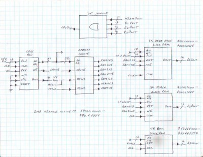

PostPosted: Wed Jan 16, 2013 5:40 pm
So my first step was to do a block diagram with all signals and signal directions present. I tried to just start typing in the Verilog for the top-level interconnects, but found there were just too many signals to lat it all out from memory.
The idea for the 'initial' operation is for the CPU to be able to read and write to the external synchronous RAM during the horizontal and vertical retrace periods. All the square blocks will be the individual Verilog modules, although I may have to add another module to accommodate the bidirectional data bus of the SRAM. Also, I expect the timing will be off as I use a common clock for everything, with no provisions for the delay of the FPGA and SRAM, but I would expect to see some recognizable activity if the .b core software is actually running. I will just try to clear the video RAM for the first test.
This part of the project is basically a compilation of everything I've learned from previous FPGA projects using 6502 soft cores with blockRAM together with what I've most recently learned about video using the parallel video boards.

PostPosted: Thu Jan 24, 2013 1:14 am
I've added the 2 blockRAMs for the .b core zero-page and stack, but not the ROM yet. R1 and R2 are the FPGA blockRAM databus outputs. Also, that ORs module in the above pic turned out to be an extremely simple
Assign cpuDI = ( R1Dout | R2Dout | VramDout )
line of code inside the top_level module, so a separate ORs module wasn't even needed. This is what attracts me to Verilog; after building the equivalent structure with schematic entry ORing 4 16-bit databuses Inputs & 16 Outputs was a PITA. Now, using Verilog, it takes 1 simple line of code! :lol:
So, I've yet to add the ROM and address decoding module and to finish the SRAMif module before some real world testing can begin. I plan on 1024x768 with a 70MHz system clock.
Also, screw that part of trying to write to the video RAM when HSYNC & VSYNC were inactive, only because the cpu would have to be interrupted or it would have to read some bits from a port when HSYNC or VSYNC was inactive. At this point the 'snow effect' should be acceptable before transitioning to a FIFO buffer. I will need help with this though!
PostPosted: Sat Jan 26, 2013 4:17 am
Posts: 760
Location: Huntsville, AL
Most FPGAs no longer support internal tri-state busses. There are some respected sources that recommend against using internal tri-state buffers. I, on the other hand, believe in letting the tools transform internal tri-state busses (in FPGAs) into the appropriate implementation. I find it error prone and tedious to specify each and every bus, and to explicitly define the required multiplexers.
EEyE's block diagram/schematic in an earlier post is an example of the structure I try to avoid. I am not saying it is incorrect, or otherwise a bad thing to do. I am simply saying, that I try to avoid having to explicitly manage the buses and the required bus multiplexers as shown in EEyE's block diagram/schematic.
To accomplish this I generally create an internal "tri-state" bus, which can't be implemented in the FPGA. This "tri-state" bus allows me to create a single common port on all modules that will connect to the "bus". In this manner, the synthesizer is implicitly increasing or decreasing the size of the OR gate that combines all of the buses together as EEyE shows in his block diagram/schematic. Because the FPGA itself has no way of implementing a "tri-state" bus, the synthesizer has to transform the Verilog "tri-state" bus into a multiplexer of some sort and use point to point connections to tie everything together.
One way the multiplexer can be constructed is illustrated by EEyE's block diagram/schematic: a module with an enable and an OR gate to collect all of the connections together. An AND gate, when not enabled, outputs a logic 0, and an OR gate only outputs a logic 0 when all of its inputs are 0. Thus, in EEyE's circuit, the three memories are mutually exclusively selected. If unselected, their outputs are forced to logic 0. The OR gate samples each of the memories' output data. Since only one is selected at a time, there is no problem correctly resolving the logic level of the output of the enabled memory.
An alternative is to define a single bus. Let's name it something like EEyE has named the output of the OR gate, CPU_DI. At each memory, I would connect its output data to CPU_DI using a tri-state construction:

In this example, the OR gate is implicitly created by the synthesizer.
This approach may or may not help, but it is the technique that I use when I want to connect a varying number of modules/components together. The approach is (1) automatically transformed into cascaded AND-OR gates as discussed above, (2) automatically accounts for all of connections, and (3) keeps me from having to define the multiplexer and/or the variable width OR manually.
