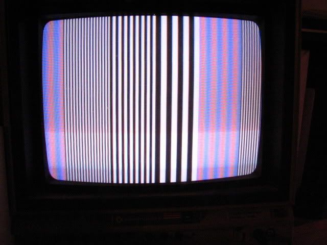

It works! Sorry about the delay, had to run some errands then solder in the components...
 Post subject:
PostPosted: Wed Mar 14, 2012 6:50 pm
Cool. Did you try to use the '+' and '-' on the USB port to move the picture sideways ? There should be a blue area on the left, and I'm curious if the color turned out okay.
Do the fine vertical lines really turn purple/blue on the screen, or is that an aliasing effect of the camera ?

PostPosted: Wed Mar 14, 2012 7:01 pm
I just tested this now after setting the baudrate to 115200. It scrolls to the right with the '+' key depressed revealing a blue screen sliding in from the left of the stripe pattern. And the pattern scrolls to the left with the '-' key depressed.
That's a real purple/bluish "meshed" type pattern.

PostPosted: Wed Mar 14, 2012 7:24 pm
This is what I get:
I suppose your C-64 monitor has a few years on my TV set. Anyway, those fine bars have 360 pixel resolution, and the CS4954 can even go double that. It would take a fairly modern TV set to discern those pixels !
By the way, I've ordered a cheap USB composite video grabber. I should receive it this week. That way, I can test the image by just capturing it on my PC, and playing it in a small window on the desktop, rather than on a bulky TV set on my desk.
