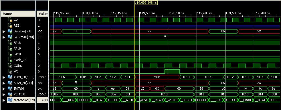

Oh nice! Here (below) is where the problem is occurring. During the second INC $C004, FA18 should go low, and FA19 should go high. It looks like the address isn't decoding properly? Sorta doesn't make sense because it works the first time. Let me explain my signals.
O2 is before the DCM. Constrained at 20.58ns.
O2Int is after the DCM. For simulation purposes, I kept it at a 4:5 ratio, i.e. 38.8MHz. It is present to the CPU, internal synchronous RAM, and internal synchronous ROM.
WE is from the 6502 core.
XLXN_20[15:0] is the address bus Net present to everything internally.
XLXN_30[7:0] is the DataOut from the 6502 core. It goes to the internal RAM, ROM, the FA17to10 FD8CE, the FA25to18 FD8CE (lower 3 bits used). and then finally out to the world through an OBUF8. After which it becomes Databus[7:0].
I initially posted today because I was worried I may have hit that instance (or something similar) in which I would have to use a DDR flip flop as mentioned on your homepage Arlet. But I see now, that is only write/write situation, not applicable here.
Anyway, thanks for helping me along!
In due time I will figure it out. 8)

Maybe I'm not understanding the schematics properly, but it looks like your $C004 location is write-only, so the INC instruction wouldn't work.
When reading from memory, the result should be provided on the DI bus 1 cycle after the RE is asserted. That's how the block RAMs do it, and that's what you should mimic if you want to have your own readable memory locations.

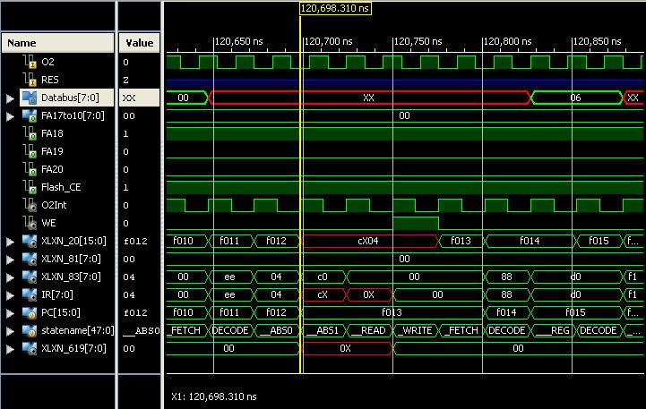

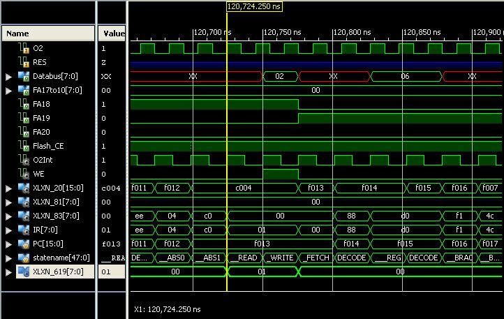

That was my problem!
Adding a D flip-flop to delay the RE by one cycle fixed it.
Thanks for pointing me in the right direction Arlet. Saved me at least a week, maybe 2!
1 thing I forgot to mention, hence this edit, is that XLXN_619[7:0] is the bus from the Flash MSB output ($C004) after the FD8CE (where the upper address is latched), after the Flash MUX's (which only pass data when RE is active), but before the OR gates to the 6502 DI. Sorry to try to explain schematics, but it isn't complete yet.
Before (incorrect):
After:
Now I'll use this technique for all the other RE's too, but I'll have to wait till "work" is over, before I head home and try it out!
EDIT: Explained XLXN_619[7:0] in the pics
