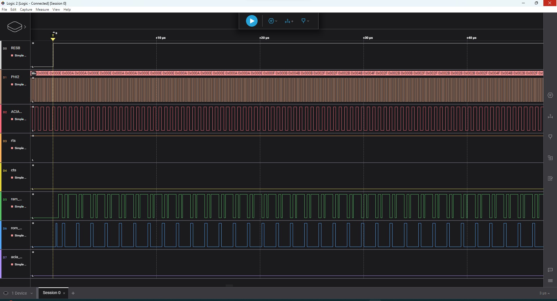

Jmstein7 wrote:
Curious to know what your thoughts are.
Something is stopping the ACIA from sending.
Where does CTSB come from?
It looks like it's driven from this m_rtsn in module:
https://github.com/jmstein7/65C816_to_F ... inx_UART.v
But there is nothing actually driving m_rtsn.
Dave
Dave
RTS and CTS are "short circuited" as if they were physically jumpered together:
Xilinx_UART UART_A(
  .m_rxd(uart_rx), // Serial Input (required)
  .m_txd(uart_tx), // Serial Output (required)
  .m_rtsn(cts), // Request to Send out(optional)
  .m_ctsn(rts), // Clear to Send in(optional)
//  additional ports here
  .acia_tx(tx),
  .acia_rx(rx)
I don't think they are...
If you look inside Xilinx_UART.v, nothing is driving the m_rtsn output:
If the intent is that module loops cts back to rts, then you need to add:
assign m_rtsn = m_ctsn;
If you look carefully in the Vivado logs, there will be a warning to the effect that m_rtsn is undriven.
Dave

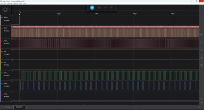

Jmstein7 wrote:
It didn't make a difference. Must be something else.
Fair enough, but I think it was needed if you want to loop back the flow control signals.
A couple more things might be useful:
- Can you post a copy of the warnings from Vivado?
- Can you post the assembler source for your monitor ROM?
Maybe I'm barking up the wrong tree, but I think it could still be a flow control issue.
The ACIA needs its CTSB input low in order to send. You are currently driving this from the ACIA's RTSB output (looped back though the Xilinx_UART module).
Can you add cts to the set of signals you monitor externally? You should see this go high on reset, then go low when your monitor initialized the UART.
What value is your monitor writing to the UART command register?
Dave

And now, nothing is working?
PostPosted: Sat Jan 13, 2024 7:28 pm
Posts: 255
This looks like the CPU is stuck running the same instruction(s) over and over. I think we're back to needing to verify that your base hardware works piece by piece. Have you done this combo of CPU + level shifters + FPGA before?
I still recommend making a new assembly file that has only the reset vector and instructions to initialize the ACIA and send a character without any RAM usage at all (eg no JSRs, but JMP is OK). If you do not know how to do this, let us know and we can help you - it's hard to gauge what kind of assistance you may need.
There are many reasons your circuit could be misbehaving (or even partially working and partially misbehaving), so writing a short program that does not need RAM (using only registers and writing only to the ACIA) helps us by eliminating some of the possibilities from even being able to happen. Note that your emulated RAM needs your level shifters to work properly in both directions (on the data bus), while your emulated ROM only needs the level shifters to work in one direction (albeit address and data are in different directions).
I think there is an issue in your ACIA (which might be the handshaking line not being driven and you may already be on the way to fixing that), but I think your base hardware may have other issues as well. We need the base hardware working before we can fully diagnose the ACIA, but Dave's (hoglet's) suggestion of posting your Vivado warnings is very good advice and may point to whatever issue your ACIA has.
A schematic showing the CPU and everything hooked up to it would be a good start, along with a photo of the back side of your board. Did you receive your oscilloscope and do you know how to use it? Some quick scope shots on both sides of your level shifters would quickly show us if you have signal integrity issues - one address line (ideally a lower bit that is changing often like A0) , one data bit, and one control line is probably enough to get started. Those can certainly cause the "works sometimes" kinds of issues. You might also check your power rails and make sure they are "reasonably" steady.
