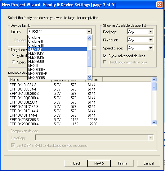

Unfortunately the windows version of Quartus II 9.1 sp2 didn't offer Flex10K in the device list, though Flex10K came up multiple times in the directory structure. It might be licence locked.
Now installing 9.0 for a look.
 Post subject: Re: CPLD trainer on eBay
PostPosted: Sat Jan 29, 2022 12:28 am
Posts: 134
Well, this is 9.0, looks like we have a winner.
I'll see if I can find a Linux version.

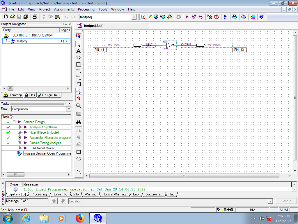

I installed the 9.0 version of Quartus from archive.org on Win7 in Virtualbox on my Linux machine. After setting up the USB Blaster programming cable to be passed through to Win7, I was able to create a project, compile it, program it, and it works! I did have to install the driver for the USB Blaster in Win7. The drivers are in a "drivers" folder under the quartus folder - if you accept the defaults during install it's
C:\altera\90\quartus\drivers
and of course you have to let Windows know it's OK to install unsigned drivers (much easier in Win7 than Win10).
Thanks to everyone who helped narrow down and locate the version that works. Attached is a screenshot of my circuit (using 1 whole Logic Element!) that just reads from one of the dip switches and turns on/off one of the LEDs in the 7-segment display.
The configuration of the Flex10K doesn't stay when the power is cycled (it holds it's configuration in SRAM). It looks like if you want it to be configured on startup, you need an "EPC" configuration device. It looks like it's a serial flash chip, but it has smarts to run the clock and data at startup to load the bistream into the FPGA (more modern FPGAs just use a regular serial flash memory and they load themselves). There is an 8-pin DIP socket on the board for an EPC but it's not included on my board.
Those EPC devices do appear to still be available on eBay. The datasheet says it can be programmed over JTAG, so I'm assuming the USB Blaster cable can program it if it's installed, but I'm not sure how it gets into the JTAG chain. There are jumpers on the University Program board to put the MAX7000 or the FLEX10K or both onto the JTAG bus, but I don't see anything in the printed manual about using an EPC device. Later Altera trainer boards had a jumper to put the bitstream into a flash chip instead of loading it into the FPGA directly and then the chip would use that configuration if powercycled.
