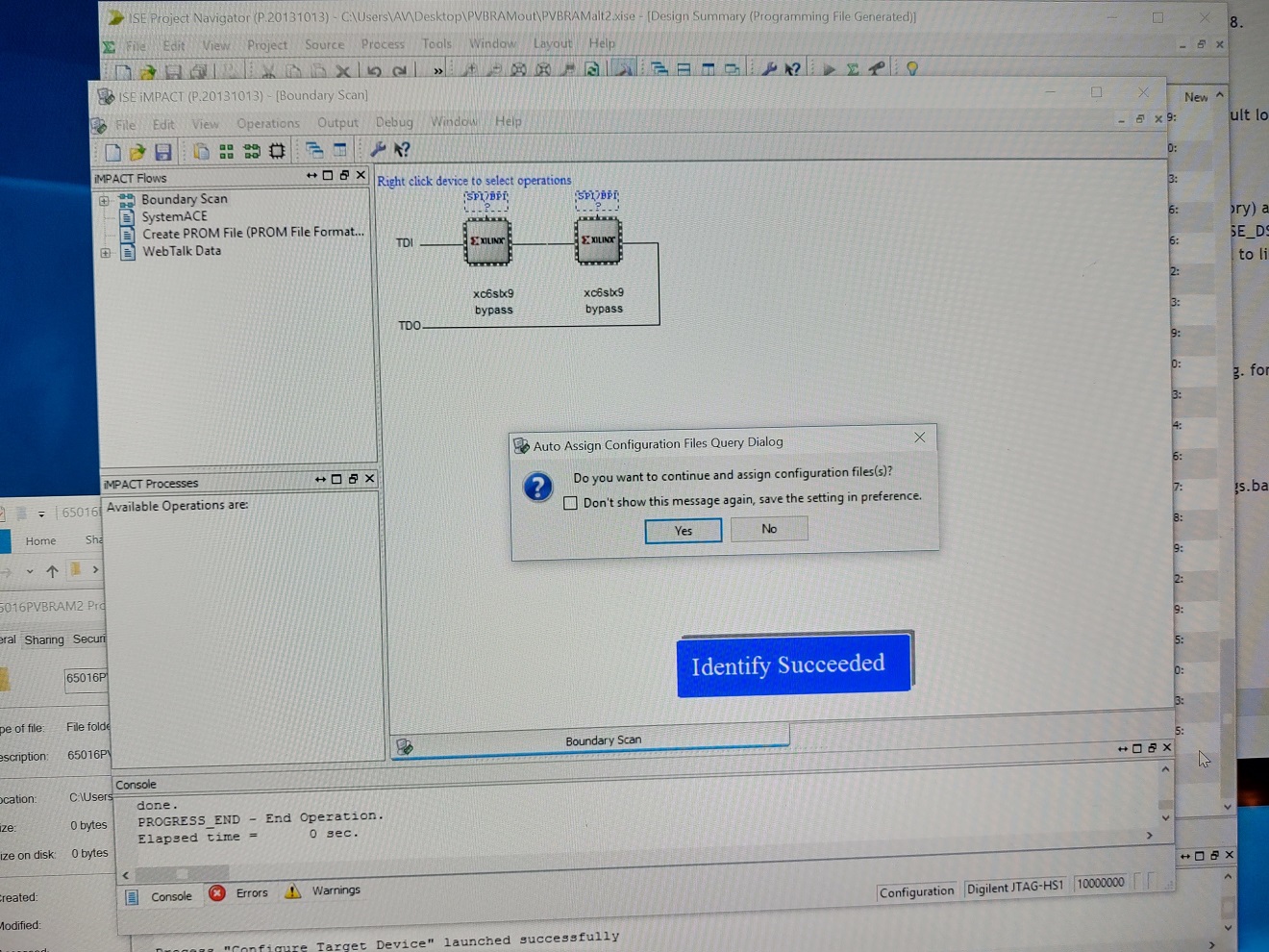

Today I modified ISE 14.7 to work under Win10x64 like in the topic I linked to above and ISE iMPACT is now working. I had to load an old project file and iMPACT was instantly available. So then I plugged in the board and powered it up and it recognized the 2 FPGA's and the SPI 'PROMs' that were connected to them.

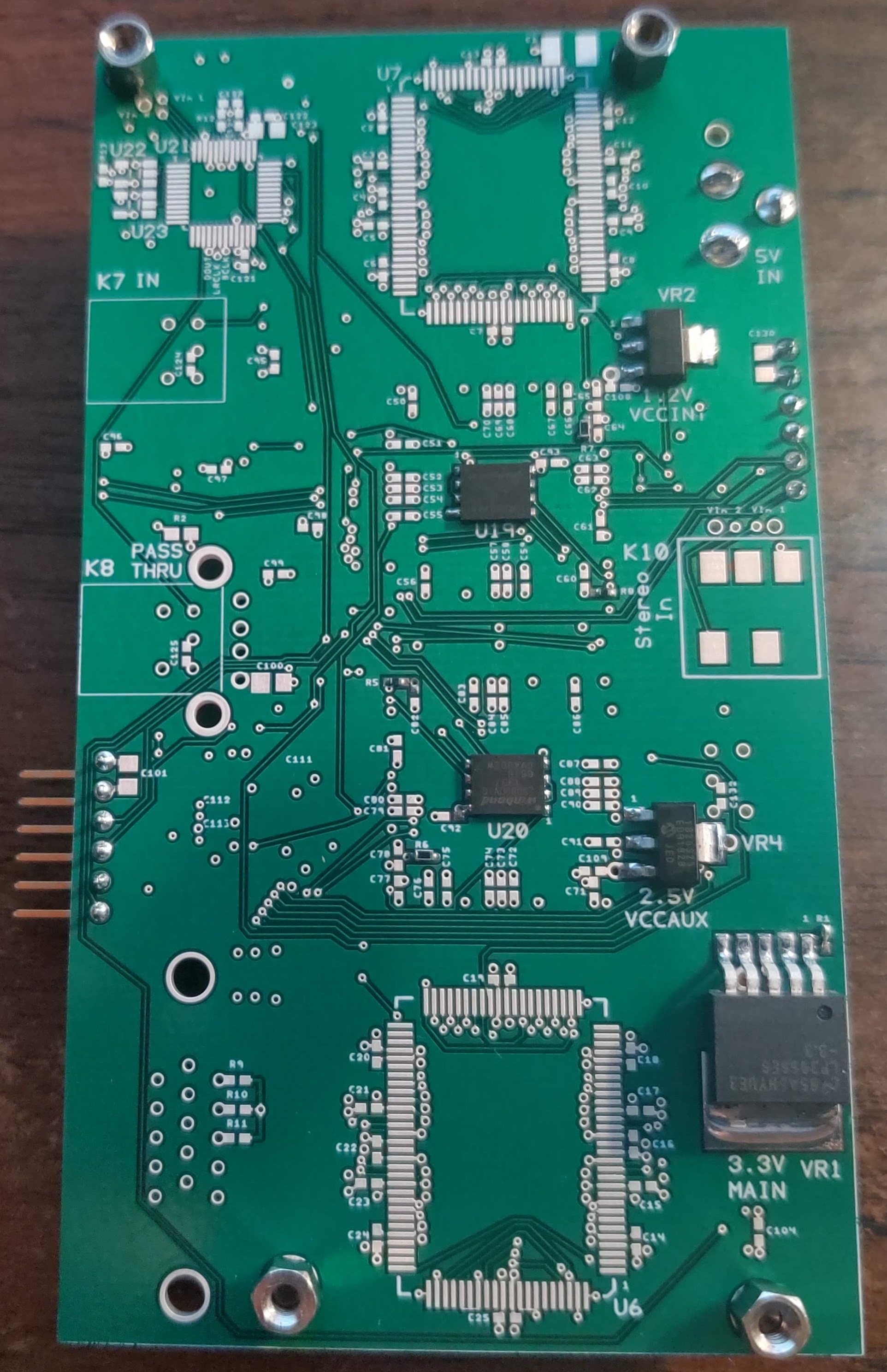

Progress update: Got the V1.6 boards in, also the necessary parts to start fresh. 2 more FPGA's, 2 FPGA FLASHs, 2 DS1818s, resistors, voltage regulators and updated JTAG connectors. The only parts I'm salvaging is the main Power In receptacle and FPGA reset buttons. More progress should be made by this weekend at the very latest. I'm starting tonight.
PostPosted: Tue Feb 04, 2020 10:48 pm
1st attempt, I screwed up and swiped the FPGA pins while soldering and bent them. 1st board was trashed, there was no saving them and they were new parts. I was so pisst yesterday...
After regathering my mental strength, today I desoldered the FPGA's from the V1.5 board where the daisy chain JTAG wasn't functional. I successfully soldered them to a 2nd V1.6 board along with new VReg's and JTAG related stuff. JTAG does appear to be functional for both FPGA SPI FLASHs (W25Q80DV). I chose the legacy device W25Q80BV in ISE14.7. Whew!!

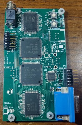

Yes, I used the hot plate for those 2. After about 20 seconds they came off very even and clean. My confidence was high that I could reuse them, since they weren't overtly abused by heat.
Yesterday I soldered in the 48-pin QFP videoDAC and associated passives, 2 SyncRAM's (1 for each S6), the pullup resistors for I2C, the VGA connector and 3 ferrite beads which are used as power supply filters to some IC's. There is 1 ferrite bead used for the videoDAC and 2 for the digital audio transceiver. Then the board got another ultrasonic clean in 91% isopropyl alcohol. Then I packaged it in an anti-static bag.
As I progress, I find myself gravitating towards a different technique. I use liquid flux now, the ChipQuik CQ4LF-1.0 and fluxless .015" silver bearing solder. This is the way to go! No solder bridges. I hate them! I prefer quick, clean and neat. No cleaning up messes...
Anyway, today after work, I unpacked the board hooked up the 5V main and threw the PS switch. Last time I did this I heard a pop and a ferrite bead jumped off the board! I was fully expecting smoke. But none. And ISE 14.7 saw the S6 and SPI PROMs!
This is a milestone. I can now begin to configure the constraints file to assign FPGA pins to the SyncRAMs and videoDAC. I already have a project to do an initial test.

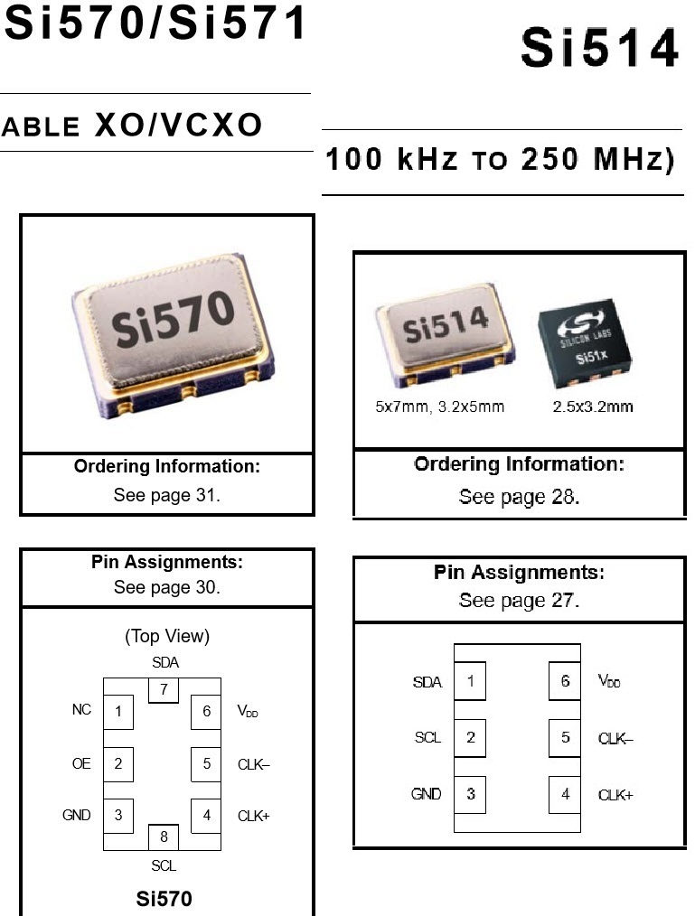

A sidenote: The Si514 has a slightly different pinout than the Si570. The I2C signals are on different pins. Luckily, the pad spacing is the same for the power and Freq out. I may be able to correct this without ordering new boards.
A pic of the top board as it progresses. Nothing much changed on the bottom yet.

Here's what I'm dealing with regarding my mistake from switching from the Si570 to the Si514. I'm thinking of routing .014" wirewrap underneath the Si514. This board was designed for the Si570, but during the interim Silicon Labs came out with a much more capable IC and I had forgotten to update the land pattern. Pretty much a 2 short right angle wire wrap wires solder to the pads, then the Si514 ontop. Gonna be loads of solder for all the pins to make up for that ~.020 gap...

I wired in the Si514 I and was expecting 40MHz out of this device as they are pre-programmed before shipping from Silicon Labs. But what I measured with my scope was right on the bottom limit of this oscillator ~@173kHz. It didn't look like a square wave either, more like a saw tooth waveform. I'll have to look into this...
