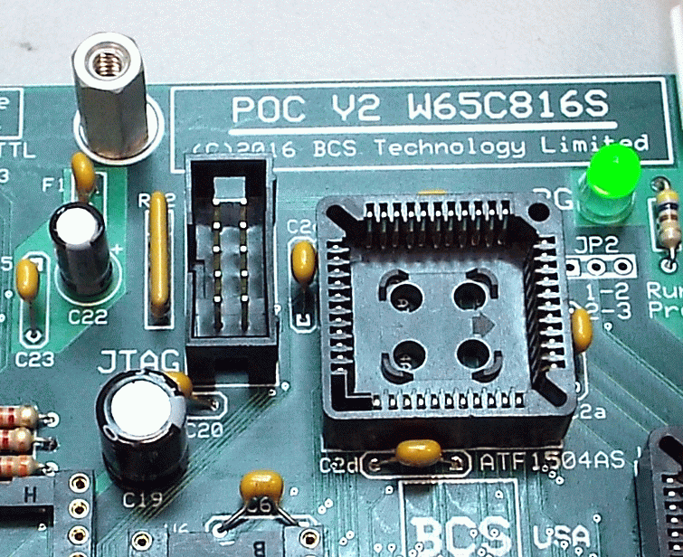

PostPosted: Sat Dec 31, 2016 9:25 pm
Posts: 8514
Aslak3 wrote:
I really wanted to try out an Atmel CPLD but I found the software impossible to find, and the programmers hard to find too. What software and programmer should be used? Can you use VHDL, or Verliog are you limited to ABEL? Looking at the Atmel website it seems you have to pay for the software?
The software can be downloaded from Atmel's website at no charge. You merely fill out a form and then download and install.
As for programming, the ATF15xx CPLDs have a JTAG port, which is easy to integrate into your design, using a standard 10 pin header (see pic). A relatively inexpensive programmer can be purchased from a number of sources that will allow you to attach the JTAG port to your PC. It's not difficult.
File comment: JTAG Port on POC V2
Sure; my last two SBCs use the same 10 pin JTAG header. Atmel lists programmers that they sell for 60 USD, but you are saying I can use a "generic" programmer? Assuming I'm stuck with USB, where can I get one? What software would I use to drive it? With the Xilinx and the Atmel parts it is all integrated and therefore seems much more straight-forward.
