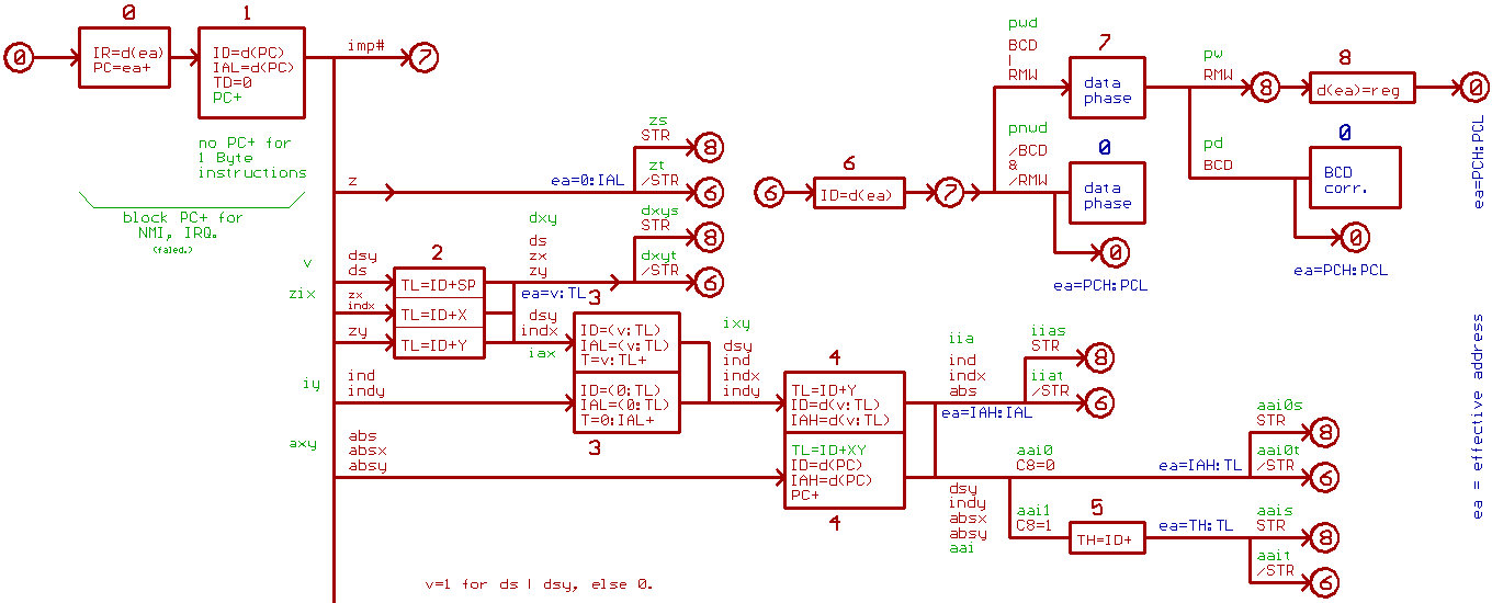

The idea was to build a 6502 compatible TTL CPU without microcode,
what means just using logic gates, a state machine and multiplexers
for the instruction decoder\sequencer.
http://6502.org/users/dieter/x02/x02.htm

Instruction decoder\sequencer:
The idea was to first to classify an instruction (instruction type and addressing mode), and to use quite a few logic gates for building a lookup table.
Then to tap into it by using multiplexers controlled by a state machine for generating the control signals for ALU, register read/write, flag write etc.
During the "data phase" of an instruction, it passes generation for a lot of those control signals over to a lookup table.
Some part of the state machine sequence diagrams:

When taking a look at all the variations of OR,AND,LDA, etc., the trick is, that a lot of instructions share the same sequence
for address calculation, just the part that handles the data operation is different.
Interesting thing is, that those nifty addressing modes break down into just a few little innocent looking boxes in the diagram,
for the NMOS 6502 (151 instructions) something like that would handle everything but BRK,RTS,RTI,JMP abs, JMP (abs),
PHA,PLA,PHP,PLP and the branches, in other words anything but 17 instructions,
and that would be 88.74% of the NMOS 6502 instruction set.
The branch instructions share the same sequence and just test different flags,
maybe the BRK sequence could be tricked into handling RES,NMI,IRQ too.
My advice here is not to see the 6502 instruction decoder\sequencer as a 'monolithic block', it can be broken into smaller chunks.
While implementing those chunks, it might be possible to use a mix of logic gates, lookup tables, state machines and\or microcode.
(Maybe chunks could be pipelined, too.)
It just depends on whether you want to optimize for speed or for compactness.

BTW: X02 had a one level pipeline.
In the cycle after an instruction fetch the Opcode has to be decoded, so the "key" to making it pipelined was to pre_emptively read a Byte
from the data bus to be used as data, or as the low_Byte for an address calculation.
A 74151 working as "predecoder" checked for one Byte instructions: $x8, $xA, $xB.
It prevented PC from getting loaded with PC+1 in this cycle, what effectively "discarded" the Byte that was fetched.
For the legal NMOS 6502 \ 65C02 instructions, this will do.
Technically, RTS and RTI are one Byte instructions, too. Out of paranoia I had checked them in X02, too...
what isn't necessarry, because those instructions would load PC with a new value after PC would have been incremented once too many.
