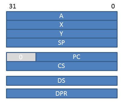

Rob Finch wrote:
the FT832 will have all 32 bit registers in native mode. The program bank register is turned into a code segment register, and the data bank register is turned into a data segment register.
It's very exciting to suppose the '816 would have a 32-bit sibling!! I wish you well with this venture, Rob, and I'm a little surprised you haven't received more acknowledgment for this project and its predecessor, the FT816.
Does the data bus remain 8-bit with this latest version? I can see pros & cons, but clearly there's a potential bottleneck when dealing with 32-bit values. And, unlike a 68008 (another chip that's 32-bit internal, 8-bit external), your core requires extensive interaction with its "registers" in zero-page. (OTOH it's fair to observe that the FT832 can handle 32-bit data far more efficiently than an '816 or '02 attempting the same job.)
Something that worries me is the challenge of in-depth testing. At present there's no '816 equivalent to Klaus's test suite, and that's a problem -- it'll hold things back for FT816, FT832 and any other projects attempting to equal and exceed the capabilities of the '816. This includes emulators like Scot's.
Although I myself can't volunteer, I wonder if there are person(s) among us who would be willing to begin working on this. Even partial coverage of the 816's operations would be a welcome improvement, as compared to piecemeal manual testing or hoping bugs will be revealed by running a preexisting application.
Yes, the databus is still eight bits. The bus structure mirrors the bus of a real '816. My thought was that it might be possible then to use it more directly as a substitute for an existing processor. It will be a bit sluggish to move 32 bit values across an eight bit databus but it's still faster than if one had to do the 32 bit ops using 16 bit or 8 bit op instructions. For an FPGA implementation limiting the design to an eight bit bus may not work out all that badly because memory (DDRAM) is much faster than the FPGA processor. It should be possible to burst read with a burst length of eight say, (64 bits) into the processor faster than it could be handled anyway. (But that's if one throws a DDRAM controller into the picture).
I would agree with you there. It's the capacity to get something that works well enough to be acceptable that bothers me. It has to be close to perfected or nobody will buy it. I have an '816 processor test program I've developed along the way that IIRC test all the address modes and instructions. But it's not really a comprehensive test suite. The FT816 is based on the '816 emulation in the RTF65003 which I had working fairly well. But for some reason Supermon816 hangs whereas it works fine in the RTF65003, which hints that there is a bug somewhere yet to be discovered.
A preponderance of working software is a good indication that the processor is okay. I believe the big companies test by running thousands of pieces of software on a processor before they release it.

I did a preliminary coding of most of a 32 bit core in the past two days to get an idea of how a 32 bit mode would work. Some of the issues are listed below. What I'm wondering is if to keep all the existing instructions the way they are and define new ones using a second opcode page, or to modify the meanings of the existing opcodes to suit a 32 bit mode.
Adaptations for 32 bit mode:
Stack - stack is always 32 bit aligned. (future performance issues).
Therefore "d,sp" and "(d,sp),y" mode displacements are shifted left twice before usage by the processor (Otherwise the two LSB's would be a useless 00 all the time).
Bank Registers
- the program bank register and data bank registers would be converted to be effectively segment registers (code and data).
Program Counter
- the program counter would be 24 bits. This is to avoid wasting too much code space on high order bytes that are always zero in a JMP or JSR instruction.
- The JMP and JSRS instruction would have to work with 24 bit addresses instead of 16 bit ones.
Segmented Jumps / Calls.
- Without defining another page full of instructions, the JML and JSL instructions would need to be redefined to allow a segment specification as well as an offset value.
Leaving 32 bit mode
- a long jump instruction to a specific code segment is used. Because 32 bit mode uses a code segment, this segment has to be switched to zero to get back to 8/16 bit emulation.
Long addresses
- long addresses including indirect long addresses would be 32 bits rather than 24.

The core will be 65C832 backwards compatible. I added the CS and DS registers as completely new registers rather than modify the usage of the program bank, and data bank registers. The registers not desired to be used can always be set to zero.
I decided to use a second page of opcodes rather than changing how existing opcodes work. The new opcodes are also available to the '816 and '02 emulation modes. The opcodes are primarily 32 bit address modes. For instance LDA $12345678,X. There are segment prefix instructions to allow overriding the default of the data segment. CS: prefix selects the code segment, but there is also a SEG0: prefix to select segment zero. IOS: selects the input / output segment ($FFD00000).
I've coded the core with an instruction cache which can't be disabled. It's pretty meaningless to have the VPA signal active during internal instruction fetches. This changes the sense of the VPA and VDA signals. VPA is active during a cache line fetch. Bot VPA and VDA are active for the first byte of a cache line fetch.
The core is going to be about double the size of the '816 core.
