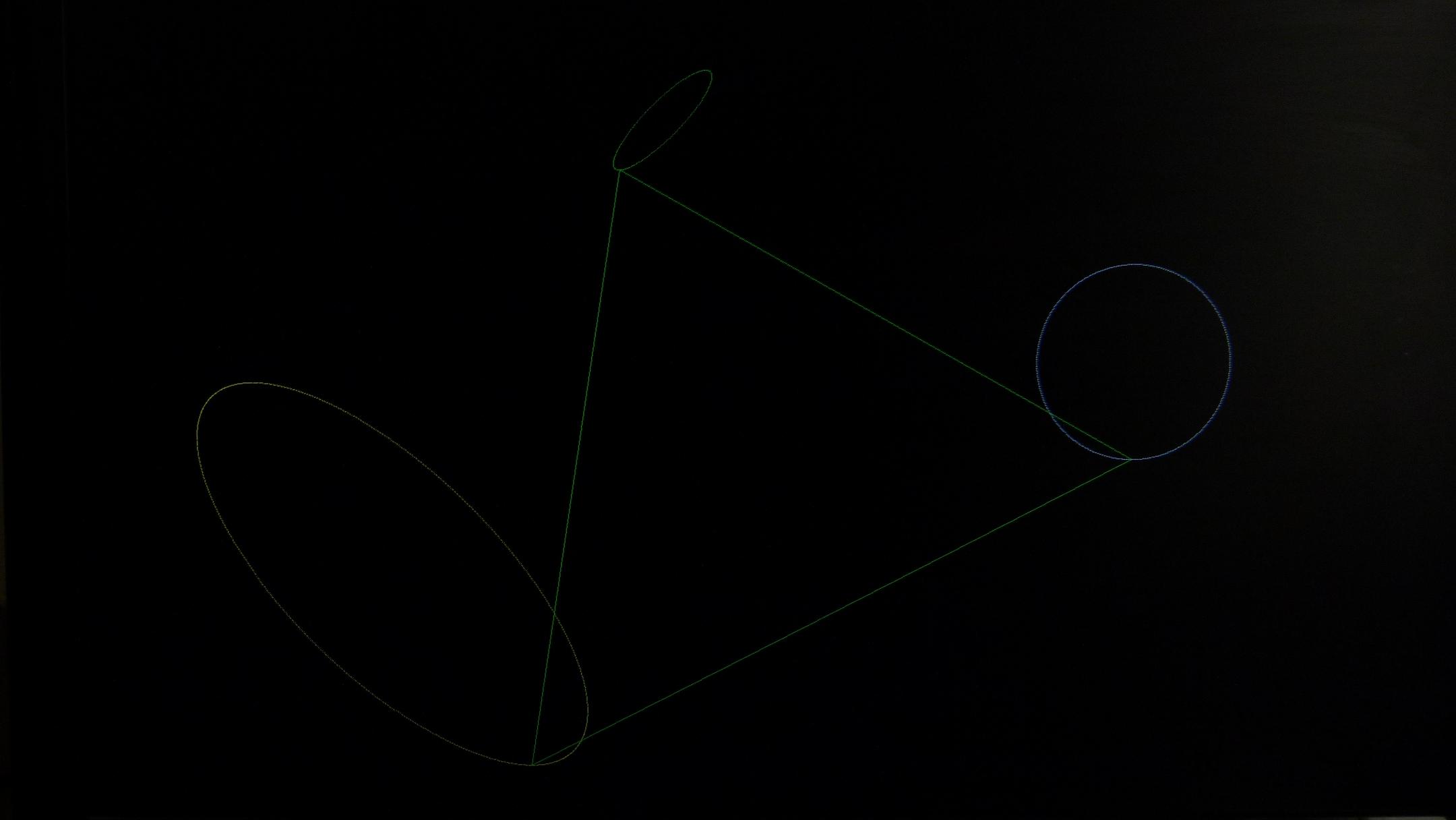

PostPosted: Sun Mar 30, 2014 9:21 pm
ElEctric_EyE wrote:
...But as far as this project, I would like to put the ellipse/circle generator which is in software now, into a Verilog module so it can run much faster. After this I will be very close to some good 3-d vector animation!
That was a tangent :!: I tried the idea, but it got hairy real quick. After about 2hrs of writing the Verilog code, simulations revealed that the way I had envisioned this was not going to work due to timing issues and it was not worth the time investment that I was beginning to realize. To compound this issue, I forgot to save the initial project success before the heavy modification. It took 4 days to get back to the last pic with the ellipse. 3 of which due to to 1 character mis-type in address decoding. I found that error this morning after extensive sim's. Stupid mistake, but finding the needle (in the haystack) gives one confidence. So I post...
Long story short: I have 3Kx11 worth (3x 1Kx11) of data values that the cpu modified from an original 1Kx11 sine LUT. I don't think there's any need yet to do this part very fast...
There is 16Kx11 available. :wink:
This is how I program it, for those who dare analyze. :lol: . It's actually cake. The Y index values are cosines in the 'sinwave' routines. The X index values are sines. So by plotting sine/cosine in an X/Y system, you get a circle or ellipse depending on the X/Y index registers. The W index is the length of the LUT.

So I have 3 virtex modifiers. A simple triangle would be a first test. These ellipses and circle would not be plotted. Lines would be drawn to their circumferences in some regular order.
BTW, here is theDELAY2 routine so I can see the pixels plotted at a relatively slow rate. This is still 65Org16.b @74.25MHz.

PostPosted: Mon Mar 31, 2014 5:15 pm
Alright! Some more progress. Changed the software that writes to each of the scratchpad blockRAM. Each blockRAM has it's own label now... Ellipses are still there for proof, now with a line drawn from each to another.
Heh, this is gonna be good! 3 other PVB's are on standby awaiting updates. They will run in serial, passing their RGB parallel graphics onto this, the final output board.
Sorry for the bad pic. The sun is actually out today which messed with the camera settings.
;---------  Circle/Ellipse Generator from sine wave LUT
                  LDWi $0000                ;LDW #0
                  LDX #128
                  LDY #256
sinwave1          STX phase
                  LDA sinout
                  LSR
                  CLC
                  ADC #150
                  STAaw scratchx1        ;STA scratchx,W
                  STY phase
                  LDA sinout
                  LSR
                  CLC
                  ADC #500
                  STAaw scratchy1        ;STA scratchy,W
                  CPX #1023
                  BMI XNZ
                  LDX #0
XNZ               INX
                  CPY #1023
                  BMI YNZ
                  LDY #0
YNZ               INY
                  INW
                  CPWi $03FF             ;CPW #1023
                  BNE sinwave1
                  LDWi $0000
                  LDX #850
                  LDY #256
sinwave2          STX phase
                  LDA sinout
                  LSR
                  LSR
                  LSR
                  CLC
                  ADC #700
                  STAaw scratchx2
                  STY phase
                  LDA sinout
                  LSR
                  LSR
                  LSR
                  CLC
                  ADC #100
                  STAaw scratchy2
                  CPX #1023
                  BMI XNZ2
                  LDX #0
XNZ2              INX
                  CPY #1023
                  BMI YNZ2
                  LDY #0
YNZ2              INY
                  INW
                  CPWi $03FF
                  BNE sinwave2
                  LDWi $0000
                  LDX #0
                  LDY #256
sinwave3          STX phase
                  LDA sinout
                  LSR
                  LSR
                  CLC
                  ADC #1250
                  STAaw scratchx3
                  STY phase
                  LDA sinout
                  LSR
                  LSR
                  CLC
                  ADC #350
                  STAaw scratchy3
                  CPX #1023
                  BMI XNZ3
                  LDX #0
XNZ3              INX
                  CPY #1023
                  BMI YNZ3
                  LDY #0
YNZ3              INY
                  INW
                  CPWi $03FF
                  BNE sinwave3
                  LDX #7            ;yellow
                  LDA CLUT,X
                  STA color
                  LDY #0
plot              LDA scratchx1,Y
                  STA Xp
                  LDA scratchy1,Y
                  STA Yp
                  INY
                  CPY #1023
                  BMI plot
                  LDX #5            ;green
                  LDA CLUT,X
                  STA color
                  LDY #0
plot2             LDA scratchx2,Y
                  STA Xp
                  LDA scratchy2,Y
                  STA Yp
                  INY
                  INY
                  INY
                  INY
                  CPY #1023
                  BMI plot2
                  LDX #1            ;white
                  LDA CLUT,X
                  STA color
                  LDY #0
plot3             LDA scratchx3,Y
                  STA Xp
                  LDA scratchy3,Y
                  STA Yp
                  INY
                  INY
                  CPY #1023
                  BMI plot3
                  LDX #5            ;green
                  LDA CLUT,X
                  STA color
                  LDY #0
                  LDA scratchx1,Y
                  STA lx0
                  LDA scratchy1,Y
                  STA ly0
                  LDA scratchx2,Y
                  STA lx1
                  LDA scratchy2,y
                  STA ly1                ;plot line from yellow to green
                  LDA scratchx2,Y
                  STA lx0
                  LDA scratchy2,y
                  STA ly0
                  LDA scratchx3,Y
                  STA lx1
                  LDA scratchy3,Y
                  STA ly1                ;plot line from green to white
                  LDA scratchx3,Y
                  STA lx0
                  LDA scratchy3,Y
                  STA ly0
                  LDA scratchx1,Y
                  STA lx1
                  LDA scratchy1,Y
                  STA ly1               ;plot line from white to yellow
STALL             JMP STALL
