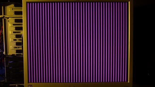

Got a video signal this morning. Had to change the constraint file, as the RGB assignments are not correct in it. Will do that today on the header post of the 'Concept & Design' thread.
The pattern is not what I was expecting. Not too much of a ramp, but it does seem an even mix of red and blue. I think tonight I will try to get some more tests done to confirm MSB placement and to single out each primary color.
Also, borders seem almost non-existent. The monitor does confirm it is seeing 640x480x59Hz. It is recommending a higher resolution.
EDIT: Found 2 bits for green out of order in the .ucf file. Don't know what I was thinking at the time, probably rushing. Thankfully an easy fix.

PostPosted: Tue Sep 25, 2012 12:58 am
Current code:
module patterngen( output reg [4:0] Red_data = 31,
                   output reg [5:0] Green_data = 63,
                   output reg [4:0] Blue_data = 31,
                   input clk50,
                   input pclk,
                   input hstart,
                   input hblank
reg countflag;
always @(posedge clk50)
   if ( pclk )
      if ( hstart )
         countflag <= 1;
      else if ( hblank )
         countflag <= 0;
   if ( countflag )
      begin
         Red_data <= Red_data - 1;
         Green_data <= Green_data - 1;
         Blue_data <= Blue_data - 1;
      end
endmodule
When I change the last part of the code above to:
   if ( countflag )
      begin
         Green_data <= 0;
         Blue_data <= 0;
      end
I see 40 Red fading bars, very similar to the original pic above with the vertical purple bars, except more brighter towards the left of each stripe.
When I set the last part to:
   if ( countflag )
      begin
         Red_data <= 0;
         Green_data <= 0;
      end
I am seeing a similar test as the previous Red test, although Blue...
Now green test is different. Thinner bars. Which at this point probably means a soldering problem. I will investigate this anomaly.

PostPosted: Tue Sep 25, 2012 11:06 pm
@Arlet. I have made the change you suggested...
But at this point, I know I have a soldering issue on the right side of the FPGA, because I see 20 bars which is what I expect when displaying 6-bit Green in a 640 pixel horizontal display, but I ran my thumbnail down the right side of the FPGA, when I did not see the expected pattern, and I was observing changes. Unfortunate. I am not the soldering 'professional' I thought I was.
I will have another go tomorrow, my only day off this week. Also, I do see noise in the video already. I am thinking back to yours and BDD suggestion of braid and excess of solder. It is ugly though. I prefer an ultra fine tip, flux and depend on the solder on the board. But, not enough solder there though...
EDIT: So this could be a bypass issue already surfacing,but I doubt it as this problem is only rearing it's ugly head on the right side of the FPGA. Tomorrow I dedicate the day for some troubleshooting.
