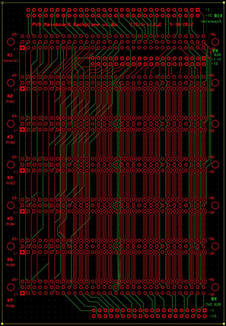

1 huge error I found was that I had the board selected as a 4 layer. So now there is no ground plane. Boards that will be connected to it will all be 4 layer though. Does anyone foresee a problem with this? Will it hurt signal integrity? The pic is updated at the head for what I am about to order.

1 huge error I found was that I had the board selected as a 4-layer. So now there is no ground plane. Boards that will be connected to it will all be 4-layer though. Does anyone foresee a problem with this? Will it hurt signal integrity? The pic is updated at the head for what I am about to order.
Am I looking at the wrong picture? I only see two layers in the one at the beginning (and the second row of each connector is mostly left unconnected). What are the rise times and expected frequencies? It seems to me that it would just be asking for trouble to omit the ground plane.

Thanks for responding Garth, it's not that I'm omitting them. I had always planned on the 2 layer board after I decided not to route power through this backplane board. All the pins that are not connected will still be grounded by the 4-layer PVBs plugging into these receptacles. The price for a 4 layer board of this size would jump from $109 to ~$325 for 2! Can't afford that. Most frequencies around 100MHz. The one in the middle will be a main clock.

Then at least route ground traces to connect the ground pins from one connector to the next, between the signal traces. It looks like you have plenty of room to do it. Use vias if necessary. It doesn't do any good to have a gob of ground pins sprinkled around if they don't go through. The signals' return paths need to run really close to the signal traces, parallel to them.

Ok, I follow you. I will do this for the high speed RGBin and RGBout and all clock signals. Thanks alot!

Garth, I've made some progress and I have another question if you would entertain it please: I think that the purpose of lining fast signals with grounds on either side, is to cancel out the EMI and other ill-effects. So would it be better, instead of using thin .006" traces, to go as thick as possible?
This is what I have so far. I have to figure out a few more things, but I'm thinking of doing away with the RGB I/O connectors.
Rambling here: For one, K9 the RGB-In connector is getting in the way of my primary clock signal from the K1 Control Board to the other PVBs on the bottom layer. RGB-in signals will ideally be coming from the controller board, from a video input module with 5-6-5 output into RGB-In. The RGB-Out at the bottom would be a different style connector, and would match pin spacing, in order to accomodate straight pass thru and signal protection for future HDMI output.

Wide is good, but the first priority is just to get the return closeby. After that, the width and separation distance affect the transmission line's characteristic impedance, but at least the main problems with inductance and unwanted radiation and coupling are much improved. Again, it's not a matter of high-impedance electric-field capacitive coupling like we have more in audio, but of low-impedance circuits where magnetic fields are generated by current through a conductor. If the return path is right close to the signal path, the mutual inductance of the two will make equal and oposite currents flow in the two, cancelling out their effective inductance and their radiation. The balanced nature of it also reduces their susceptibility to unwanted interference. One of the effects of widening a trace is reducting the resistance that results from skin effect, but that's a pretty minor issue here. One of Dr. Howard Johnson's many articles on high-speed digital design deals with it.
Since your red (top) traces hide a lot of the green (bottom) ones, there's a lot we can't see, and seeing them would probably answer some things I find puzzling since I don't know all of what you're doing with it. Do take care of the green traces between PVB5 and PVB6 connectors however, near the middle, which have some pretty good design rule violations and unintended shorts to pads.

...Since your red (top) traces hide a lot of the green (bottom) ones, there's a lot we can't see, and seeing them would probably answer some things I find puzzling since I don't know all of what you're doing with it. Do take care of the green traces between PVB5 and PVB6 connectors however, near the middle, which have some pretty good design rule violations and unintended shorts to pads.
I can say what has happened naturally, is most of the slower signals were pushed to the bottom layer with considerable re-routing. All except for that 1 signal which is a 'potential' main clock. It is at the center of the board, and at the center of each connector on the bottom layer, the one that sticks out like a green thumb, with errors and shorts as you have noted. I had halted my progress and thought of getting rid of the RGB I/O connectors at this point because the RGB In connector is in the way of this primary signal... But thought I would post progress of my basic understanding of your hi-frequency signal protection.
Tomorrow, I'll focus on finishing the routing. Also, on filling in and widening the grounds around the hi speed signals. Thanks again for your continued input Garth!

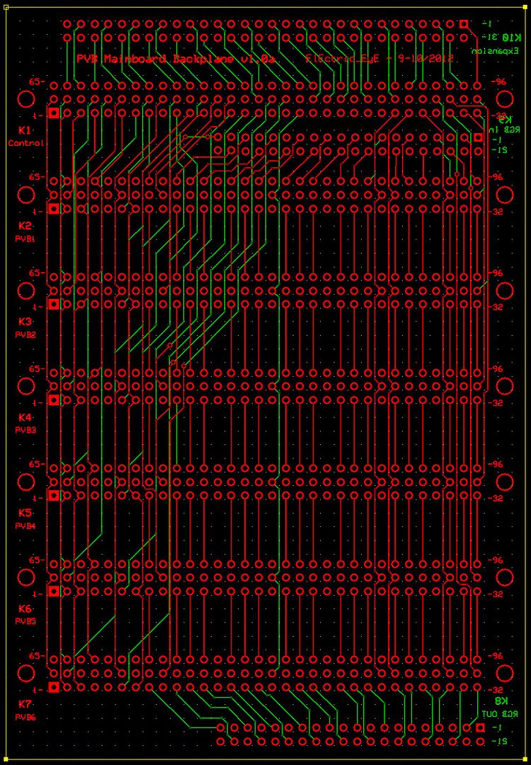

I've updated the head post with a pic of what I have so far. The basic structure is still there, but alot of details have changed. I will work the errors out over the next few days. I post v1.0d at the head because I have a preliminary final design.
Here is v1.0c for comparison:Image.
