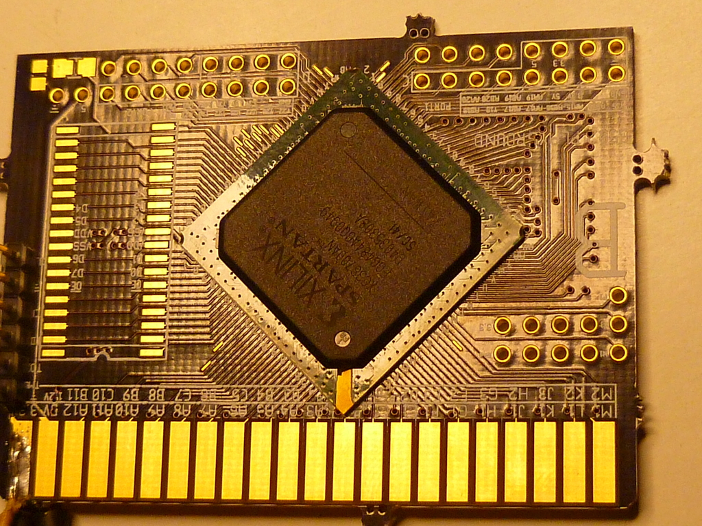

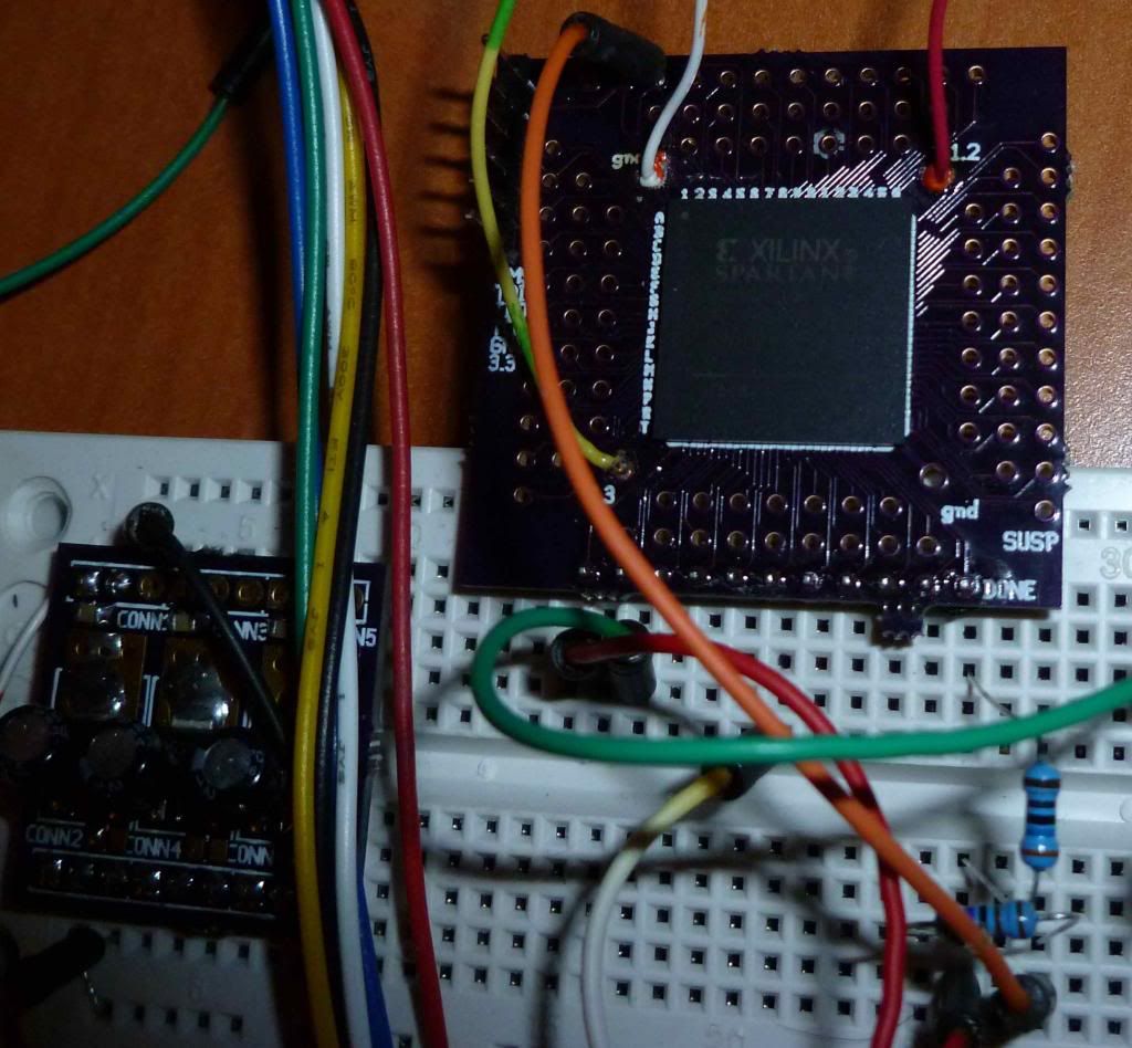

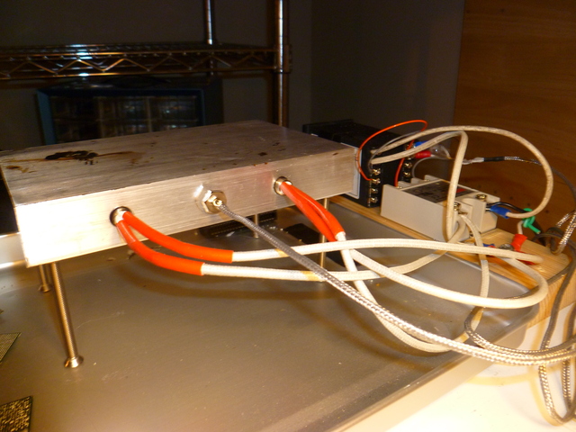

XC3S200AN 256-pin BGA successfully mounted. It configures, and I've tested a bunch of the connected pins with an LED blinker circuit...
Soldered using a hunk-of-aluminum PID hotplate, homemade.
I am sick of the flaky breadboards, though. Anyone else interested in a wire-wrap breakout board for BGA chips?

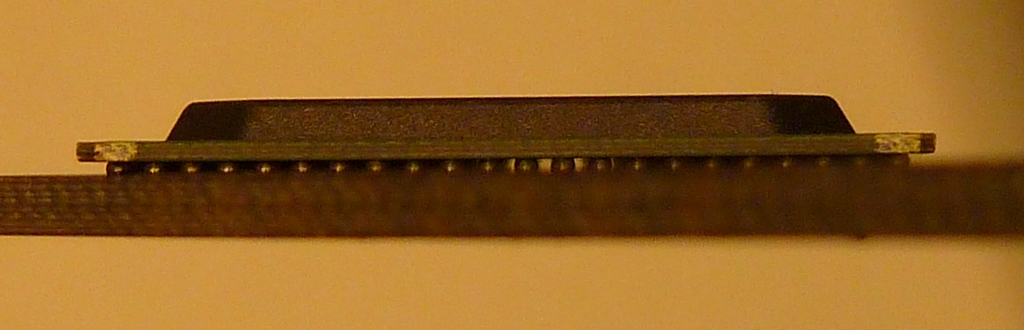

I would like to report another mounting success, this time with a 484 BGA package:
Here is an edge view, showing how you can see underneath the chip. This gives you a pretty good indication that there are no shorts - you can see down the entire grid!
I soldered down 3 of these BGAs perfectly.

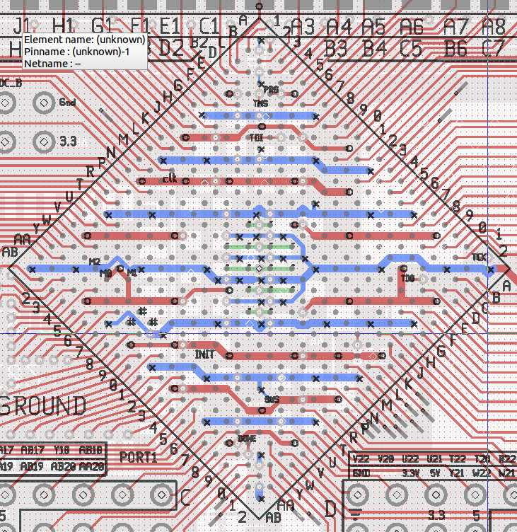

BGA484 is greatly underutilized in my case, but it was more than enough IOs for my purposes.
With a two-layer board, in the ideal case you can bring out 4 rows (2 on top layer and 2 on the bottom layer), from each of the 4 sides. In practice (once you try you'll see why) the yield is lower. But with 22 rows of pins, even 2 layers gives you 22 x 4 = 88 pins, and you can easily take out more than 100.
If you need a lot more, I would just use the BGA 1154 package, with rows of 34 pins. You can easily take 400 pins out of that one, and the wider chip gives you more room to route around - not to mention that there are more goodies inside!
My thinking is to not worry too much about the 'wasted' pins, and just enjoy myself...
I do want to point out that if you plan to make a fast core using Spartan6, consider that not having a groundplane may be problematic...
Here is the relevant piece of the PCB: (Click to enlarge. .) Note there are a few IO lines that I just didn't have room to route anywhere, so I attached them to long narrow pads that can be used to attach wire-wrap wire for future expansion.

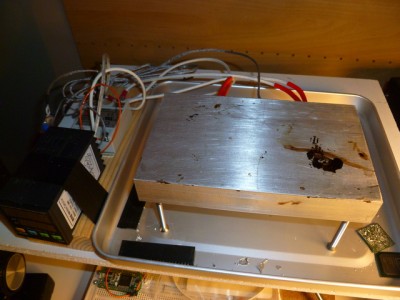

How much cost and what parts were involved in your PID hotplate custom construction? I think you laid out a few parts for your thread in the hardware section? or somewhere, but not really any of the full details. If I missed the thread just point there. I remember an aluminum block with 2 connections.
enso
Posts: 904
Joined: 29 Sep 2012
Re: Working with Xilinx BGA packages
Post by enso »
Parts for the hotplate:
  • aluminum block. Size not too important; mine is about 1" x 4" x 7"
    pid controller
    ssr - solid state relay
    thermocouple
    heating elements - I used 2 x 500W units (it takes about 10min to heat up to 250C)
You can get these on amazon, ebay or anywhere in China. Total cost should be <$75, especially if you can get the aluminum block locally.
Make sure the PID controller can use a thermocouple - I think all of them can.
Heaters and thermocouples come in all sizes - pick one that will fit inside your aluminum block.
Once you have them, drill your block. Don't even think about using a hand drill, use a good, long-travel drill press or you'll be sorry. I was sorry - my drill press could not travel far enough, and my drill bit was too short. Needless to say, using the wrong tools just makes your job harder - each hole required readjustments of the drill press mid-drilling.
Then insert heating elements and the 'couple. Mine was big enough for 2 heaters - a single one for a smaller block is probably fine. The thermocouple hole was threaded, the heaters just pressure-fit into holes.
The rest is making electrical connections and deciphering the PID instructions. I used the default PID tuning settings - it's good enough. Pulses the heaters about once per second.
I am not sure if the hotplate is really better than an oven. For experimenting, definitely - you can see your board better. But an oven is better for attaching lots of chips on both sides of the board.

    You don't need an X-ray machine! You can look at your BGA from the side, right through every row of balls to verify that there are no shorts. And the balls themselves around the edges give you a very good idea of how well the part is attached. If it's symmetrical and the edge balls are well-formed, and you can see through it, you are done. I haven't had a single problem yet.
    The hard part is not the soldering, it's laying out an error-free circuit connecting all those pads under the chip. Breaking out from the grid is a real puzzle - you can't put vias under pins (they suck solder right out); there is only one place to put a via - smack in between 4 pads. Once you put a via, you can't put a wire there, so it's a lot like a Rubik's cube.
    All PCB layout packages simply stink when it comes to dense BGA grids. I use gEDA PCB - it's quirky but at least it's opensource and the files are text-based, so I can generate tricky footprints or adjust placement of things with a text editor on occasion.

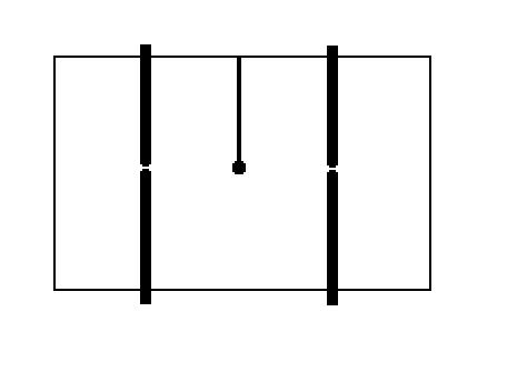

I ordered my hotplate! Was just a little over $83. I had to make a different design because of the aluminum block was 8 5/8" x 6" x 1" for $30, shipping was almost $20! I don't think I'll ever make a board larger than that. I choose 4 x 300W heaters for $21. And PID controller for $32. Since each element is just over 3.1" I wonder if a little bit of the element protruding from the block would be ok?
I like what Garth said about filling in vias. Maybe it's not "professional", but that is something I would try. Maybe mark off equal lengths of solder to put into each hole
