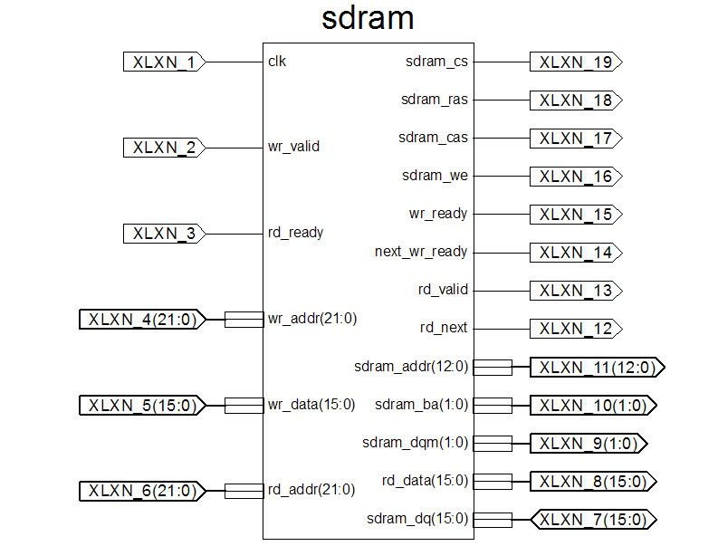

Arlet wrote:
...The SDRAM controller code takes care of all of this.
Yes, checking it out. Maybe now I can make some heads and tails of it. I've made a symbol of it to see the I/O's and get a general feel. I see the CPU sends a read & write address A0-A21 (2M), but the SDRAM you used is a 4Mx16. Did you only use half of the RAM?
EDIT:Oops, A0-A21 is 4M.
Symbol:

PostPosted: Tue Nov 01, 2011 12:48 pm
The A0-A21 refer to the 16-bit word address, so it's also 4Mx16. I didn't have byte addressing, and the 6502 wasn't hooked up directly to the SDRAM. I used a block RAM to map part of the SDRAM into the 6502 address space, and a separate DMA controller to move big bursts from SDRAM to block RAM, and back. The dual port block RAM had a 8 bit interface on one port (connected to CPU), and a 16 bit interface on the other port (connected to SDRAM).

PostPosted: Tue Nov 01, 2011 1:15 pm
Ok, fixed the link.
What size block RAM did you use?
As far as your code, the only thing I should have to modify to make it work with the 16M SDRAM is the Address length?

PostPosted: Tue Nov 01, 2011 1:23 pm
2KB. That's the native Spartan3 block RAM size, but you can make bigger ones by combining several.
The address length, yes, but also the page size which is 512 words (9 bit) instead of 256 words (8 bit). This means that the end_of_page/end_of_rd_page signals need to be modified, as well as the sdram_ba, and sdram_addr assignments. You also need to check the sdram_delay values, and the refresh period.
