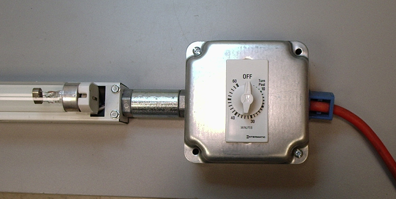

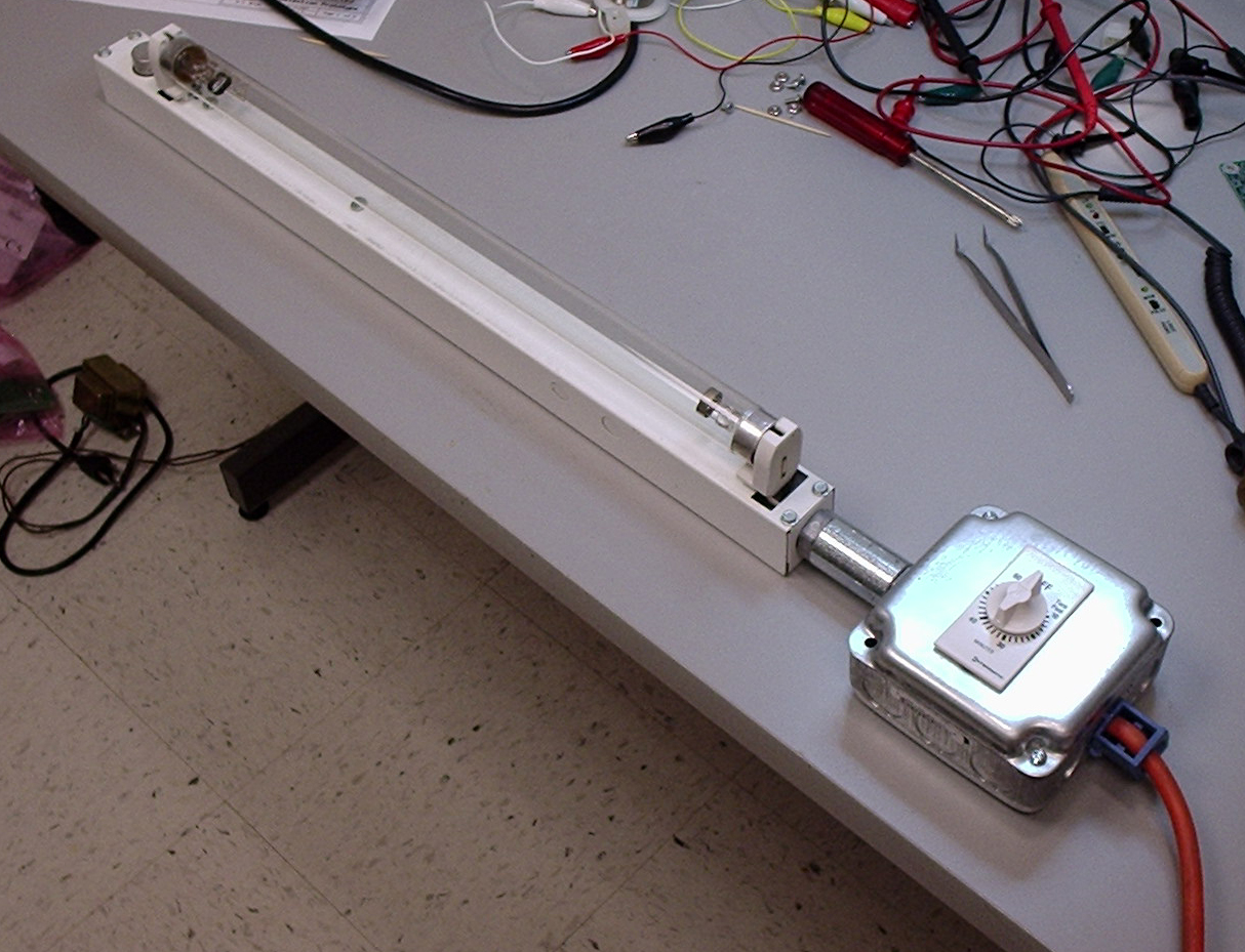

I built an EPROM eraser from a cheap kitchen cabinet light fixture, using a antiseptic UV fluorescent lamp and a mechanical timer. Erase time is typically 12 minutes and I can get 15 EPROMS into the rig at a time.
I've since "improved" my low-tech EPROM erase by attaching the timer directly to the light fixture.
File comment: EPROM Eraser w/Integral Timer
