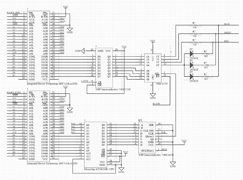

It’s possible to fit a VGA controller in a 64 macrocell CPLD (Plus a ROM, Shift register and some RAM) I have some VHDL for it but am on vacation at the moment
Are you still on vacation? :-D
I would be interested in seeing the VGA/CPLD code you have.
Hey sorry about this late late late response!
I will post this later today
I've got it doing something like 80x30 Text with colour at 640x480 I think.

My VHDL at the moment is as follows, some friendly posters have given me some tips to improve it and I haven't had time to implement them but it should work as is.

The circuit I'm using for 16 colors (missing the CPLD itself)
The ROM is the character generator.
If you only want B/W you can omit the top half of the circuit (the top ram holds the color information, the '273 latches this and the 157 switches between upper/lower nibble for foreground/background color
You can simply gate the Q output of the shift register with BLANK and send the result directly to the monitor.
