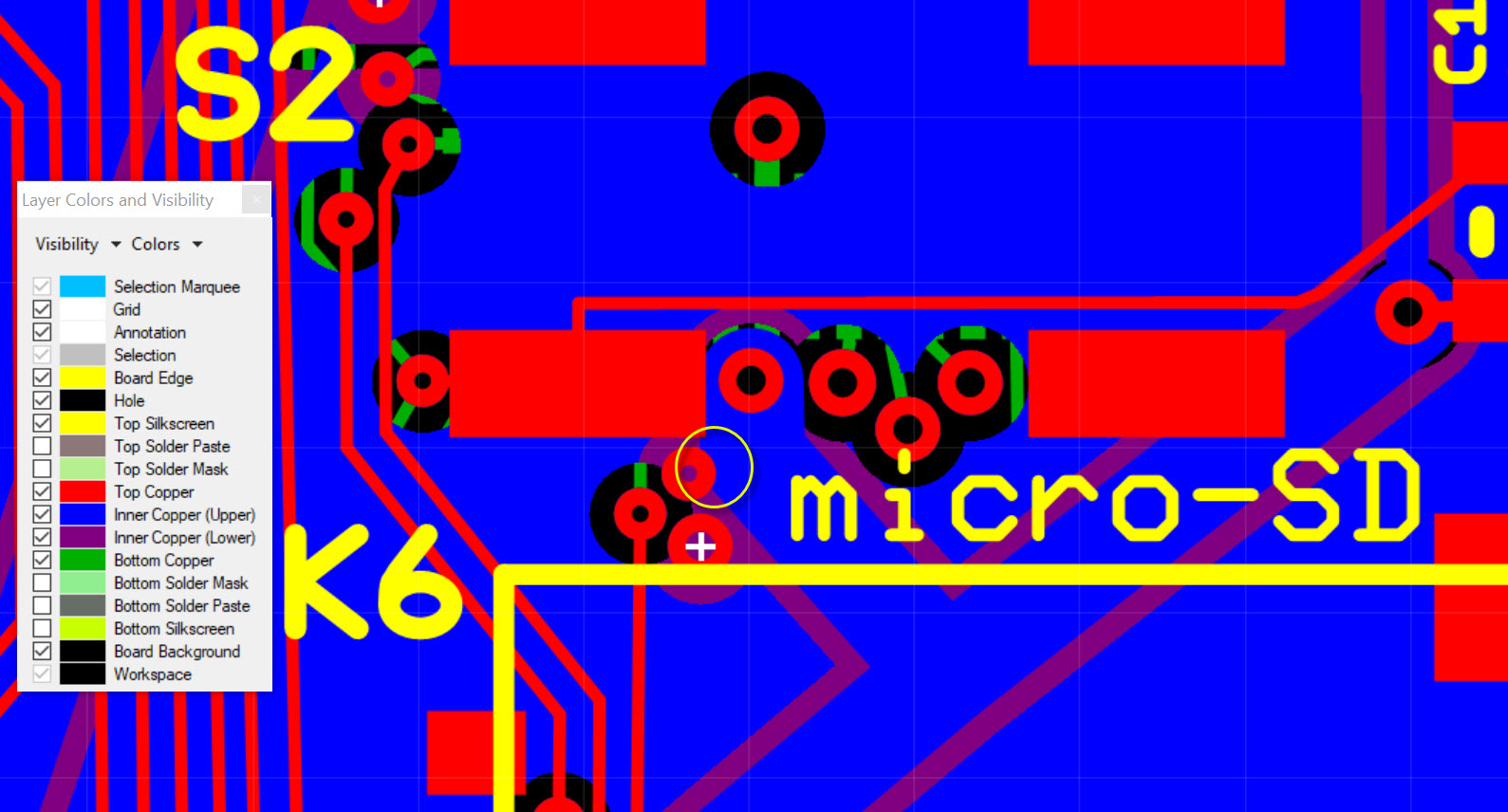

Yes I know exactly where it is. When I found the short after I soldered the VRegs, I went to the 2nd unpopulated board and witnessed the same thing. Then I knew I had a problem and started searching the design for vias that were incorrectly assigned to a layer. But then I found it and it was a strange mix of relief and disappointment. Relief that the manufacturing process was solid, disappointed I did something so stupid and so close to the end of sending the design in for fabrication. I just checked my logs, the design was sent in 3.5.2019. I checked the design entry to my backup file 2 days earlier @ 3.3.2019. No problem there.
What really pisses me off is I failed to mention the modification in my changelog!
3.3.2019
Added a via next to K9/U24 to bypass U24 if needed.
Enlarged pads for U13,U14,U15 & U8.
Corrected via for DIR pin on U13.
3.5.2019
Widened U11 footprint by.015.
Fixed/tightened K6 footprint.
Expanded pads for U24. Identical to U13,U14,U15.
You can see here where the problem is circled in yellow to the left of micro-SD silkscreen, I don't think there's anything I can do to fix it.

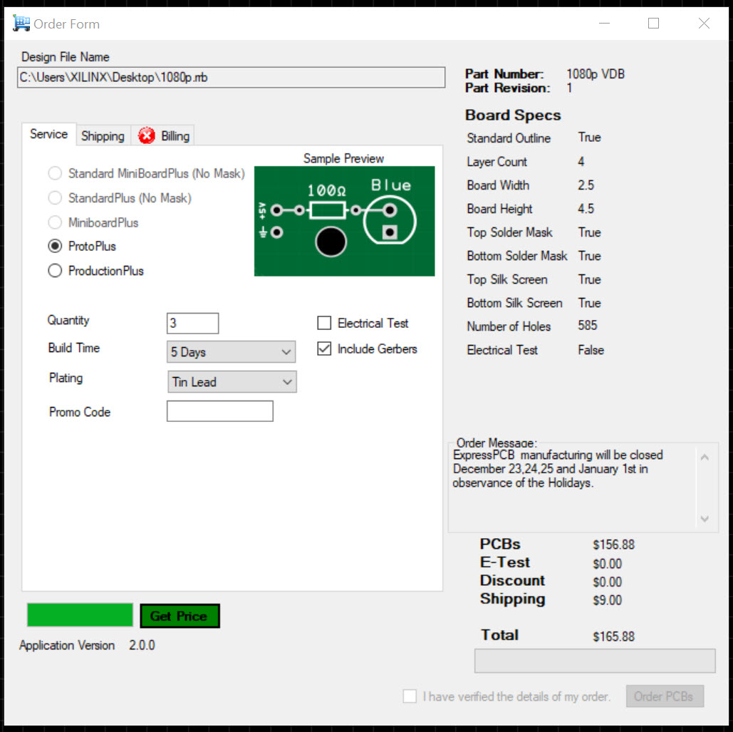

PostPosted: Fri Dec 13, 2019 11:11 pm
I ordered the boards. Be patient with this old geezer. I'm writing up a whitepaper on the new board. I tried last night to start a new topic but over an hours worth of typing online resulted in some kind of login timeout and lost all my work. Patience is definitely required in this hobby of ours.
