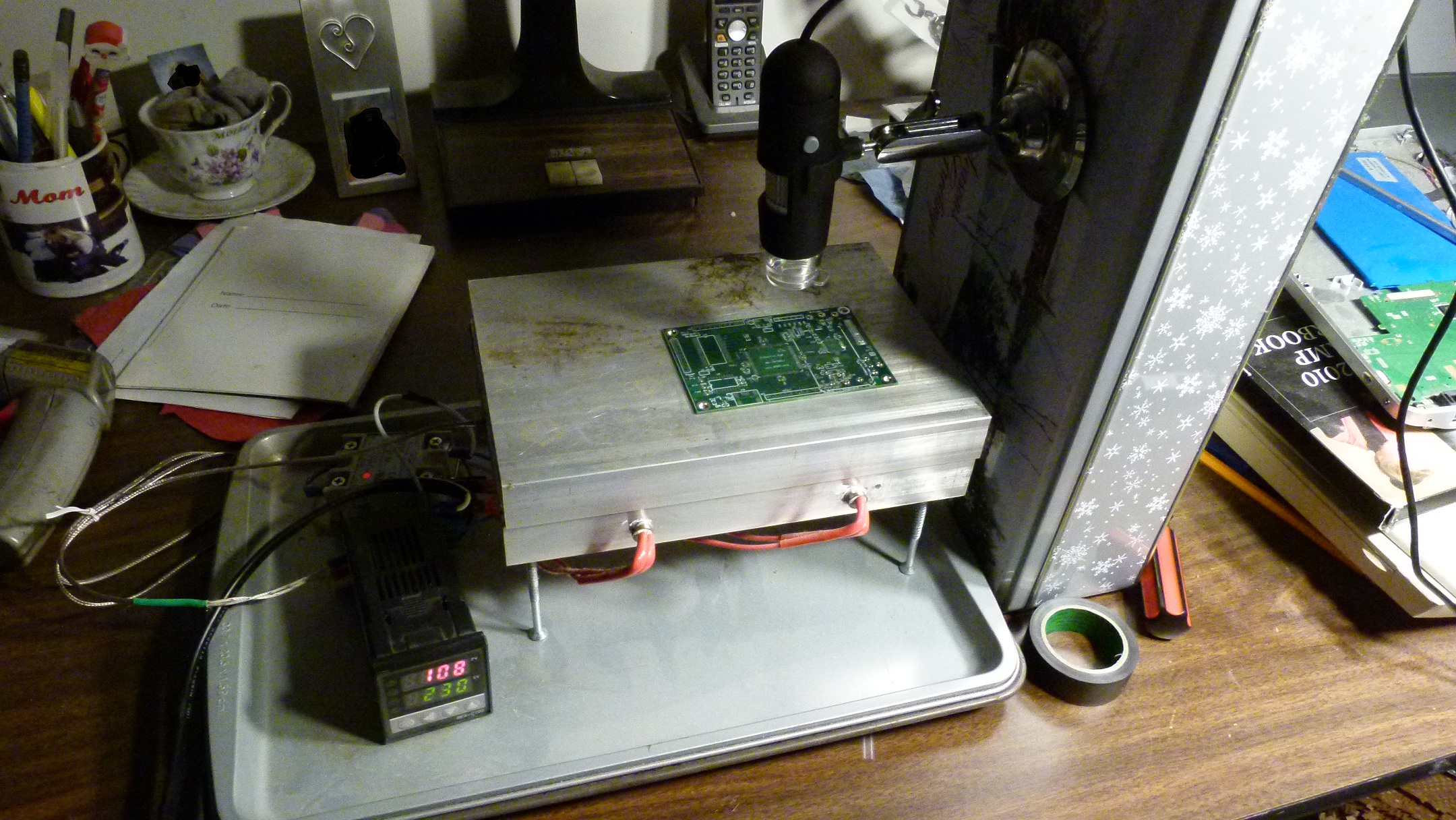

Well, I was unable to learn the Eagle PCB payout program in any reasonable amount of time, so I gave up on this idea. But I still pursue mount a 256-pin 1mm BGA Xilinx Spartan 6 LX25 device.
I have purchased the USB microscope mentioned earlier. Note the megapixel count has gone up from 2 or 3? up to 5MP.
I placed it about 2 inches above the hotplate during heating up to 265degC. I was expecting fogging or melting or something, but no such bad luck.
A neodymium magnet was placed behind the non-slip covering, that's what's keeping it on the metal cookie box. I would like to make a wooden jig tomorrow so the camera doesn't move in relation to the hotplate.
As it is now, this is what I'm working with. The 2nd Al alloy plate was placed on top so I could do a quick pic, since the bottom plate was still up to temp.
I just plugged the PID controller real quick to make it look live.

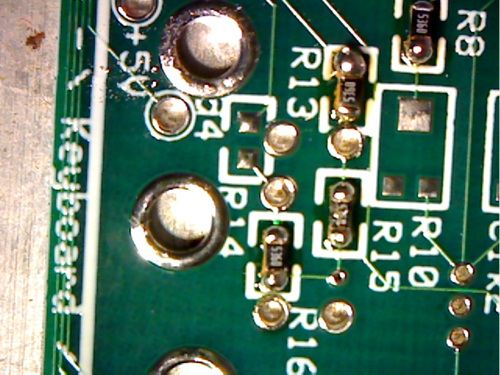

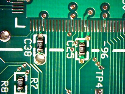

Using a fresh board from an old 6502SoC design, I needed to test soldering in some 0603 536ohm resisitors. For solder paste, I'm using ChipQuick part # SMD291AX10.
The first run wasn't very successful, as I attempted to use their fine tip dispenser.
You can see some before and after pics using the USB scope.

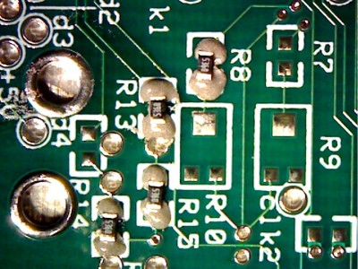

Now with my 'special' needle dispenser, I have a much better result.
I didn't think to do a before pic, but it is about 1/3 of the solder paste in the above 'Before' pic.
I hardly put anything down but it still looks like a tad much!
I can say I am absolutely amazed at how the parts centered themselves due to the solder reaching its melting point and the surface tension of the liquid solder. :lol:
