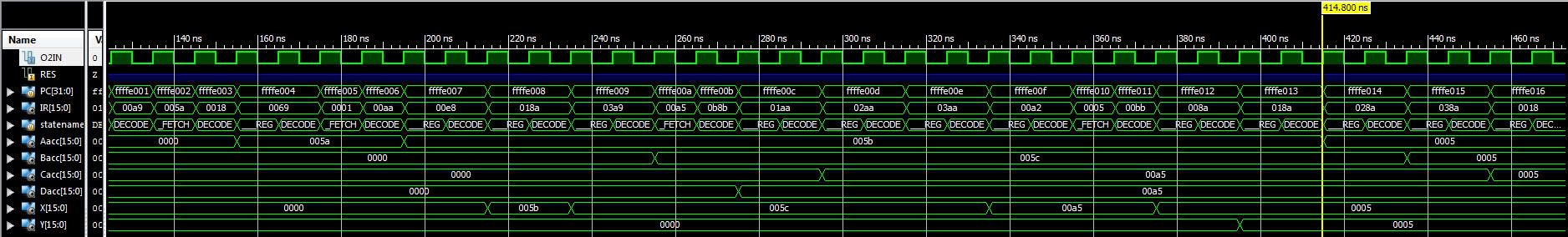

PostPosted: Wed Mar 07, 2012 7:47 pm
Sounds good to me. Still testing...
I found an error with the T[A..D]X & T[A..D]Y. Fixed that and updated.
I am noticing in Simulation, that during a Transfer from X register to Acc, the IR lasts 2 cycles (_REG, DECODE) and other times it lasts 1 cycle (DECODE). Is this normal depending on which opcodes are before it? The values being transferred are good, just that cycle discrepancy.

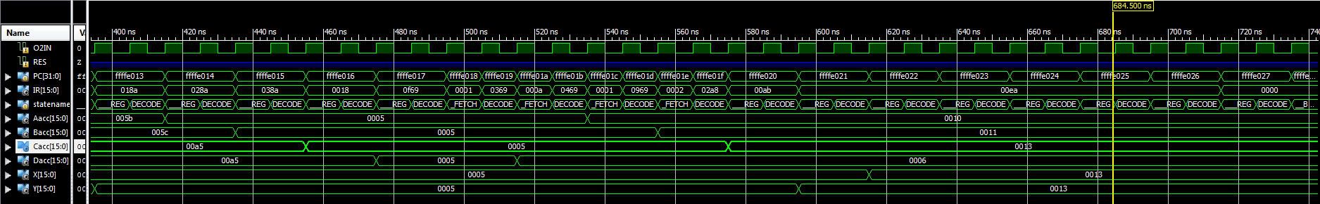

PostPosted: Wed Mar 07, 2012 9:29 pm
Proof is in the pudding. Here is the pudding!
START             LDA #$5A        ;00A9,005A
                  CLC             ;0018
                  ADC #$01        ;0069,0001
                  TAX             ;00AA
                  INX             ;00E8
                  TXB             ;018A
                  LDDi            ;03A9
                  .BYTE $00A5     ;00A5
                  TDC             ;OB8B
                  TBX             ;01AA
                  TCX             ;02AA
                  TDX             ;03AA
                  LDX #$05        ;00A2,0005
                  TXY             ;00BB
                  TXA             ;008A
                  TXB             ;018A
                  TXC             ;028A
                  TXD             ;038A
                  CLC             ;0018
                  ADCDi           ;0F69        Add op to D Acc, store in D Acc
                  .BYTE $0001     ;0001
                  ADCDopAi        ;0369        Add op to D Acc, store in A Acc
                  .BYTE $000A     ;000A
                  ADCAopBi        ;0469        Add op to A Acc, store in B Acc
                  .BYTE $0001     ;0001
                  ADCBopCi        ;0969        Add op to B Acc, store in C Acc
                  .BYTE $0002     ;0002
                  TCY             ;02A8
                  TYX             ;00AB
                  NOP
                  NOP
                  NOP
                  NOP
                  NOP
                  NOP

 Post subject:
PostPosted: Thu Mar 08, 2012 9:56 am
For example above at 180ns & 550ns, there is $00AA(TAX) & $02A8(TCY) which is just 1 cycle. Then the transfer around 220ns, a $018A(TXB) takes 2 cycles.
In the above code, if a transfer comes after a transfer it takes 2 cycles. If a transfer comes after an ADC[A...D], it takes 1 cycle.
 Post subject:
PostPosted: Thu Mar 08, 2012 10:18 am
Aha, yes, that's possible because you're looking at the state before the DECODE. In one case, that's a FETCH, in the other case, that's a REG. In the case of an ADC #$0001 instruction, it needs to read the immediate operand from memory, so the bus is busy doing that.
In case of a REG instruction, the memory bus isn't needed for one cycle, so it's basically doing a "don't care", which happens to be reading the next instruction. The result is discarded, and it's read again on the next cycle.
Keep in mind that the IR isn't really a register. It's basically a view of the DI bus, with some MUX logic inbetween. It only needs to contain the opcode during the DECODE state, and it's a "don't care" in any other state.

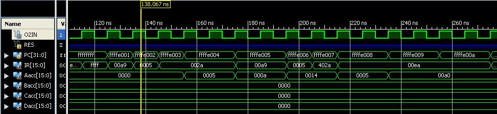

Using bits and pieces from BigEd's code to do variable shifts using a barrel shifter in the ALU, I have got some results that appear correct in 2 cycles!
More testing is needed but a regular ROL ($002A) and a 5x shift using a ROL($402A) outputted correct values to the A Acc. I had to add 1 to the value of the 4bit register, that gets its value from [15:12] of the <shift,rotate> opcodes, so it does at least 1 shift or rotate.
Max speed is still at 94.7MHz! Hard to believe that.
Thanks BigEd for that chunk of code in the ALU!
START             LDA #$05
                  ROL A
                  ROL A
                  LDA #$05
                  .BYTE $402A
