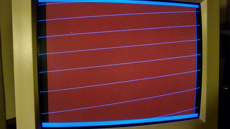

Had just a bit of success today towards my lofty goal of a Cordic Graphic Processor. No Cordic here yet, but I was able to plot a green pixel based on X & Y counters, amidst alternating black and red pixels. If I change to white & red alternating pixels, it's incorrect for some unknown reason. Any hints?

PostPosted: Wed Oct 31, 2012 6:30 am
If all you do is change red/black into white/black, and it fails, I would suspect you have a problem with too many switching outputs. Did you mount all your decoupling caps ? You can try experimenting with drive strength and slew rate of the outputs.
PostPosted: Wed Oct 31, 2012 7:57 am
I made a small change to the code so it now looks correct in simulation, but same result on the monitor. Interestingly, same action down to 4mA drive strength. Thankfully I observe correct colors when I make the border black (still @4mA), so I don't think it's an SSO issue. I think I'm confusing the monitor somehow. How do I get rid of the diagonal lines? That is the vertical retrace? I need to send zero's during this time don't I?
PostPosted: Wed Oct 31, 2012 9:21 am
Yes, during vertical blanking interval (including front porch, back porch, and vsync interval) you need to send black values.
PostPosted: Wed Oct 31, 2012 1:59 pm
Ok thanks for the hint. I checked the Sim and made it so that the DAC sends zeros during ( vblank & vsync ). Almost works on my LCD using 640x480 @25MHz using timings from tinyvga website. The display area is too large, but I see correct border color (blue) and display colors (alt. blue & red) when manually shifting horizontal and vertical position using monitor controls. However, on the old CRT it is still confused and I see black and red with a green dot. I will aim for correct display timings on the TFT then see if the CRT complies.
PostPosted: Wed Oct 31, 2012 3:21 pm
Got it working on the LCD monitor! To make it useful and make sure that my timings are correct, I successfully plotted a green pixel @ (0,0) and also @ (639,479). The hardware in the LCD seems to automatically trim off the borders. Now, I would like to draw lines in hardware. I'll look at FPGA4FUN and openVGA project for clues. I'll work on getting the CRT working abit later...
