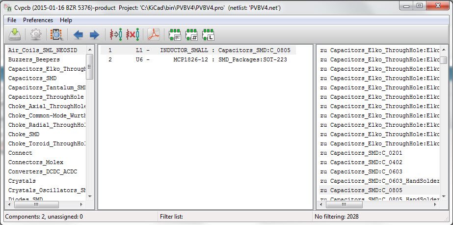

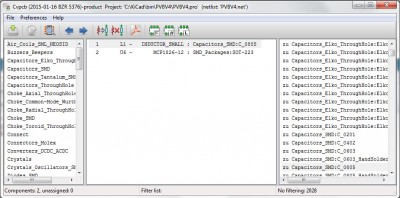

PostPosted: Sat Mar 14, 2015 12:01 am
So far a Netlist has been generated for a very complicated 6-layer design.
Next is to run 'CvPcb'.
It creates a .cmp file for PCBnew. It is the bridge from schematic to layout.
Since the schematic is simple, you can see this footprint assignment process is very simple as well, but there are lots of choices. :wink:
More tomorrow...
