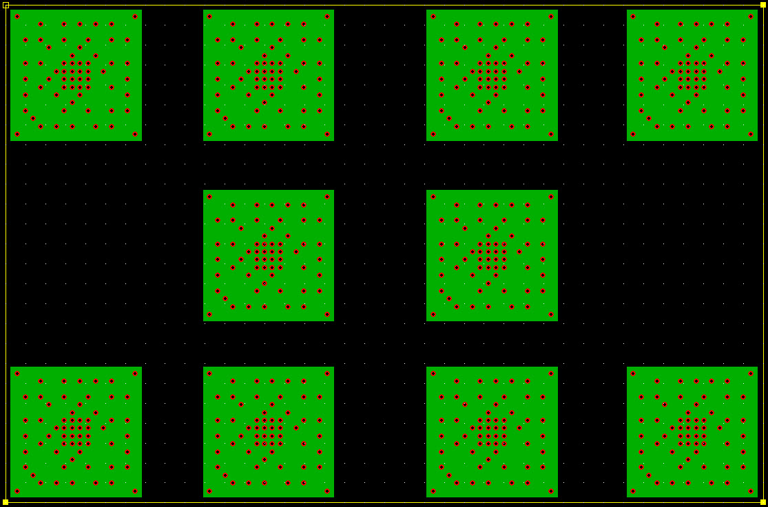

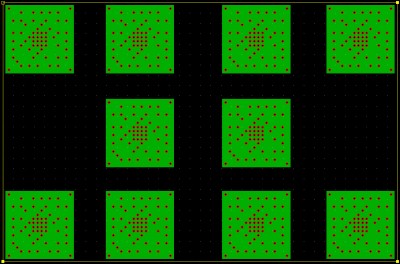

So I am eager to start production of my 3D bypass capacitor board, each .67"x.67" board will have 62 holes. Each of those holes will be a .056" via with a .029" hole. The 0605 caps will be a snug fit, since they are .065"x.032". Some things I have to consider are the number of holes per board. Max is 650 for ExpressPCB ProtoPro 2 layer service, the one that can't exceed 21sq". Which real estate is not the issue here, number of max hole is the limiting factor. So I can have multiple bypass cap boards on a single manufactured board. Looks like about 10. I will use extra holes remaing to make separation easier. $166 will get me 4x10 boards. I have to get the measurements correct the first time! I may have to go with the .065" via with the .035" hole.
The Green is usually the bottom layer, but in this case it is on top for the bypass cap board on the left. The red layer will have to be etched off, and all the VCC power holes will have to be drilled. The GNDs will have wires to go through both boards.
Ignore the error on the pic, this was just a rough draft.

Each of those holes will be a .056" via [pad?] with a .029" hole. The 0605 [0603?] caps will be a snug fit, since they are .065"x.032" [...] I have to get the measurements correct the first time!
Make sure you measure diagonally across the capacitor, and measure several since there will be a tolerance. Also, make sure you take into account the tolerance on finished hole size in the manufactured board. I'm sure you'll need to specify a bigger hole than .029.

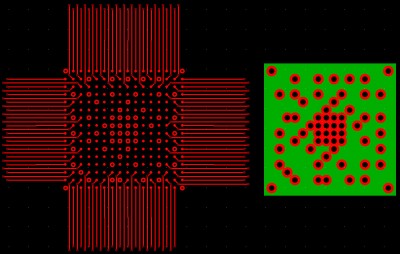

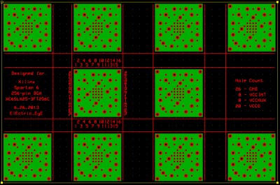

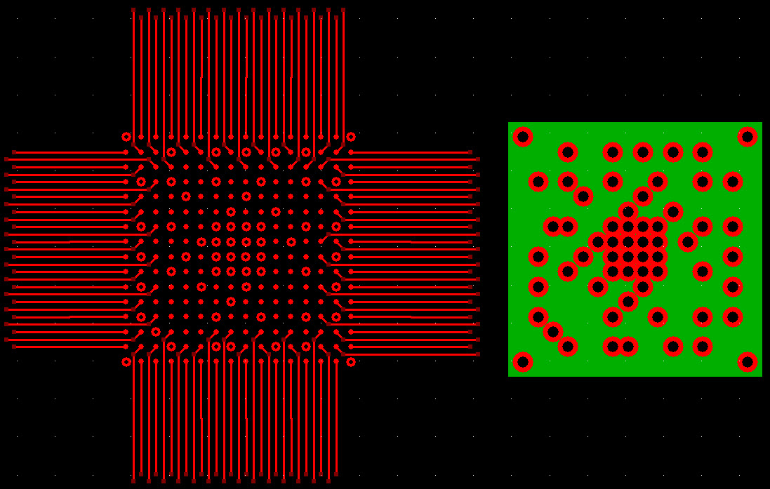

OK I have it figured out! I am jumping the gun, so to speak, as I don't even have a BGA board designed yet, but this topic of layered boards is very intriguing and something I must conquer immediately. I think it's going to work. I've triple checked pins and the design has been accepted by ExpressPCB. 620 holes vs. the 650 hole limit on ProtoPro 2-layer service.
The green layer should be manufactured with no solder mask.
The red via's are .031" with a .014" hole.
All I should need to do is drill each hole out at least to .031". Ideally, this will leave no conducting material on the bottom side mating to the bottom of the 256-ball BGA mainboard.
EDIT: Added details.

Real world measurements:
for 0603 SMT are .032"x.064". [...] by placing 0603 SMT in a human drilled .031" hole
How thick is the capacitor? The diameter of the hole needs to be at least SQRT(W²+H²), H being the height, or in this case, thickness. So if it's .032"x.025" for example, you'd get .041" minus a tiny bit for radii, plus tolerance on the hole size.
