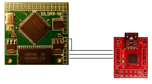

Connecting a CHOCHI board
Only two connections are necessary to get started:
- Regulated 3.3V to the 2-pin connector; one of the pins is marked 3.3V (lower pin)
- Serial connection: two pins are marked RX and TX. RX goes to USB-serial board's TX, and TX to RX (usually). You should also connect the ground. Depending on your USB-serial board, the ground may be in different places. I connect the top pin to ground (solder a little wire to the ground of the power connector) and use a 3-pin cable right to the board. This depends on the pinout, which is why I left the top and bottom pins unwired in the original boards (marked DILDAR50-X1). Newer boards marked CHOCHI have the top pin connected to ground.
A 6-pin JTAG connector is also available for reconfiguring the FPGA or the platform flash using Impact and a Xilinx USB cable. The bottom pin of the connector is 2.5V (red wire on my cable, but check!).
Bringing up the board
Make sure your serial port works by starting your terminal. Set it to 115200 baud, 2 stop bits, no parity, no handshaking. Short USB-serial board's RX and TX pins. Now type something; your terminal should echo your characters.
Connect CHOCHI and power-up. Boards with new firmware will start flashing the LED. The terminal should print '6502' and wait for the binary file. I then use my terminal's (gtkterm) 'send binary file' feature to upload a file. The file should be prefixed by the location (16 bits) and size (16 bits). Immediately after the upload, the new program is executed.
If you see garbage on the screen, chances are your USB-serial board's ground is not connected to CHOCHI's ground or your terminal is misconfigured. Sometimes, a faulty power connection will reset the board, messing things up. Update your firmware (see previous message); having a flashing LED will give you some degree of confidence.

Re: CHOCHI - Connecting a serial-usb board
My CHOCHI is connected to a CP2102 serial-usb board I bought on ebay. It is wired like this:
Note: the board revision marked DILDAR X1 serial connector only has the pins marked RX and TX connected. For a reliable connection, the grounds must be connected as well. For this particular serial card, the simplest way to do this is to connect the top pin of CHOCHI's serial port to the ground connector of the power supply, as shown. I soldered a wire underneath.
Later boards (marked CHOCHI) will have ground connected to the top pin on the board.
